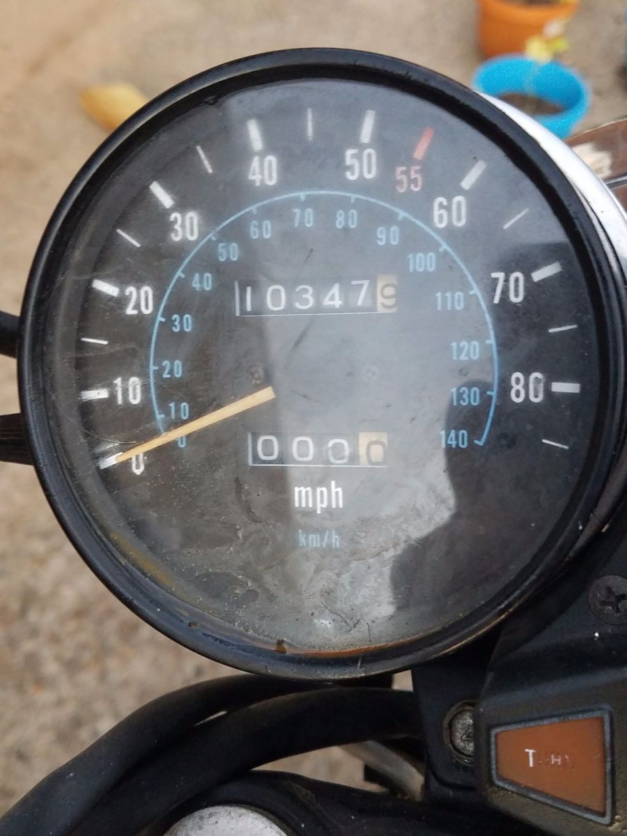

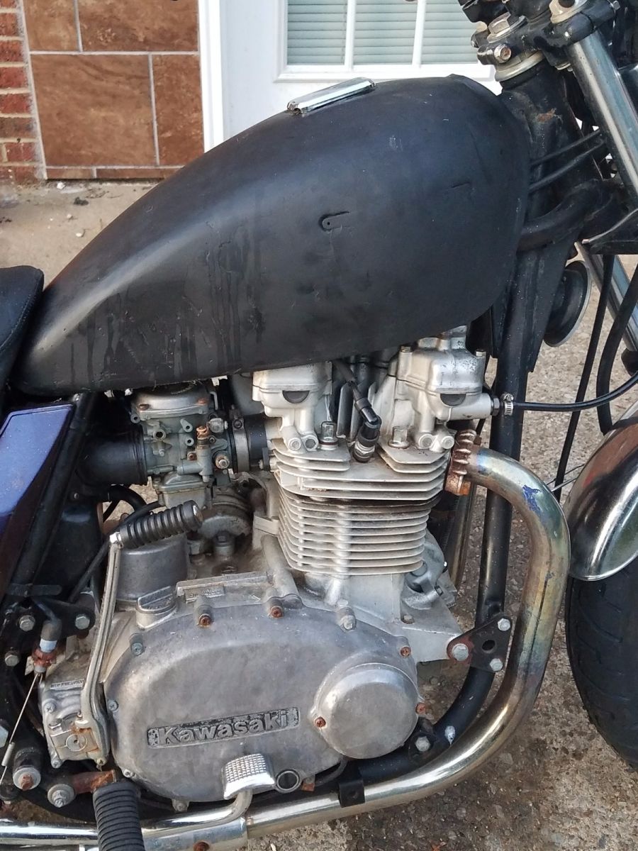

This is my first motorcycle resurrection, but I have working on cars for almost 30 years as a shade tree mechanic, so I will be asking alot of questions as I go along. The back story is that the bike is a one owner with 10K original miles on it. It sat up for a long time but appears to be keep in a garage or somewhere with some climate control as most of the rubber bits are still soft and springy.The bike was 99% complete , just missing the tailights. It even has a sissy bar on the back.
So far the tank has been treated and sealed, new tires, a new front master cylinder. , new rear brake shoes and a new battery. If anyone needs a battery I got a AGM battery with 210 CCA from batterymart.com for $45 shipped that fits perfectly.
Link for Battery
Some pictures of the bike

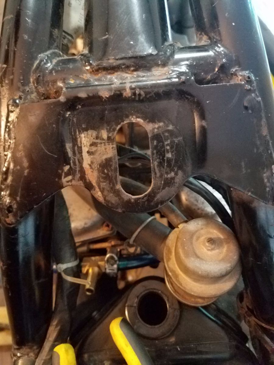

This is a picture f the frame right above the carbs and airbox. Is there a rubber piece that goes into this slot for the rear of the tank to rest on? If there is what is it called.

Yes there is a rubber grommet that fits in that hole to friction fit the rear of the tank. Not sure you'll find a replacement. I had an old bike that lost one and I ended up making my own using a small chunk of baler belt, cut a hole in it smaller than the oval in the steel mount point, and pop riveted it to the frame. Worked very slick.

Yes. It is called a "rubber fuel damper" and is Kawasaki part number 92075-295 (see www.powersportswarehouse.com/p/Kawasaki#...50-M1-1982/080102F-6 ). They are readily available on eBay; just do a search for that part number. The prices have a wide range; here are just two of a half dozen of them that are there today. Ed

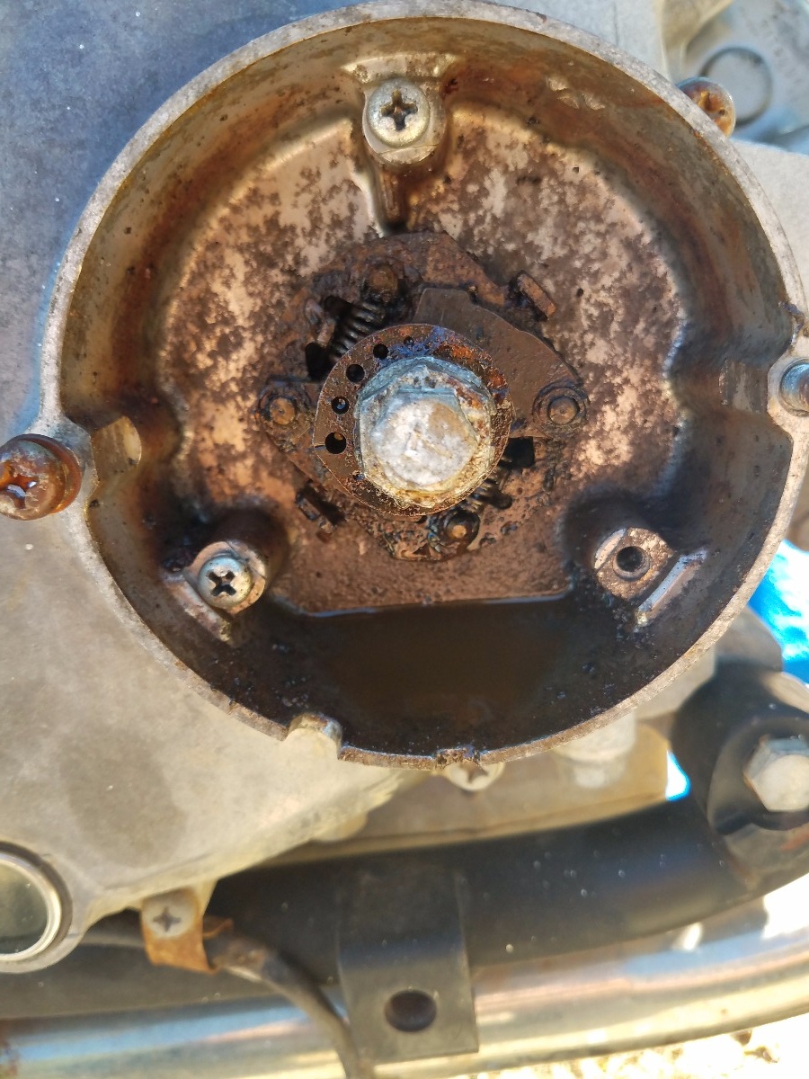

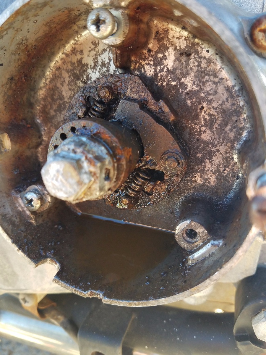

I had them completely apart and soaking in pinsol diluted 50% . Diaphrams removed mains jets removed, enrichment valves out, pilot screws removed . The diaphrams were soaked in alcohol with wintergreen oil. I confirmed that they do not have holes. Then after soaking I blew everything out with carb cleaner. But I may have found part of the problem. The ignition points or at least what would be points if it was not electronic, are.rusted completely shut. Here is some pictures.
How do I remove this and do I have to replace the whole thing or can I clean it and just replace the springs?

well it sounds like you cleaned the carbs good enough, the way you worded it the first time sounded much different.
That is the ignition advancer. it advances the timing as the RPM climbs, it very well could be the source of your problems. You hold the 17mm nut on the end and back out the smaller bolt and them the whole assembly comes off. I would soak it in acid to remove the rust. you need to inspect the advancer cam and make sure the rust didn't damage it too bad, if it looks serviceable i would replace the springs and oil it before putting it back.
if you want a super cool ignition that completely replaces this, check out C5 ignitions. i just installed one on my 1980 750 twin and it starts up first kick.

Thank you for the information. Would you have a part # for the springs or an alternative part. All I can find is the complete assembly. When I opened it up the weights were completely frozen. So
I am assumimg that the timing was not advancing at all. It is good to know it may be serviceable.
