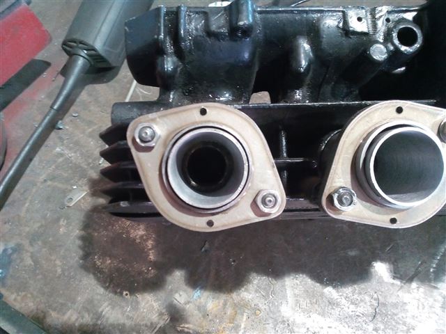

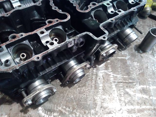

I love the look of old race bikes so i started making some header slip joints from scrap pipe on the a spare head i have, .No 4 is a nice slide fit i just need to copy it three more times.
Also think i need to trim them down a bit so the flanges are closer to the head.

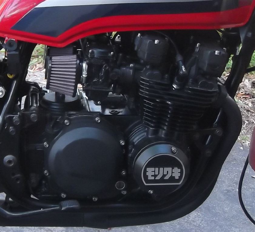

Its been awhile since i updated so I finally got the engine back together a while back Its now 615cc with zx550A cams and cv32 carbs. i had the head rebuilt and cylinder block bored by Ray Easson a well regarded motorcycle engine builder over here with many decades of motorcycle drag racing under his belt.
I Still need to sort out jetting but im extremely time poor at the moment with lots of weeks working away from home living in motel rooms

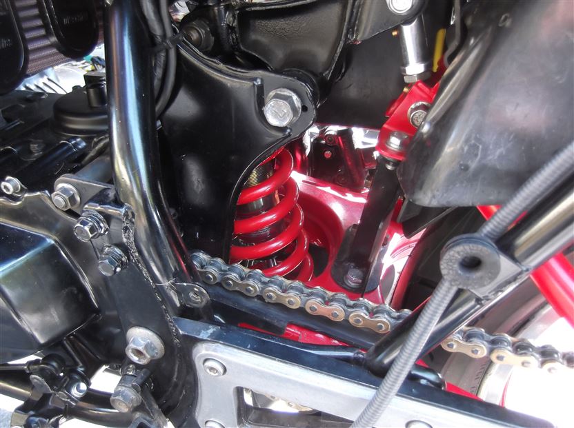

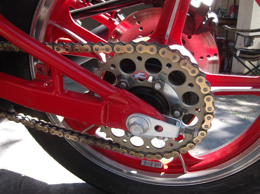

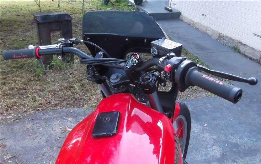

Have also done a 520 chain conversion
New Bitubo mono shock
Replaced the factory bars with some alloy renthal SBK bars. They are roughly the same height but slightly further forward .
I need to plug the fork ends as the original caps dont fit anymore
A
A
