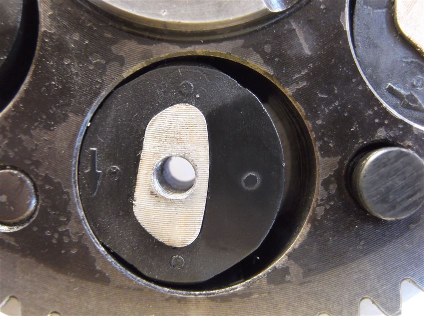

- Daftrusty
- Posts: 379
- Thanks: 212
Re: 1982 Z550GP H1
03 Apr 2018 16:52 - 03 Apr 2018 16:53
I did try fitting turbosteve dampers into the 550 basket. They do not fit and will not work!
The slop in the clutches is really not that big of a deal but can make a racket during warm up and mostly felt as slop in the drive train when the weight of the bike transfers during coasting and acceleration. It is literally slop in the drivetrain.
The time to worry is when the dampers get so brittle that pieces show up in the oil pan. The clutch I took apart did not have any broken or cracked dampers, but they had virtually turned to stone.
I thought I had found dampers from Hinson or Rekluse that might be repurposed to work in the 550, but I never tried buying some to try them out.

- Wozza
- Posts: 136
- Thanks: 30
Re: 1982 Z550GP H1
05 Apr 2018 05:21
I dont mind, This is good info to know.
I pulled the clutch basket apart and while the dampers haven't started falling apart yet but hey are very hard and seem to have shrunk im going to look into repacing them with something else

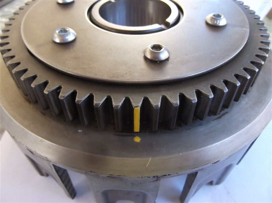

- Wozza
- Posts: 136
- Thanks: 30
Re: 1982 Z550GP H1
08 Apr 2018 06:00Yes the rivet holes are the right size to run a M6x1 starter tap through. I had some button head cap screws lying around so i used them to hold it ll together until i get some the correct length.loudhvx wrote: I assume you tapped the hole, correct?
I refitted the basket to the gearbox input shaft and it spins freely . How much clearance between the heads and the crankcase i am not sure as i haven't measured it,

- loudhvx
- Posts: 10863
- Thanks: 1622
Re: 1982 Z550GP H1
08 Apr 2018 09:53 - 08 Apr 2018 10:12
Daftrusty found some bolts with 1.5mm tall heads.
1.5mm is ok, according to him, as long as you leave out the red gasket material, allowing the plate to sit closer to the basket.
This was on a 750, so maybe it's different on the 550.
Here's a link to the great photos and write up.
kzrider.com/forum/11-projects/602462-kz750e-resto-mod?start=40
