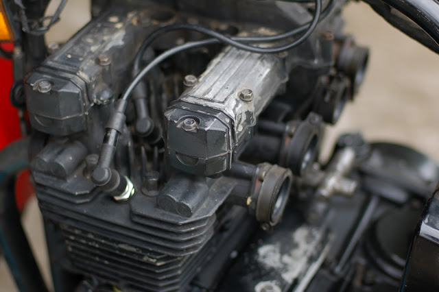

Painted the engine block and pretty happy with the result from $20 rattle can
And then took the bike to Redhill to cure the paint and see the autumn colours!
