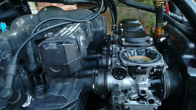

Managed to put in the stock airbox today. The bike came with spare carbs with stock jetting.
After putting them it's like a *completely different bike*. Idles smoothly and pulls really strong to red-line! The only think I miss is the roar of pod filters, but there is no way I'm using those anymore. A big bonus is I'm no longer breathing the oil fumes from the crankcase!
The start with choke was difficult. Not sure why so I might need to inspect the choke mechanism.
The filter is one of those 'K&N" so I have ordered a stock foam replacement.
Once all good, I will repaint it to black.

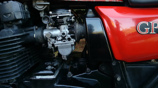

Re: GPz750 R1 (1982) fixing up
26 Mar 2017 04:57
#757719
The choke pick up tube goes down into a small passage in the float bowl. It's important to use a piece of wire in the pick up tube to make sure it's not plugged up, and make sure the passage in the float bowl is open as well. These passages love to plug up which renders the choke inactive on that carb because it can't get any fuel.

Thanks. I've been reading some carbs fixing in the forum too,
Are you referring to the following passage? I will check that they are clean.
When the bike is running and I pull the choke the engine runs rough which indicates that the mechanism work, But not sure how clean they are.

HeavenlyMachines wrote: Thanks. I've been reading some carbs fixing in the forum too,
Yes. Don't forget to check the tube as well.
zeus.mtsac.edu/~cliff/storage/gs/Mikuni_...Rebuild_Tutorial.pdf

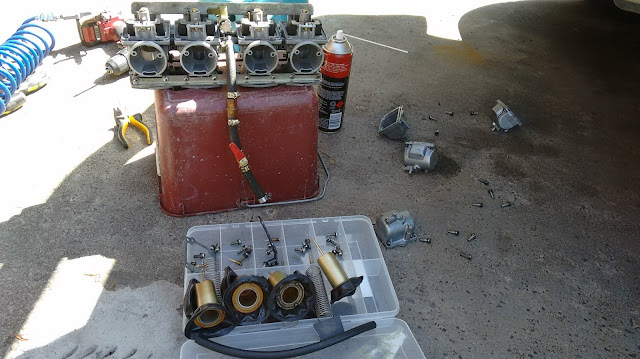

Well I took the bike to work yesterday and I was unable to start the bike. Even rolling it downhill didn't start the bike
Today I stripped the carbs. As suspected above the starting jet passage on the 3 bowls were completely blocked. It took quite a while to clean them up.
After that it started very easily! Except I noticed hesitations around 5k-6k RPM. Decided to look again and sure enough one of the needle sits on top of the plastic stopper, not below! .... silly mistake
After fixing it the bike runs flawlessly! I took it to Frankston for a nice view
