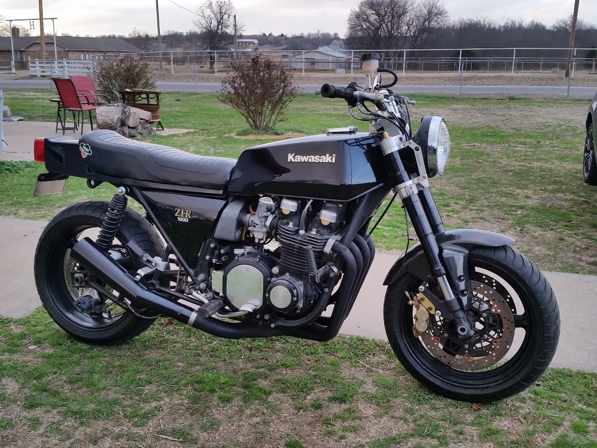

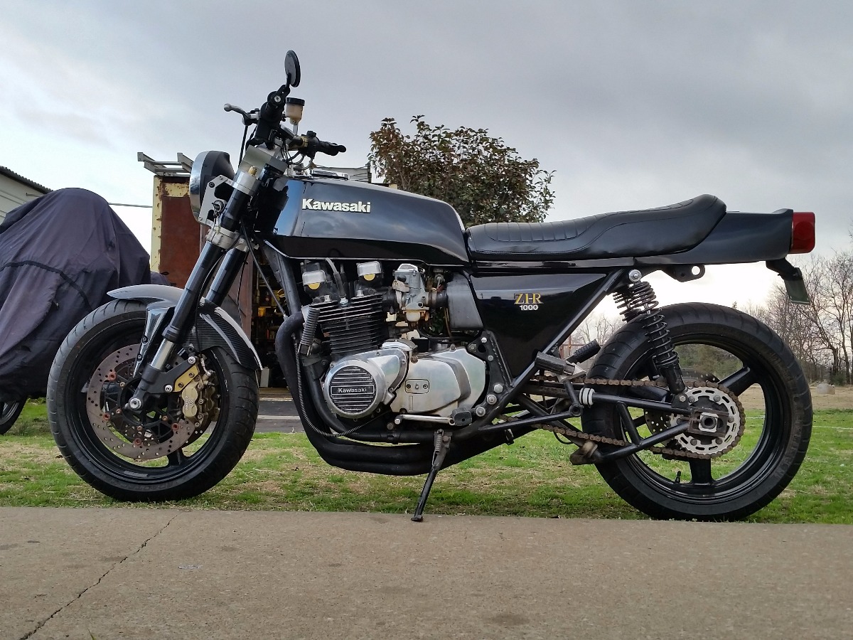

grabbed a couple pics last night with the black megaphone.
still got a lot of work to do. :whistle:
needs detailed :pinch:

Looking great Leon.
I bet it goes as good as it looks.

thanks Wiers,
it's pretty cool what the lighter weight modern components do for seat of the pants feel.:evil:
from standing it up off the kickstand to pulling out of a parking lot it just feels smaller.
the front brakes are effortless.
i guess i need to look into what adjustments are available with these forks,change the fluid etc.:whistle:
but just to buy something and slap it on i am well chuffed with the whole deal.

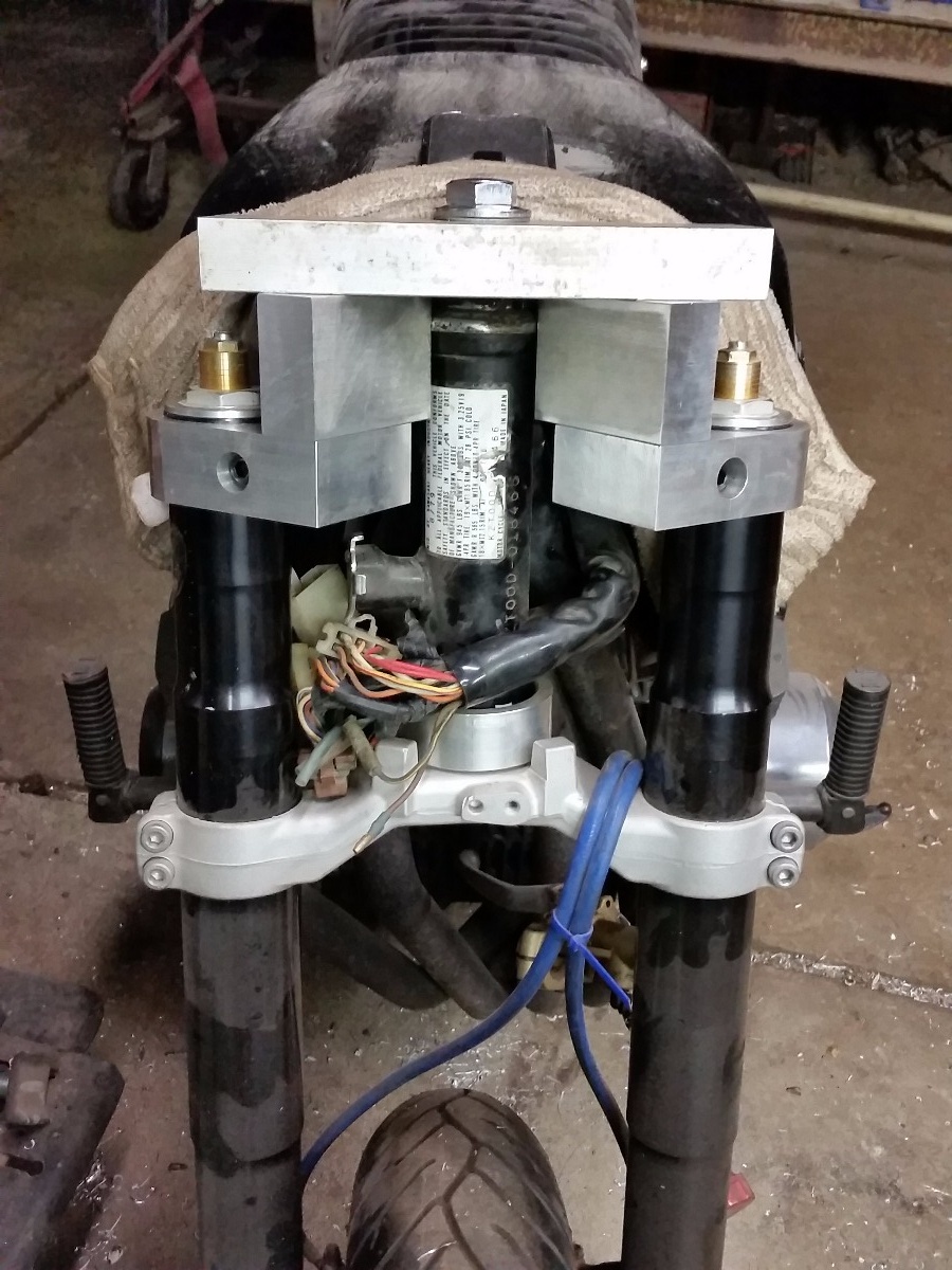

01 Mar 2017 07:16zed1015 wrote: Nice work.
RE- fork extensions.
You could gain extra fork length by simply fitting a 32mm male/female threaded slug to the bottom of the damper rod.
A simple job for the lathe and metric tap and die. ( don't even mention all the work I did to the Z cafe's forks for the same resultthink I was having a brain fart on that day
Depending on model the thread for the allen screw is M10 or M12 by either 1mm or 1.25mm.
This would enable a bit more leg length between the yokes by allowing the spacer block height to be reduced if required.
So basically you are making spacers that make the lower fork legs longer so the top stays the same?

01 Mar 2017 11:09KZ802 wrote:zed1015 wrote: Nice work.
thats the gist of it

so awesome. I think this may be my favorite Z1R on this site. the combo of the swingarm and front end is killer! plus those brake tech rotors are just icing on the cake.

thanks for the kind words sir!

01 Mar 2017 11:37 - 02 Mar 2017 07:23KZ802 wrote:zed1015 wrote: Nice work.
Yes! on all forks there's an unused portion of stanchion that extends above the top fork bush or below the bottom bush depending on type.
On all usd fork I have worked on so far there is 37mm above the bush, so the damper assembly which controls travel can be extended (lifted up) to allow this portion to be used and therefore safely internally extend the forks by the same amount.
There is a rebound spring in the damper assembly to cushion any impact on the damper when the forks fully extend suddenly ( when doing a wheelie etc ) and when unloaded and in a free state it is possible to pull on the fork lower and extend it by a further 5mm so I deduct this from the 37mm to give a safe 32mm of extension.
On some of the newer forks the top bush is only 5 to 10 mm wide so don't want to risk the top of the stanchion momentarily dropping out of the bush under extreme conditions.

thanks for the awesome information zed1015!:evil:
and thanks for your willingness to share information,greatly appreciated!
so with some fork mods to extend them internally and a upper triple with a 38 mm drop i would be at the ride height i want to be.
got me thinkin
got me thinkin

Looking great Leon. I am still in the process of finishing my triples, I opted for a one piece drop triple. Originally I had about the same amount of drop in mine to try and gain the loss of height due to
Question, how much offset did you put in? Did you go with the same amount of offset as the stock triple?

thanks kaw-a-holic.
offset is the same as stock 00-04 r1 -r6 i used a r6 lower.
which with a little whittlin and welding could render a cheap upper drop triple clamp. :whistle:
just sayin.
