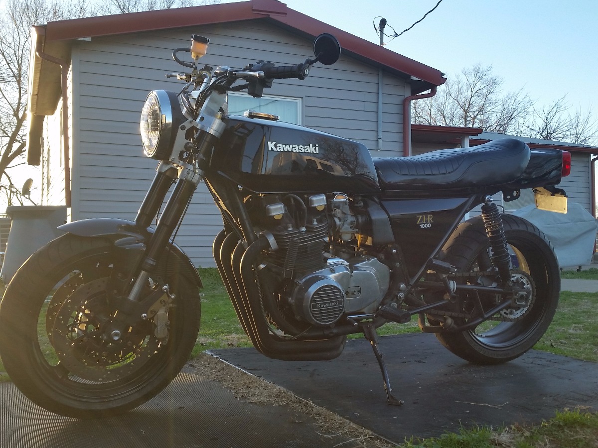

750r1 your concerns are duly noted .and have been pondered over.
i started this thread to show off some pics of my work and my bike.
80b4,
thanks means alot coming from you.
80b4,

took it out for a few hours last night :evil:
didn't die :whistle:
not even close .this thing is extra solid.no shifting of anything .
i'm fine with it.
we'll see.time will tell and sh!t will smell right .
didn't push it super hard,
but oklahoma back roads are pretty rough.so alot of mid-corner bumps surface irregularities etc.
super stoked and ready for some more saddle time

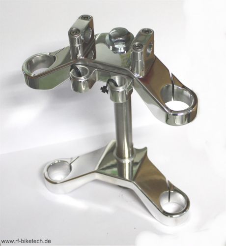

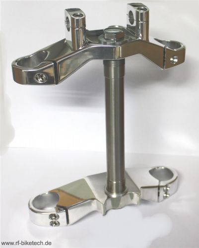

Re: 1980 z1r front end conversion
24 Feb 2017 16:35
Nice work Leon.
Here a front end with One piece upper triple clamp for Zeds, gives you extra 35 mm fork length but price is high.
www.rf-biketech.com/shop/product_info.ph...Typ--GEKROePFT-.html
and some german Z bike overkill
rf-biketech.com/cgi-bin/contray/contray....=000021001&GROUP=026
- Posts: 7442
27 Feb 2017 06:08 - 27 Feb 2017 06:08
Scirocco,
those are some very nice looking triples with gauge mounts in place and everything.
the thing is i was needing to make up 76mm to get to where i wanted to be.
so maybe using zed1015's tricks to stretch the forks out as much as possible and a set of triples with 35 mm or so drop might be a viable option.
i have some other frontends i would like to pull apart (zx12,gsxr,busa)and have a go at extending for some of my other project kz's.

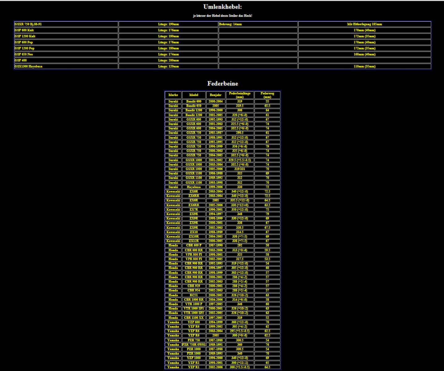

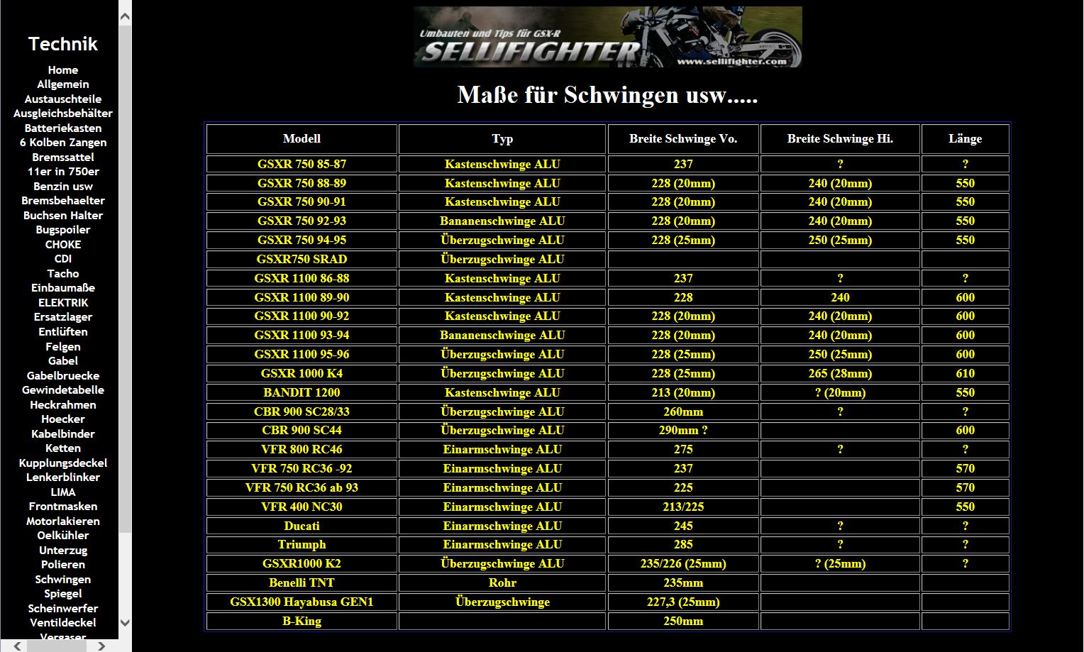

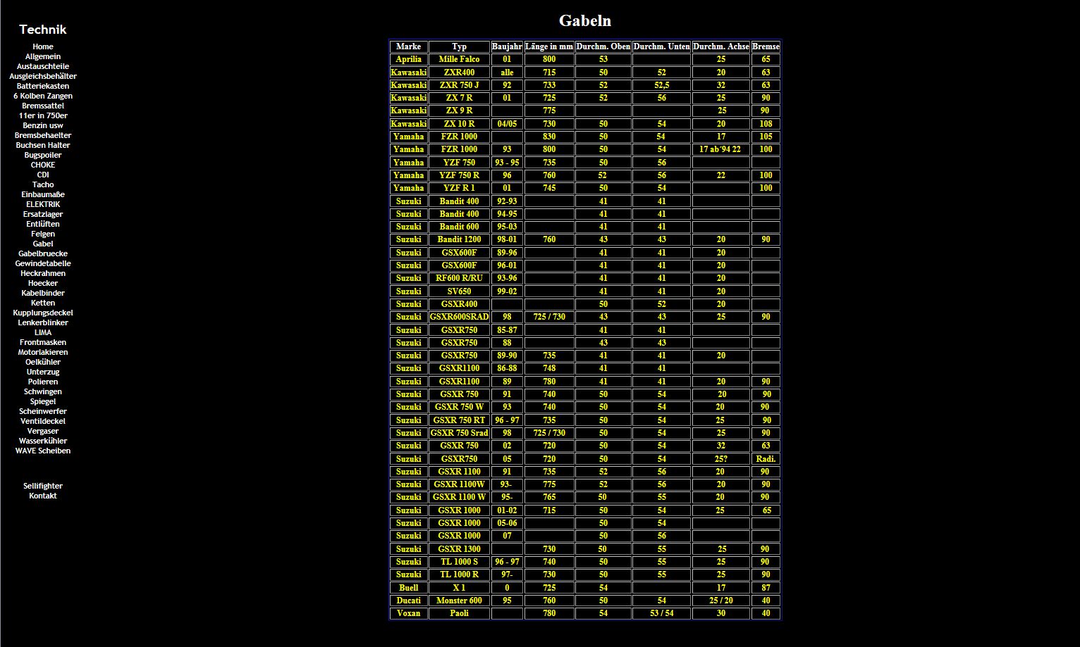

Hello 531blackbanshee
you can increase your high +55 mm with Aprilia RSV Mille or Falco fork legs, (all over lengh 800 mm)
i added some fork, swingarm, linkage and rearshock charts
www.sellifighter.de/technik/MASSE/MASSE.HTM
