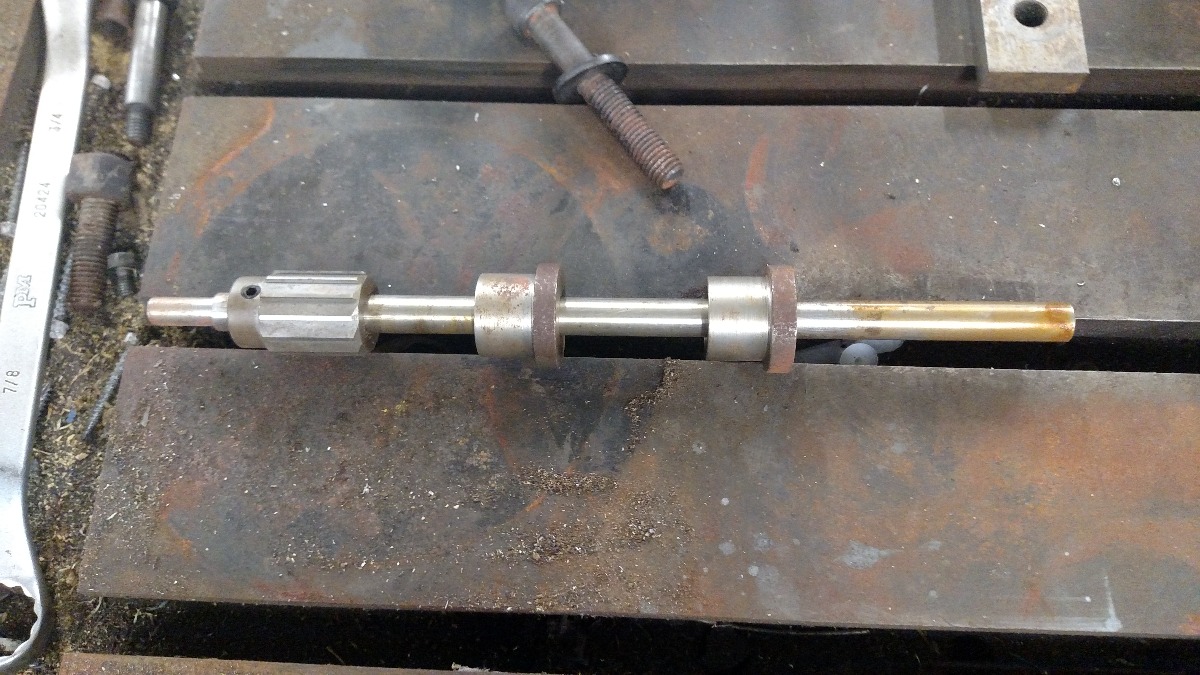

Doc, although I won't divulge how I will admit to machining the pivot bearing bores but I have found that the bores for the axle pivots don't really distort if I leave it on the jig clamped up till it cools.
Couple more pics.
This tool is something for you to ponder on.

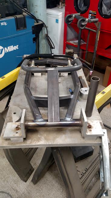

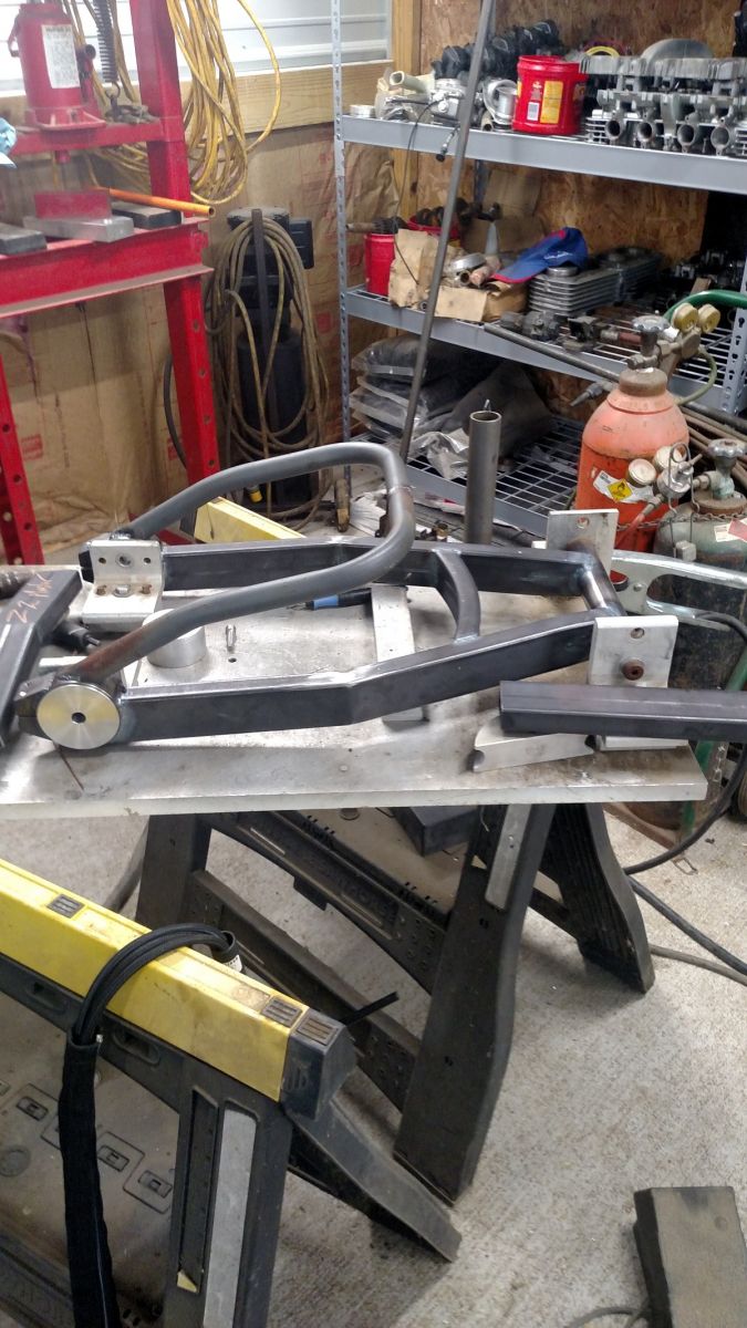

LOL!!! This is the first one like this, see how it's accepted at the show and possibly build permanent templates and fixtures. It's 2" over stock in length.
Here's one more brace fitted with 2 more diagonals yet to be.

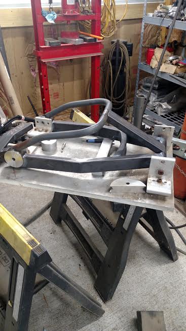

This is getting powder coated in a satin metallic silver to simulate freshly blasted aluminum and the eccentrics anodized. My mental picture says this should be a good looking pc. on the chassis.

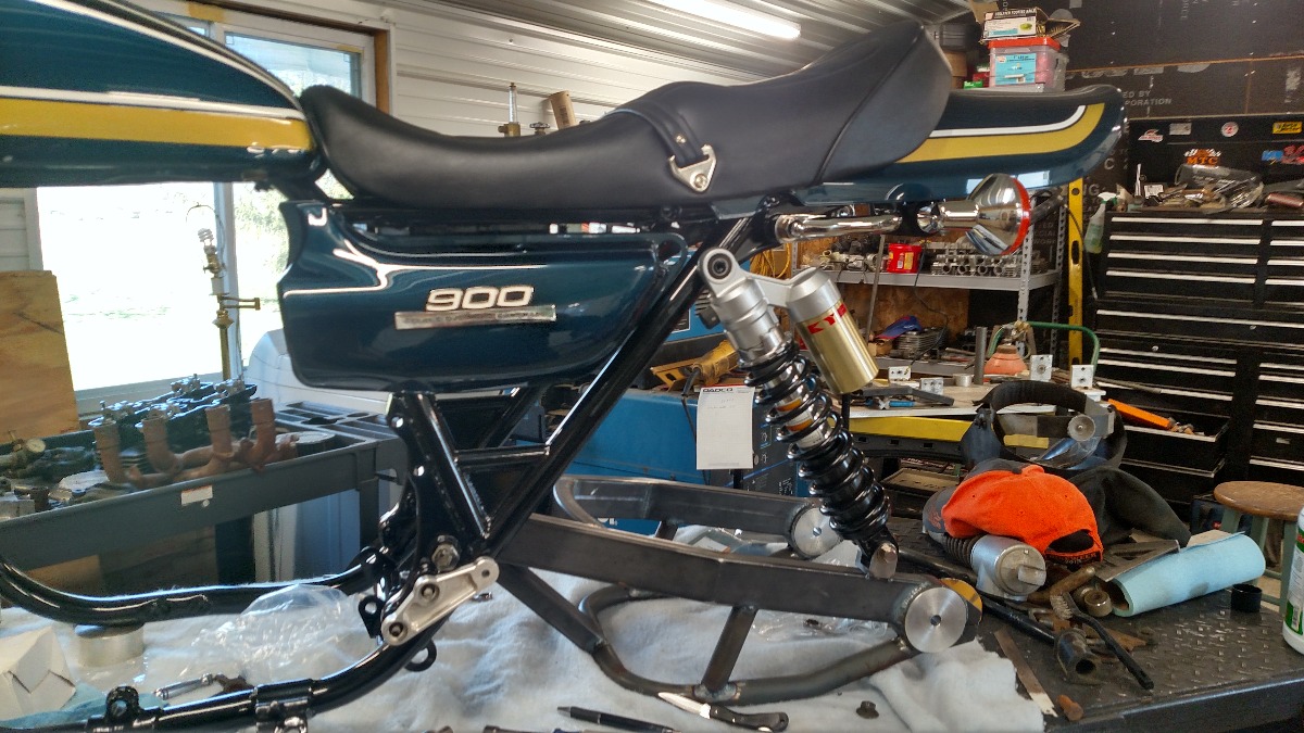

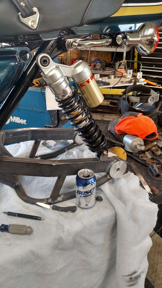

Okay, quick mock up with shock mount tacked in place. Pretty happy with geometry at this point so I'll weld them permanent along with chain guard tabs and brake stay then off to powder coater.
