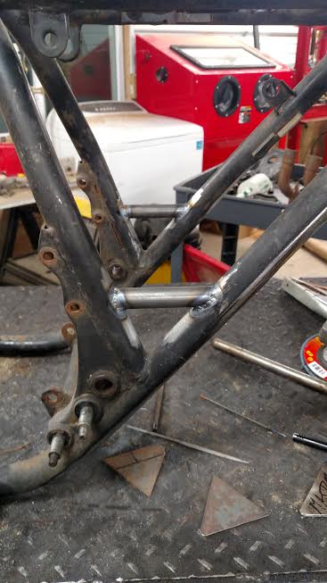

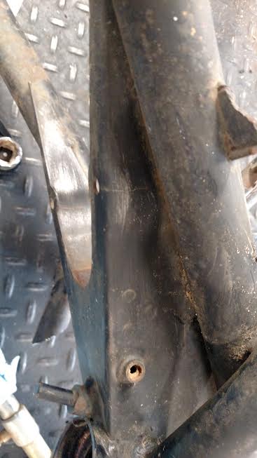

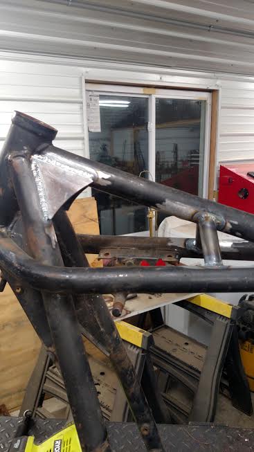

Re: Gibralter by 3/24
25 Feb 2017 17:28

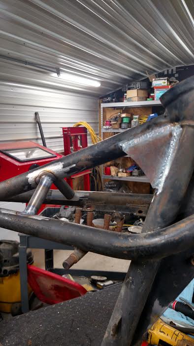

Done some frame mods today, found it cracked in the normal place, welded that up and done some of the gussets.
More tomorrow.
Les

- Posts: 5184
- Thanks: 2339
26 Feb 2017 05:19
Dont forget the extra tourqe brace by the chain;)

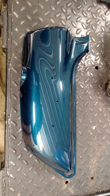

- Posts: 7442
27 Feb 2017 06:13
that is an awesome color of blue!
