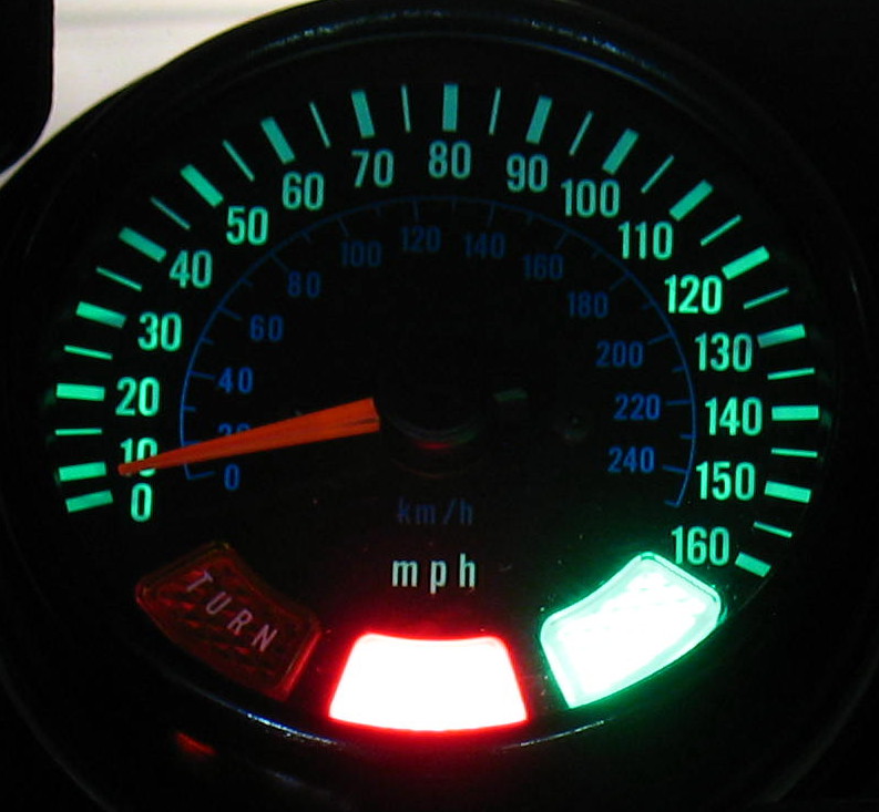

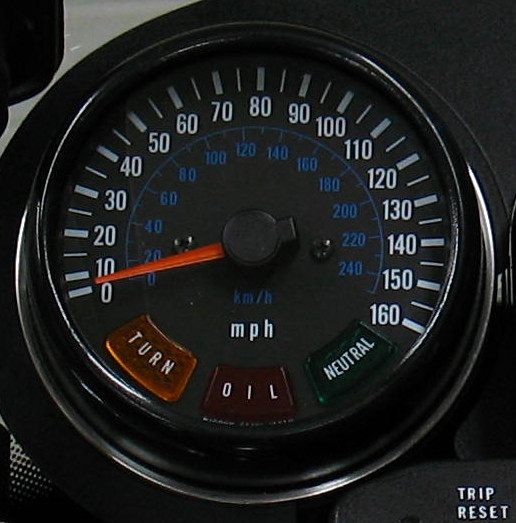

- Zen Shenron
- Posts: 55
- Thanks: 18
Re: 1982 KZ1100 A-2 (warning image heavy)
17 Jun 2017 13:19
Not much done on the gauge front, been so long since I've used these programs it is slowly coming back.
