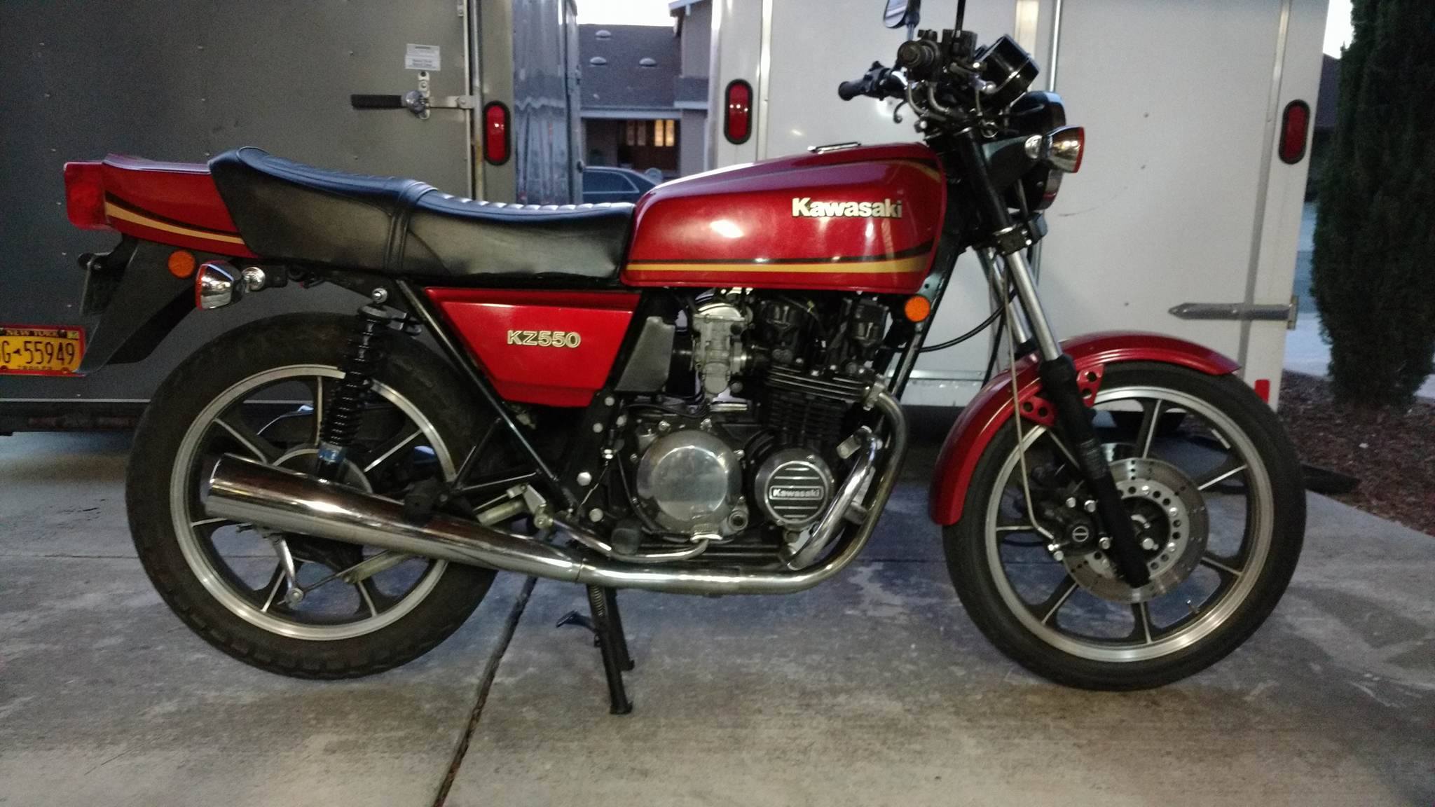

Well...My plan was to sell this and replace with a GPZ but I came across most of the parts at an amazing price. So far I have both front and rear wheels with rotors, rebuilt front forks, entire front brake assembly and the rear brake and caliper.
Has anyone else here done this conversion? Seems pretty straight forward except for the rear brake master cylinder mounting. Anyone have any pictures they can share? Thanks in advance.

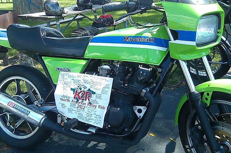

Look up Harm and then admire his 550 conversion to a ELR clone
He is a past Bike of the Month Honoree

OK...Made some progress last night. Got the rear end apart, new swing arm on, wheel on and shocks etc. Just gotta finish the brake caliper install and get a master cylinder hooked up.
If anyone is interested in this bike I will be re posting it for sale again. I have come across another project I would like a little more than this and there is only so many bike I can have.

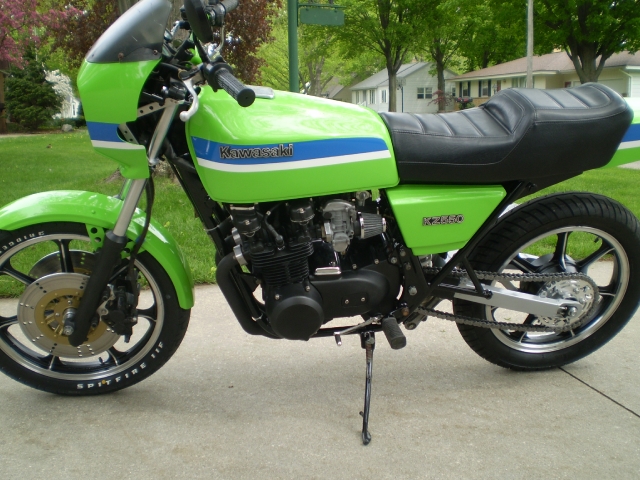

You'll probably get more if you sell it stock,and you'll save yourself a lot work . The front on this one that I have has been converted.

23 Dec 2016 11:47Nice bike. Where in NY are you? I have the back of the bike all converted except for the tab for the master. The front is an easy fork swap
