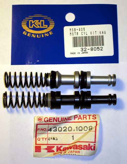

i have this saved under z1r front master cylinder rebuild.
i believe this is the same kit that a 78 kz1000 uses.
while the piston is slightly different it has been reported to work.

I wrote that original post saying that the K&L kit works just fine in the Z1R (it's still working in my bike anyway). But it looks like my original thread is corrupted (server error). Here is the third page anyway: kzrider.com/forum/5-chassis/569907-z1r-f...tute?start=40#659778
And I agree with Patton. You should remove the plastic elbow on the top of the MC and make sure both of those fluid ports are open. The front one (closer to the hose connection) is very small and frequently clogged.

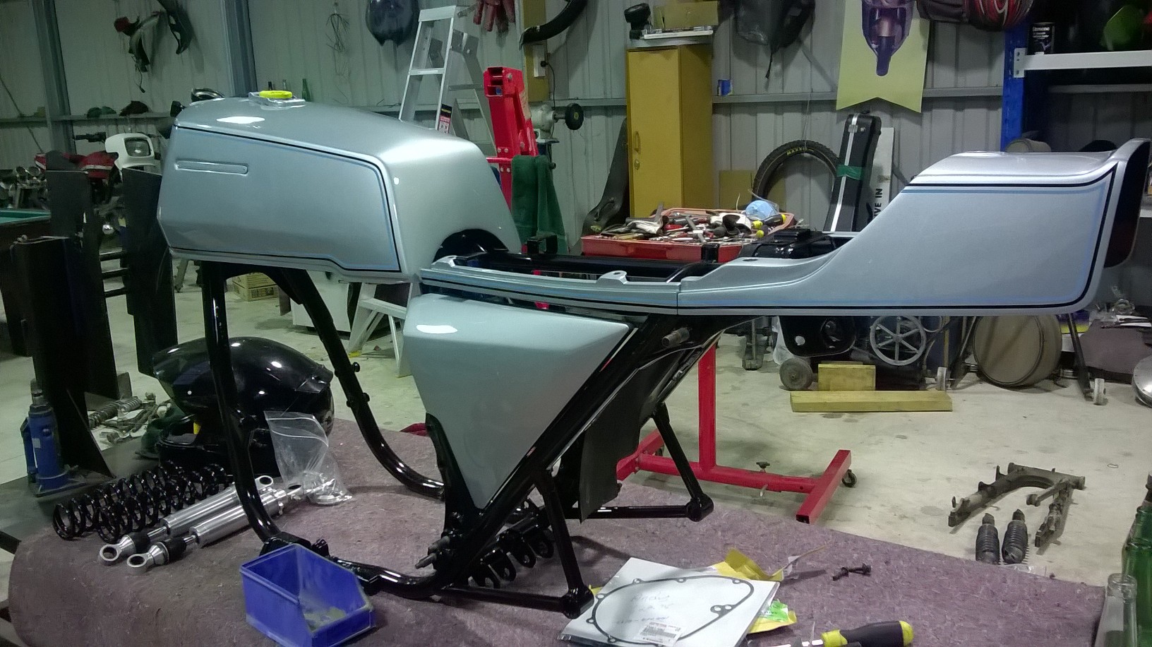

Nice Z1R mate, that will be a sweet ride when you get it finished. I painted mine using Havasu Blue which was a colour used on Honda cars. I had nothing to compare it to when I got it done but have since put it up next to an original and it is pretty damn close. Here is a pic of my body work.
