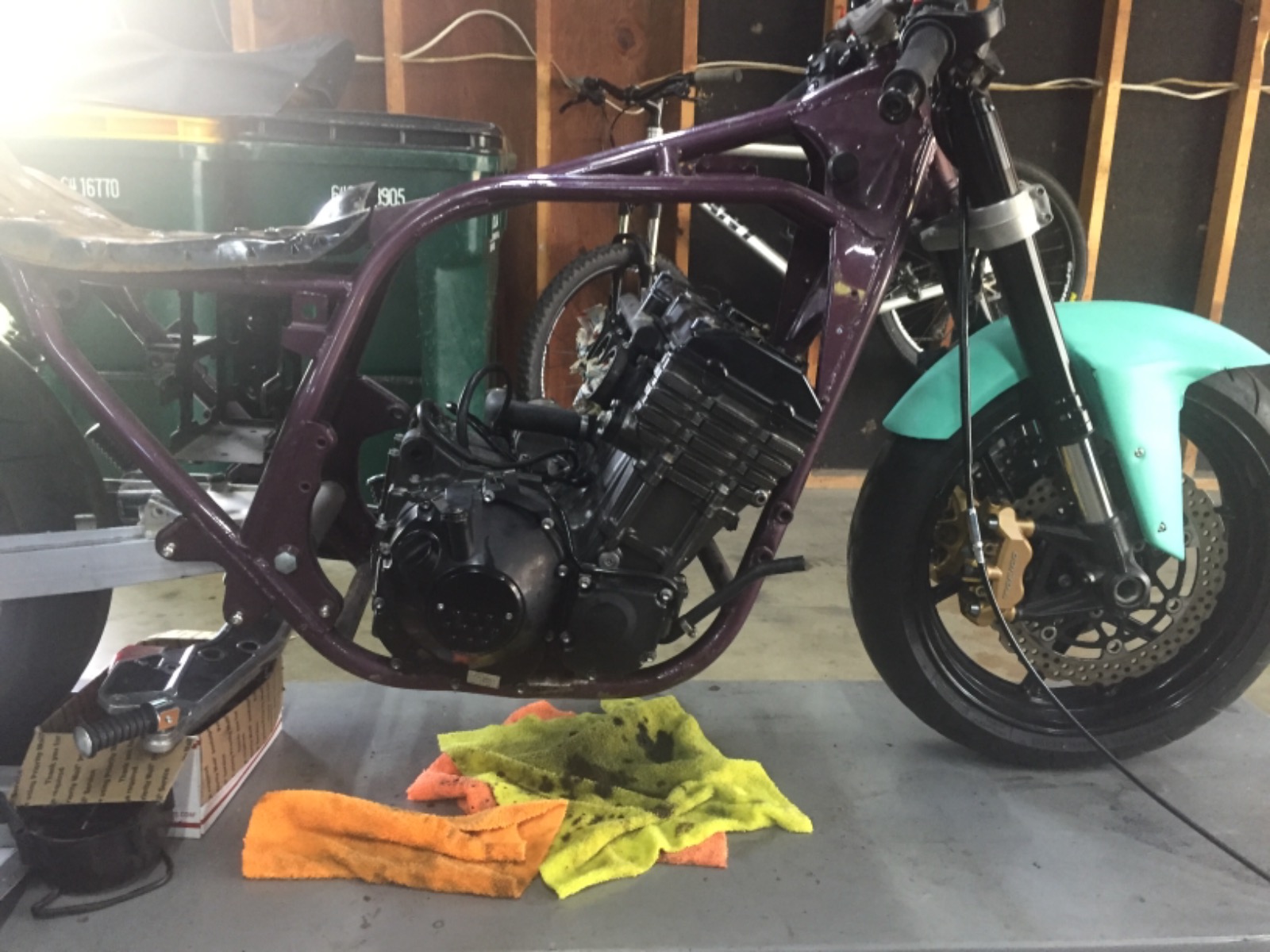

Nice project, you may want to consider setting the motor further back. I know someone who had an early GSXR1100 motor in a Harris that was built for a Z1000 motor. The front sprocket is so far ahead of the swing arm pivot that you will need to run the chain loose to avoid the suspension movement being affected as the swing arm goes past level (the longest point)

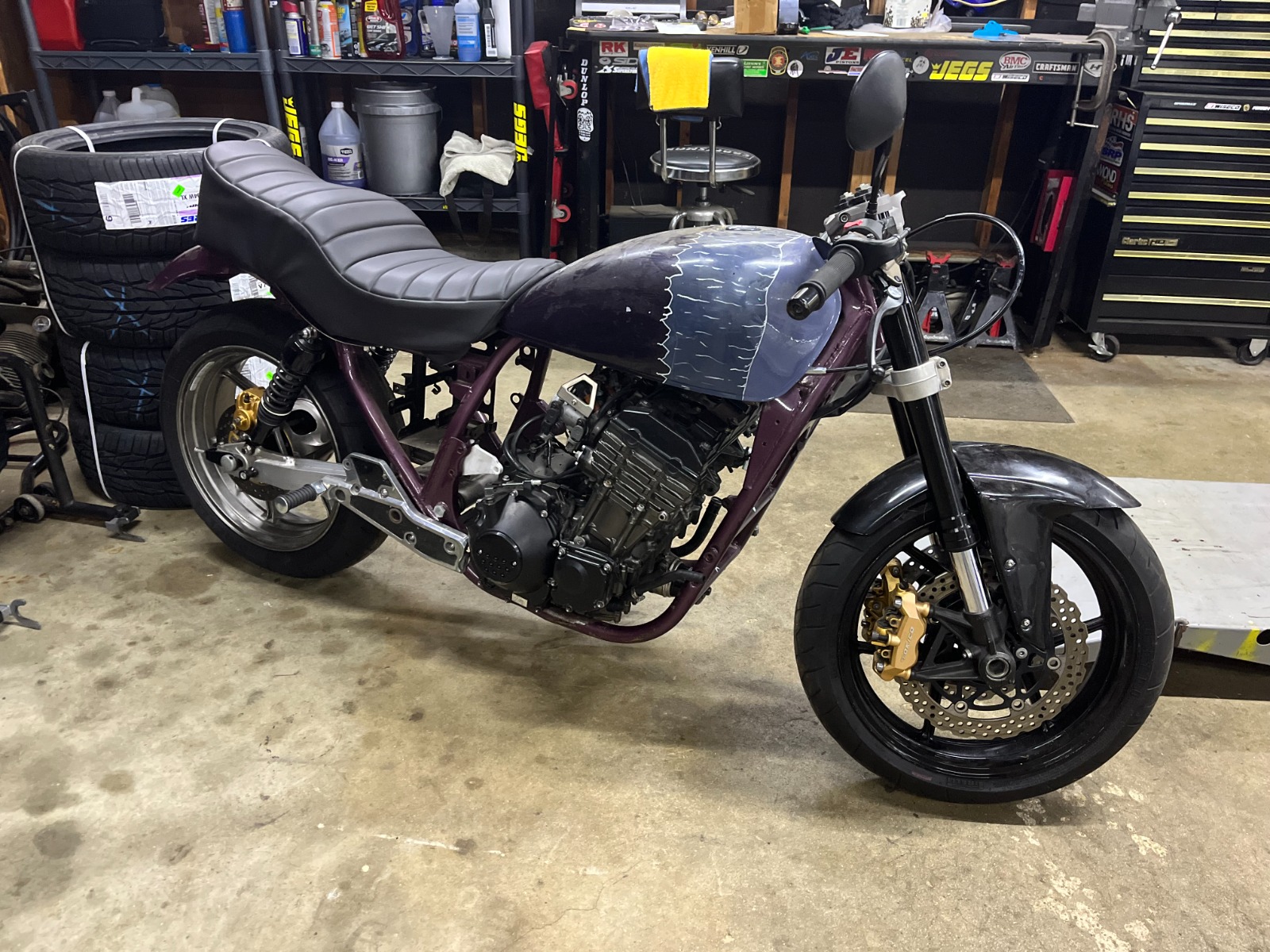

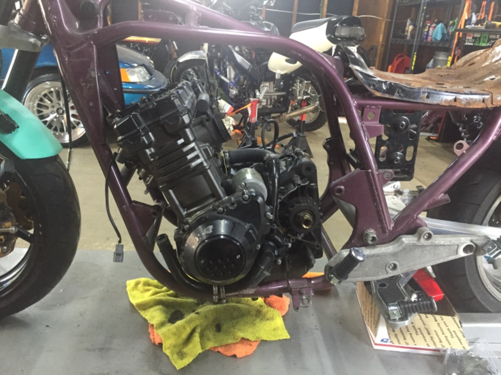

Motor is simply laying in the frame in these photos. I have to get the mounts made up which will lift it into a much better position. Winter project for my friend with a 3d printer to help me out before I have the mounts made out of steel and welded to the frame.

Re: 82 kz1000 ground up build
08 Dec 2021 12:23
No worries, just thought I'd mention it as my friend broke a couple of chains before settling on running the chain loose (he had spent a lot on money on mounts, exhaust header etc by then) be lucky

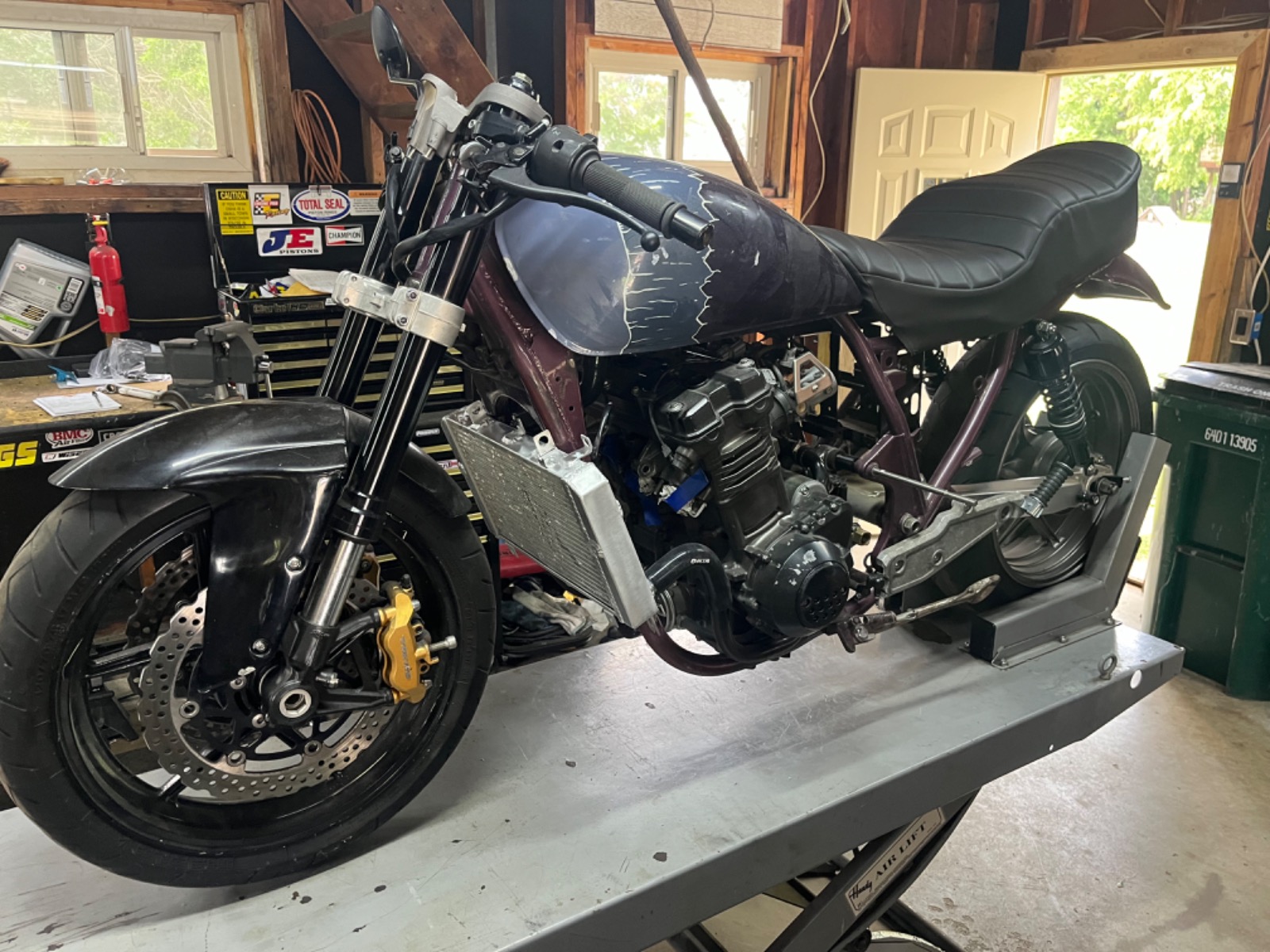

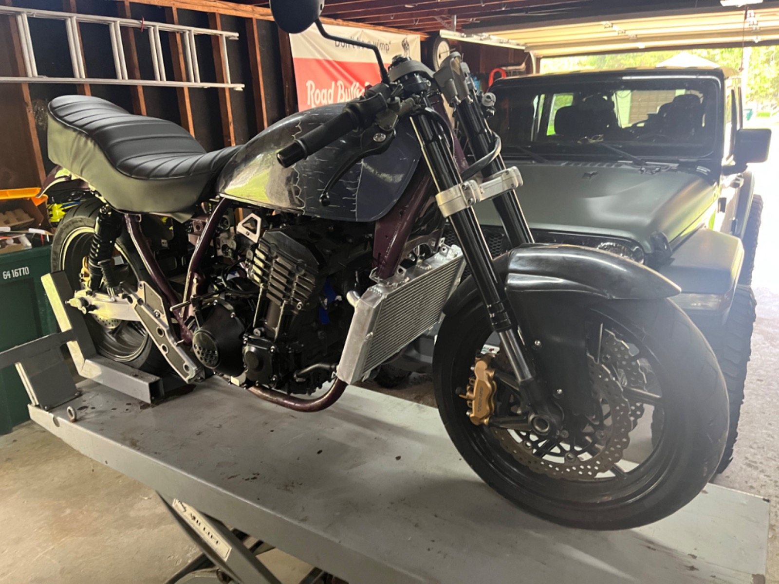

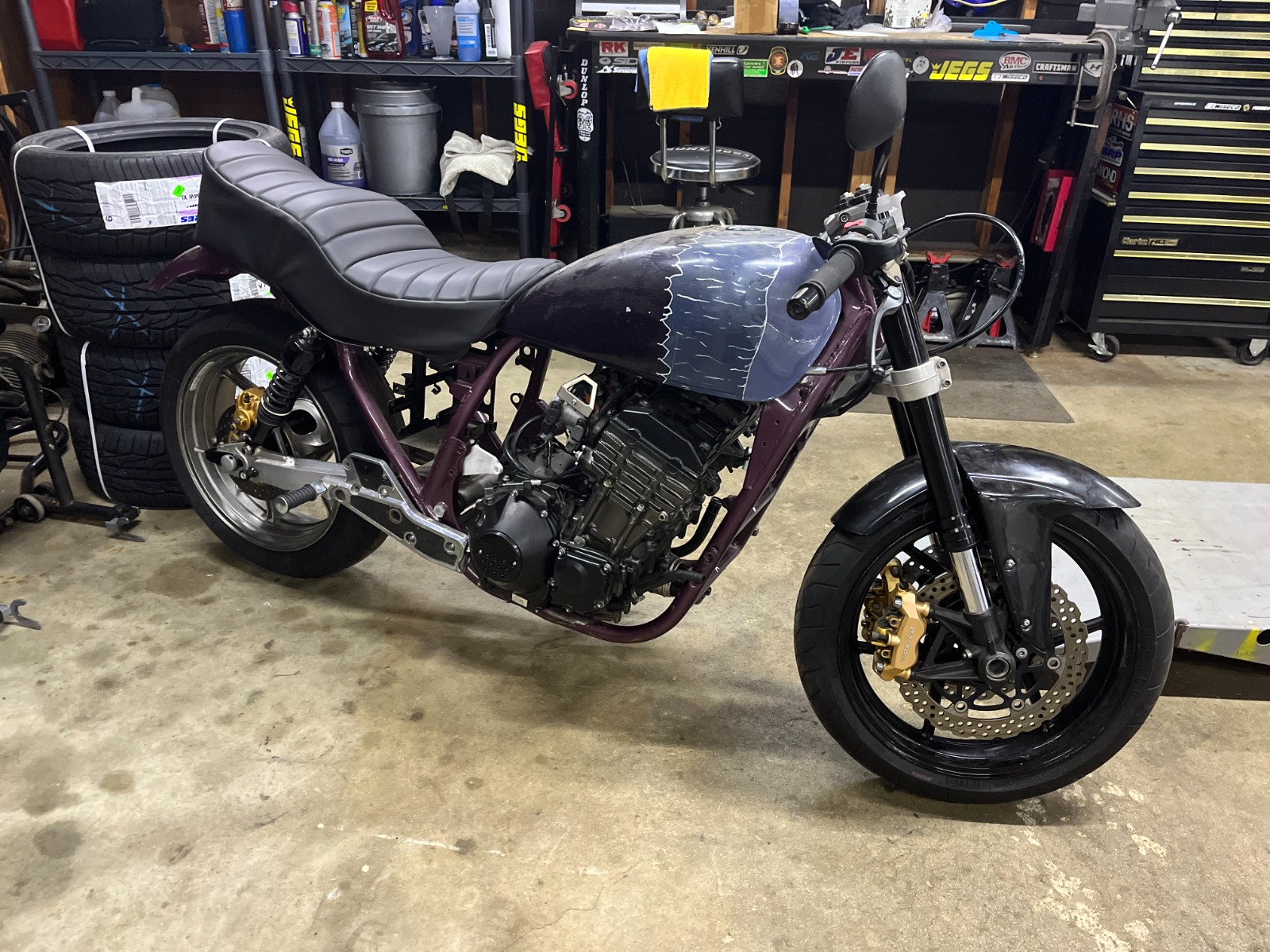

Few more things done, lots of parts added to wish list....
slow going but getting closer.
This is how the bike sits now, everything will be different aside from the general look.
Last edit: 15 Dec 2022 11:53 by Street Fighter LTD.
