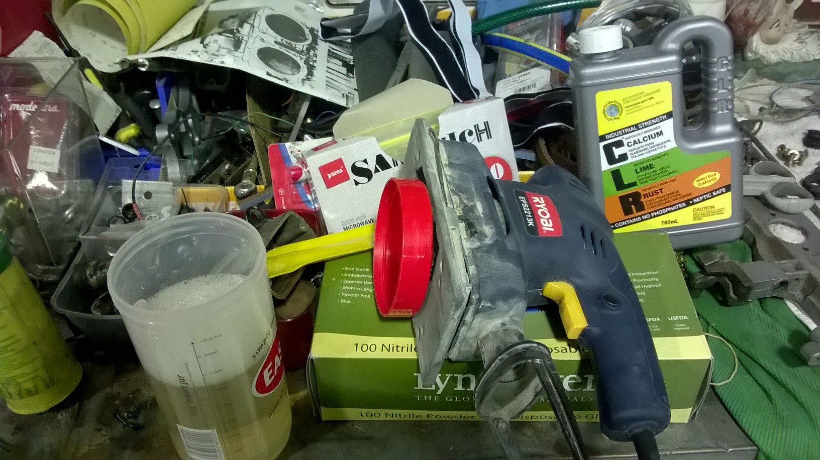

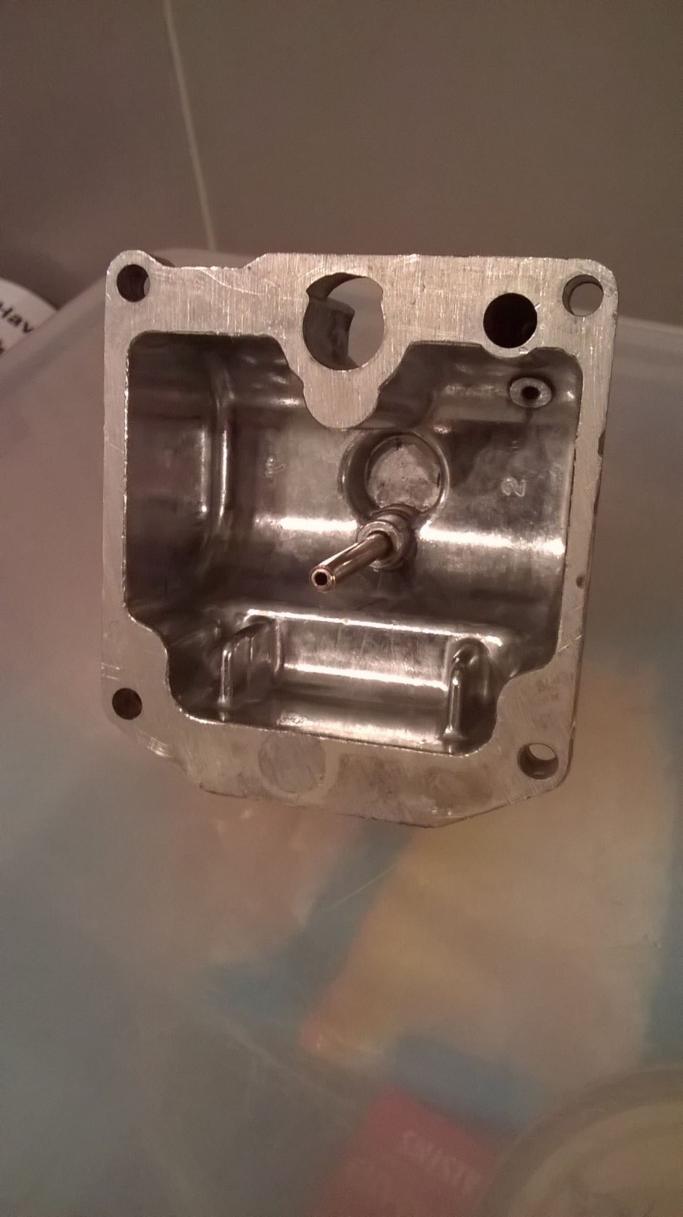

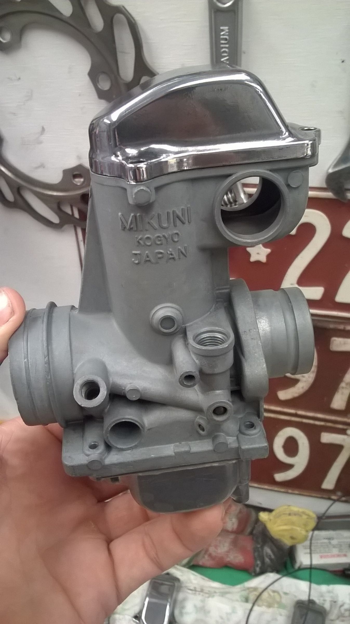

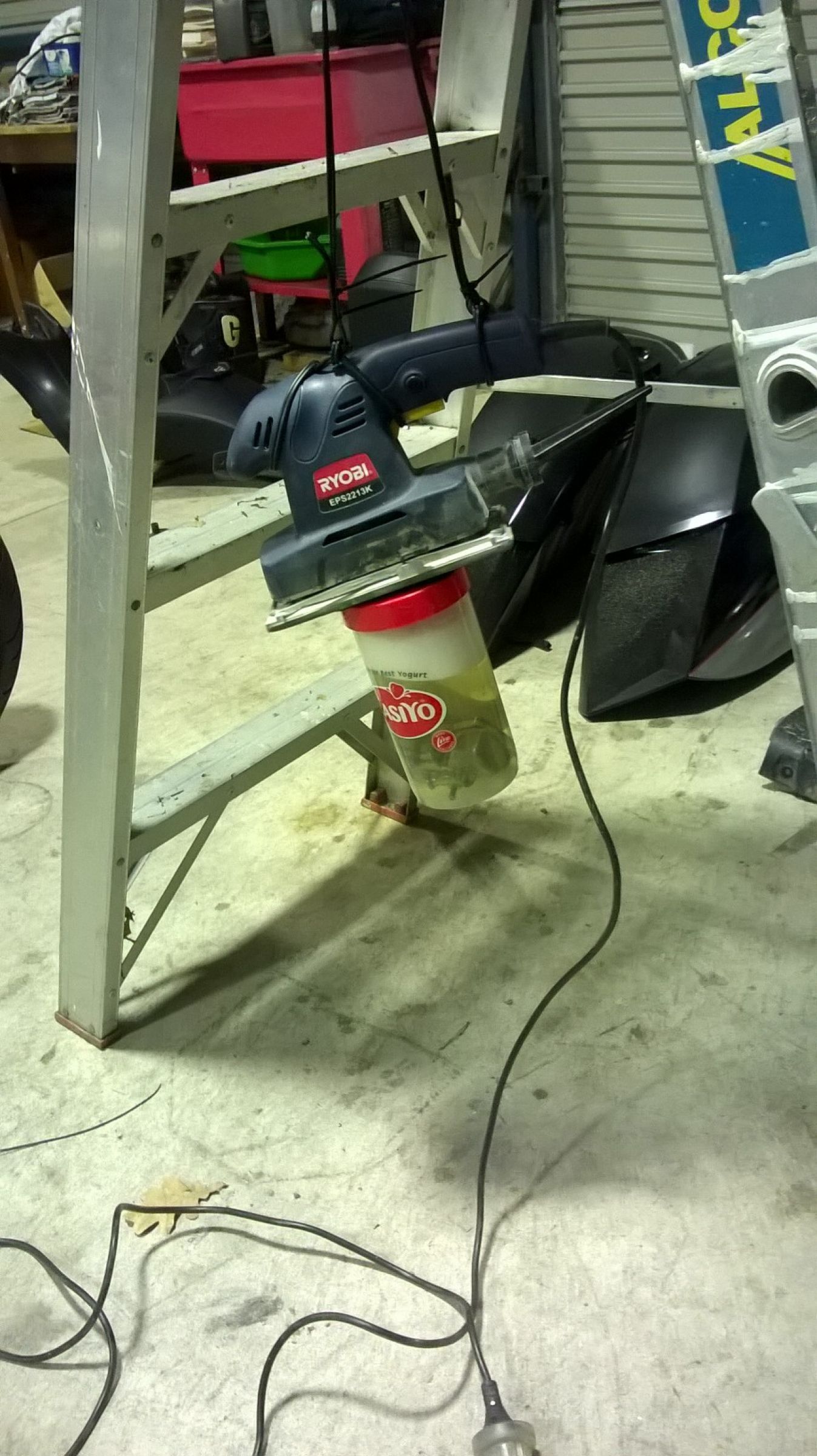

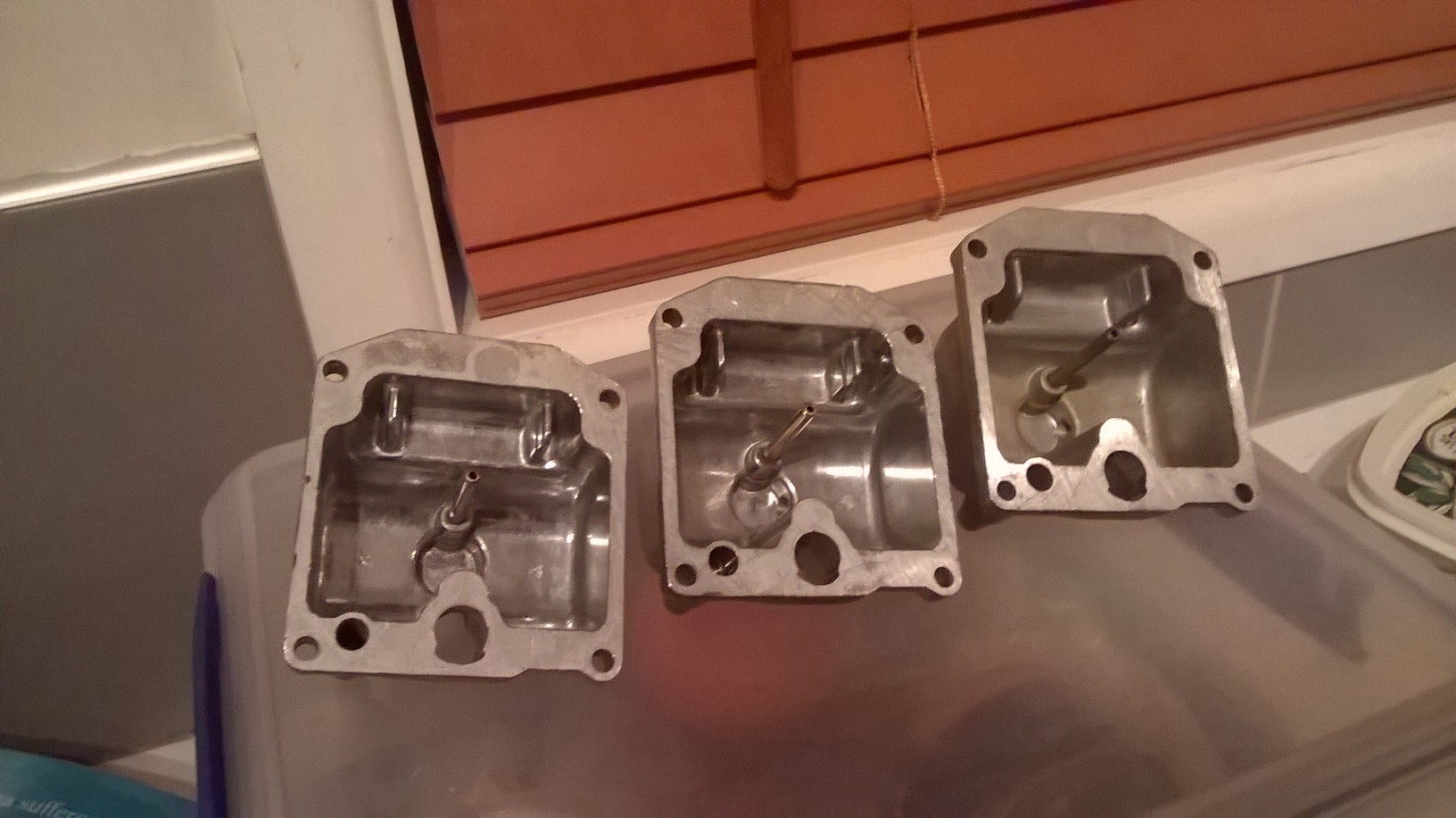

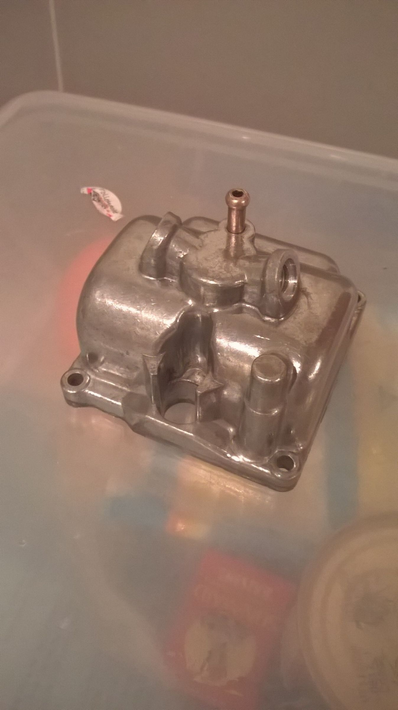

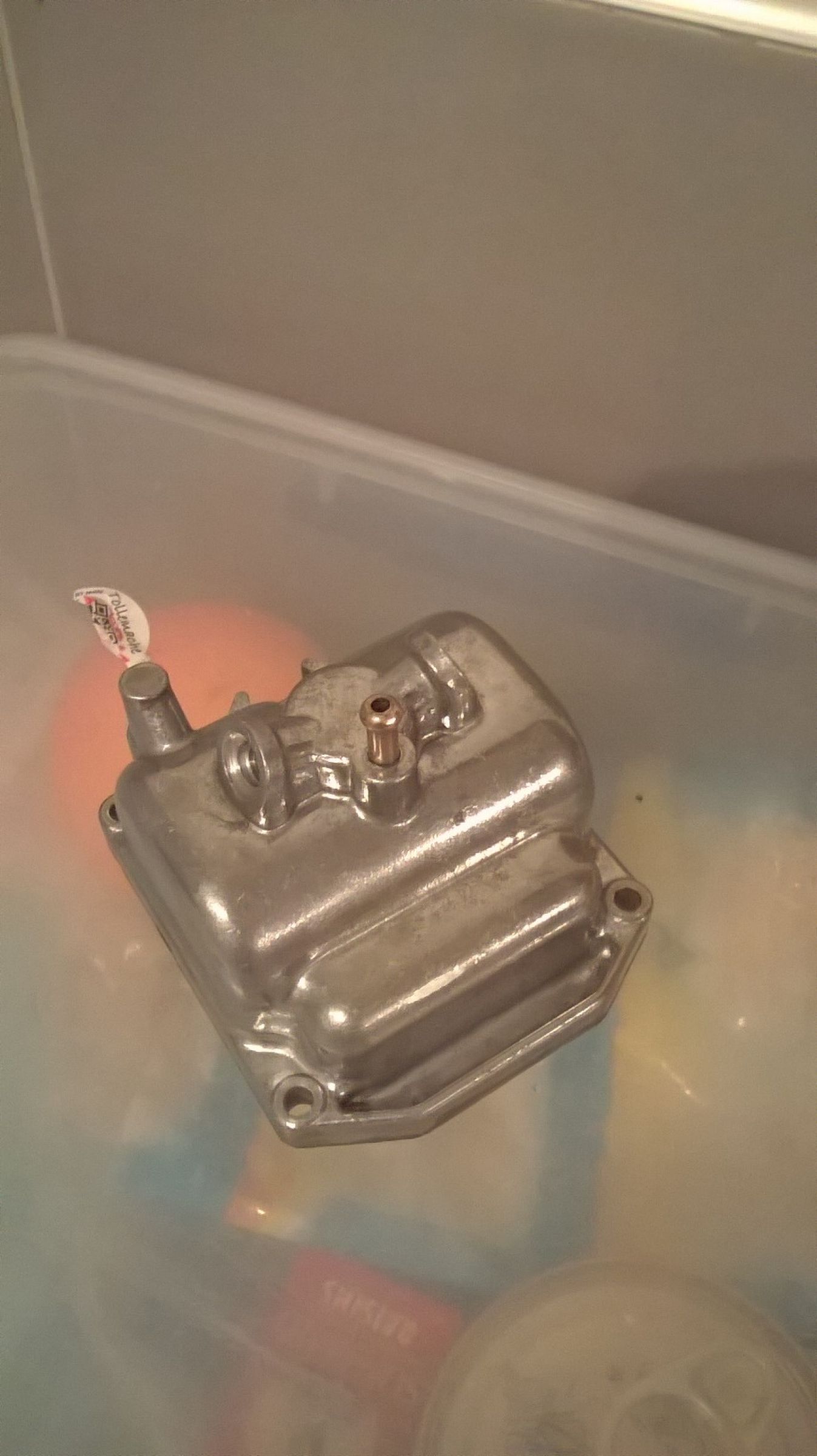

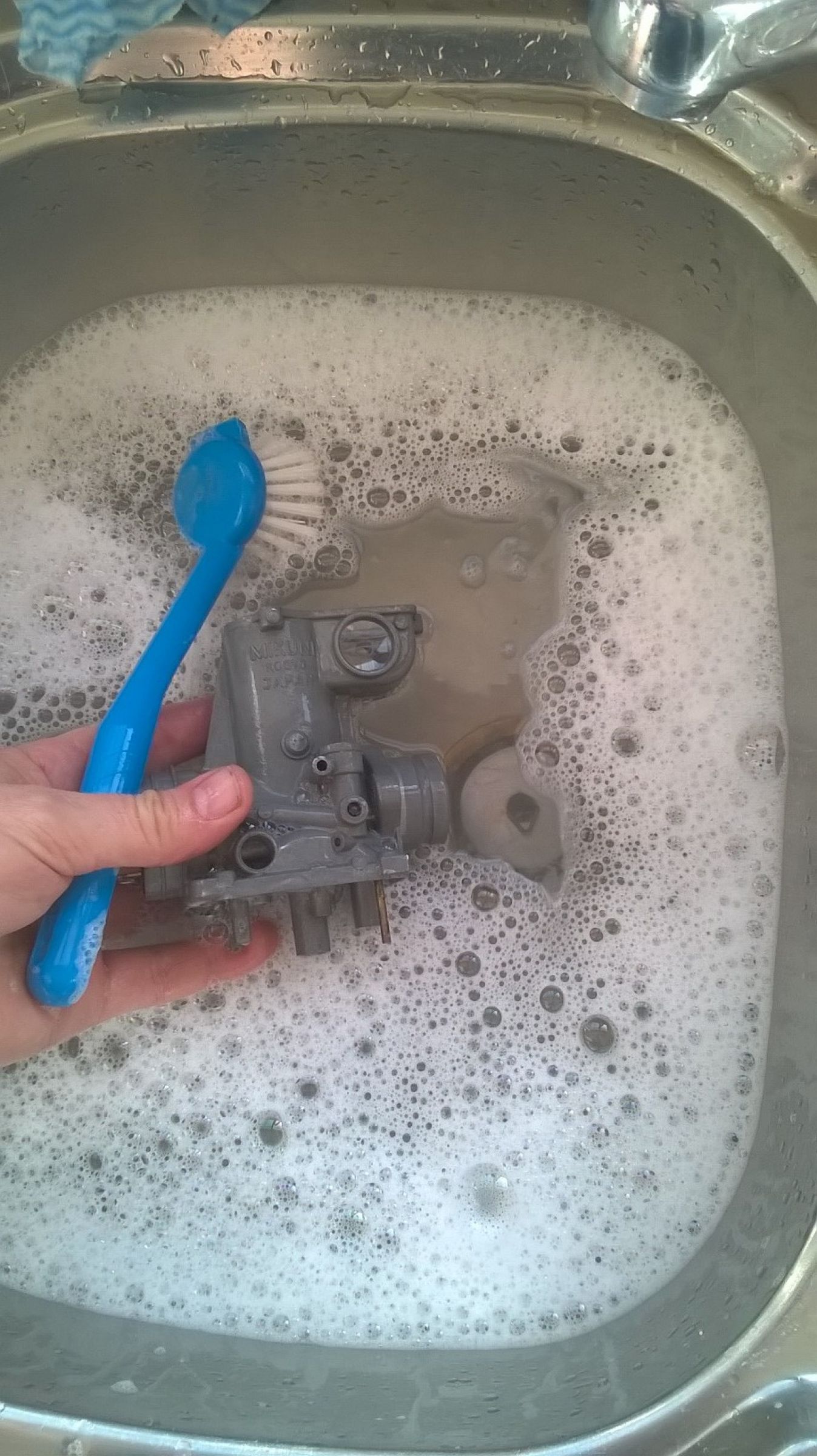

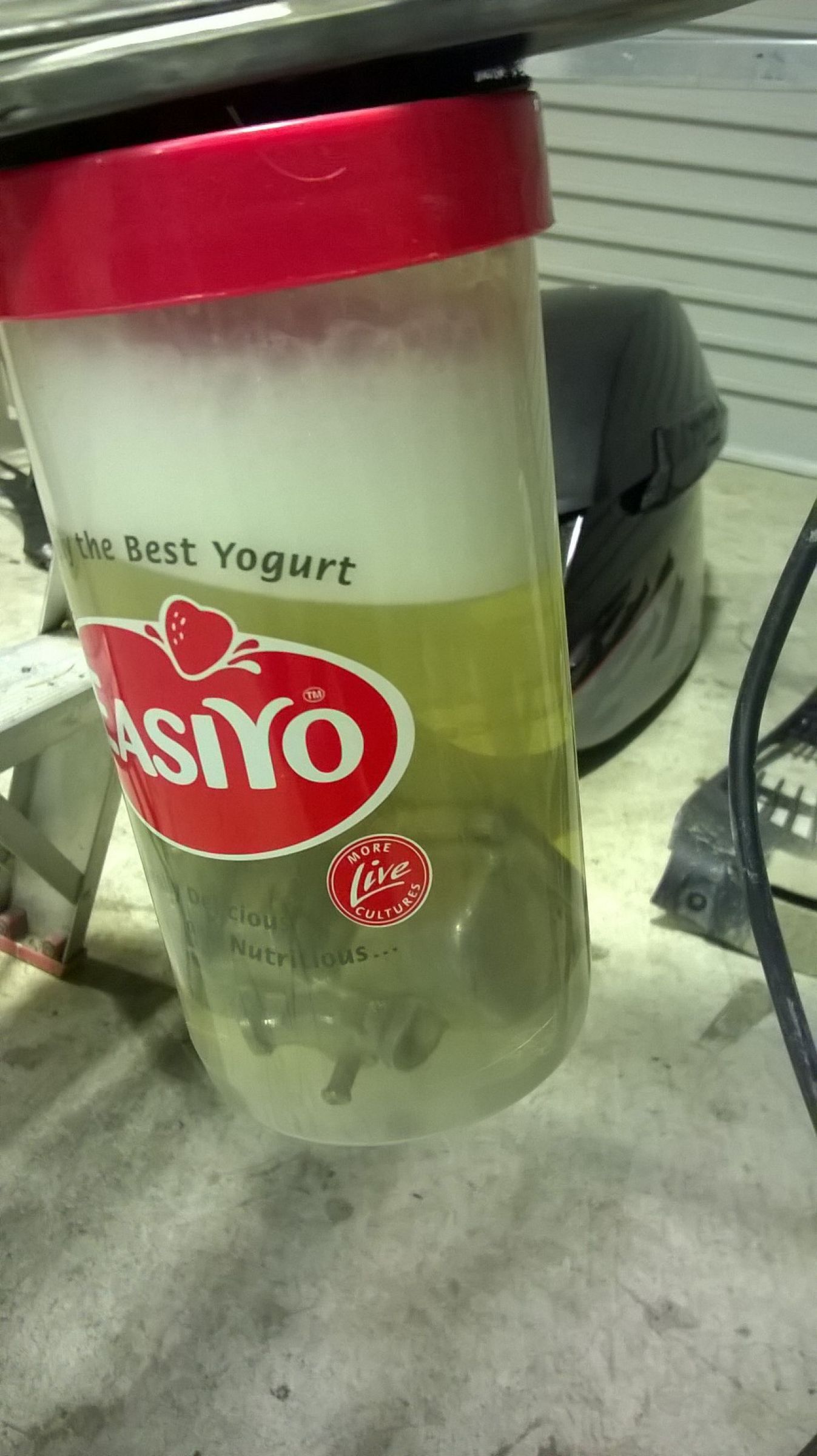

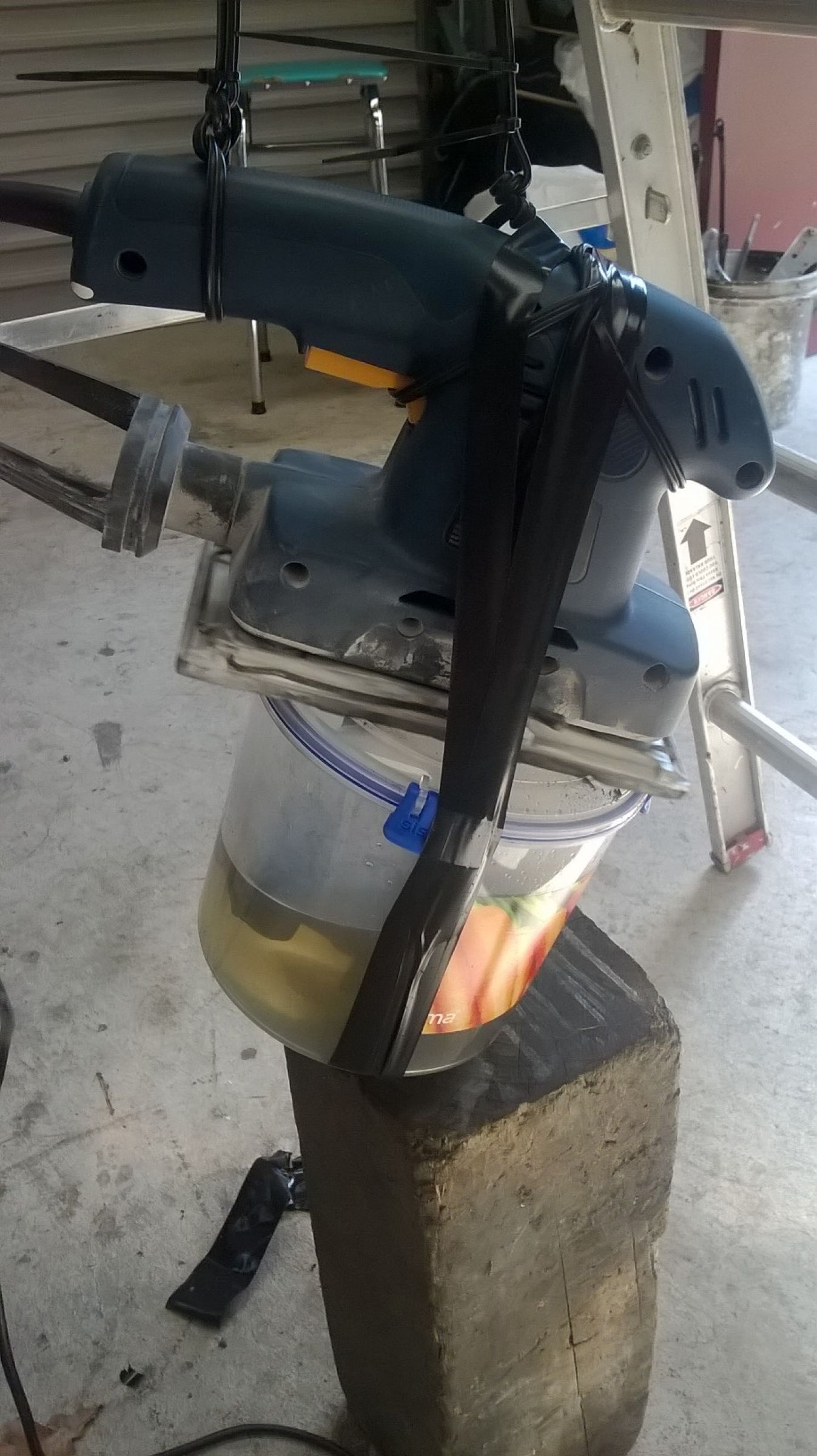

Been meaning to have a go at this for a while. When trawling youtube I came across making your own ultrasound cleaner using a jar and an electric sander. Since the carbs look utter shit that I have anything would be better than nothing and maybe it might work. The guy in the vid used CLR cleaning product as his liquid and funnily enough I had a container with 300ml left in it so made a 50/50 mix. Then I velcroed one of the wifes yoghurt making kit jars to the bottom (she'll never know) and hung the sander up in the air and left it going for 30 mins. Yes, it did vibrate off so had to use a very technical addition to hold the jar onto the sander. When I pulled out the carb bottom I took inside and gave it a quick scrub in the sink with some dish washing liquid and done. Came up pretty good to be honest. Will have a go on something a bit grubbier tomorrow and give it another half hour and see how that goes.

Now that is genius! I got my carbs done in a 'proper' one and they never looked that good.

im curious how much of that is the sander and how much is the CLR. you should do a test with just CLR and compare results.

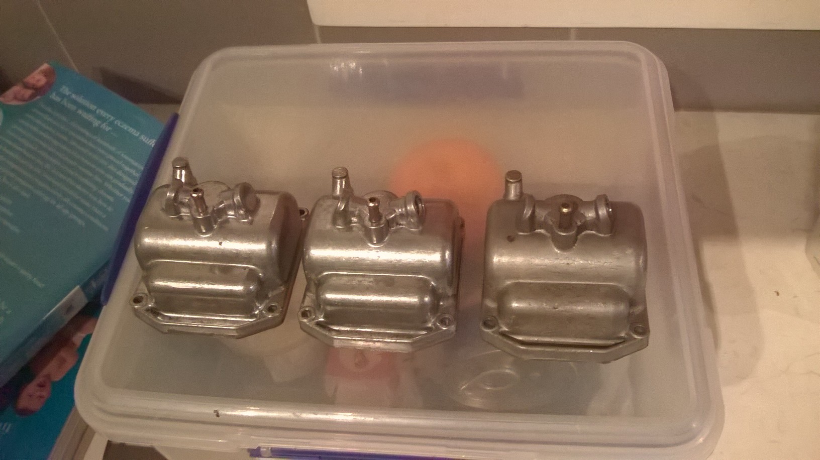

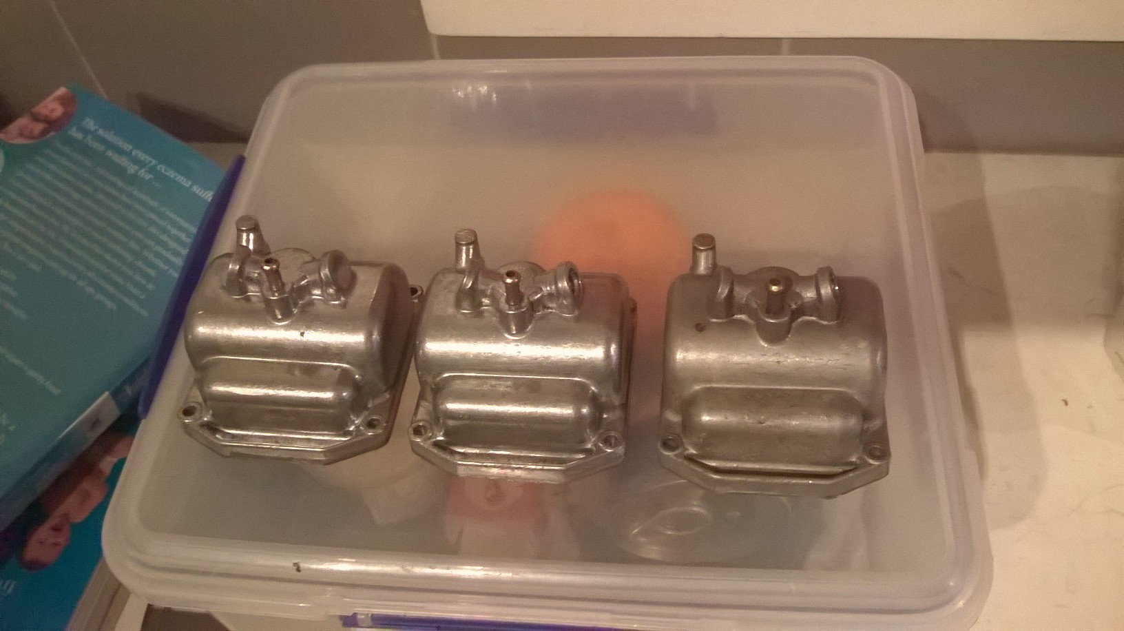

01 Jul 2016 00:37DoctoRot wrote: im curious how much of that is the sander and how much is the CLR. you should do a test with just CLR and compare results.

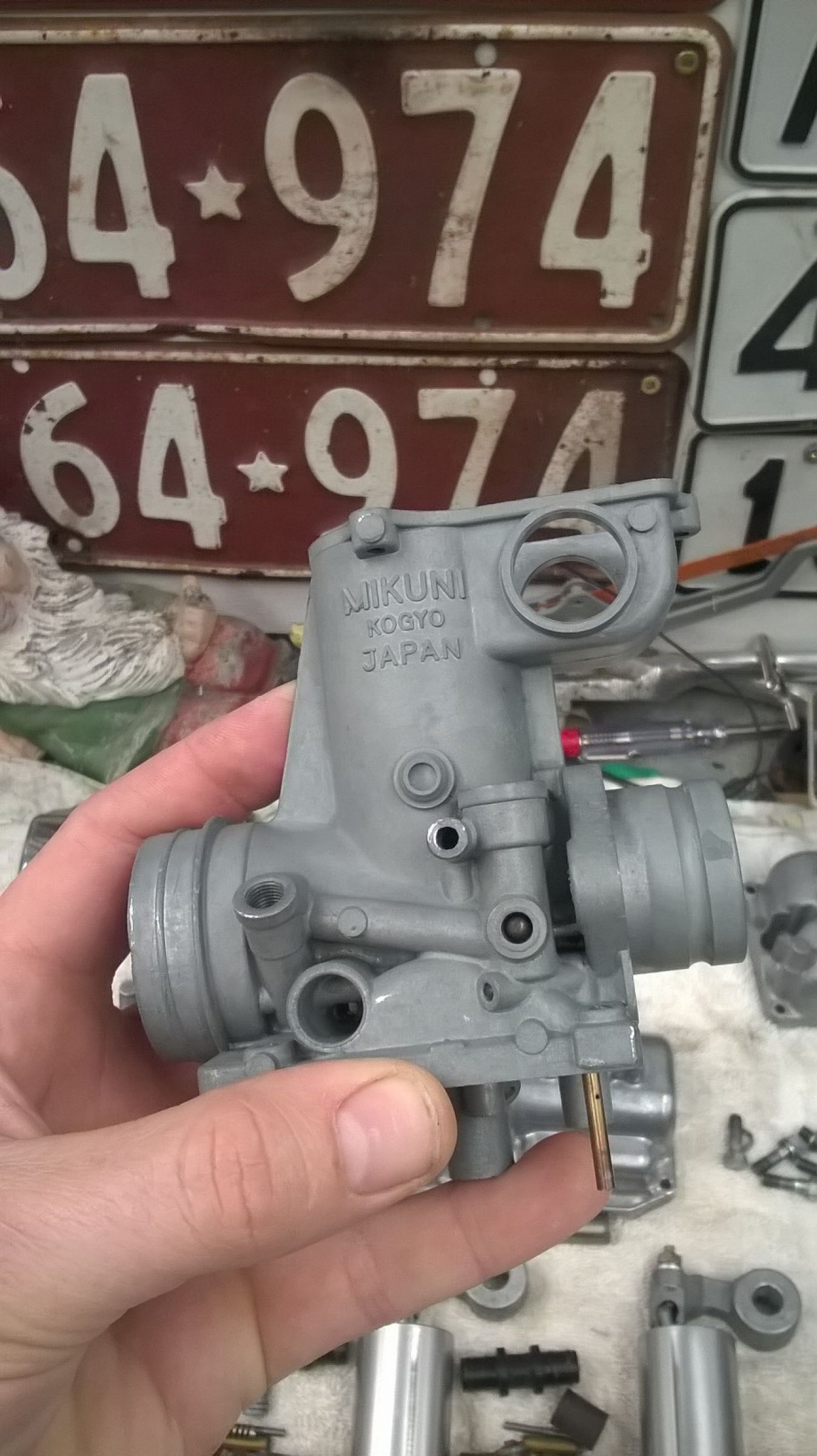

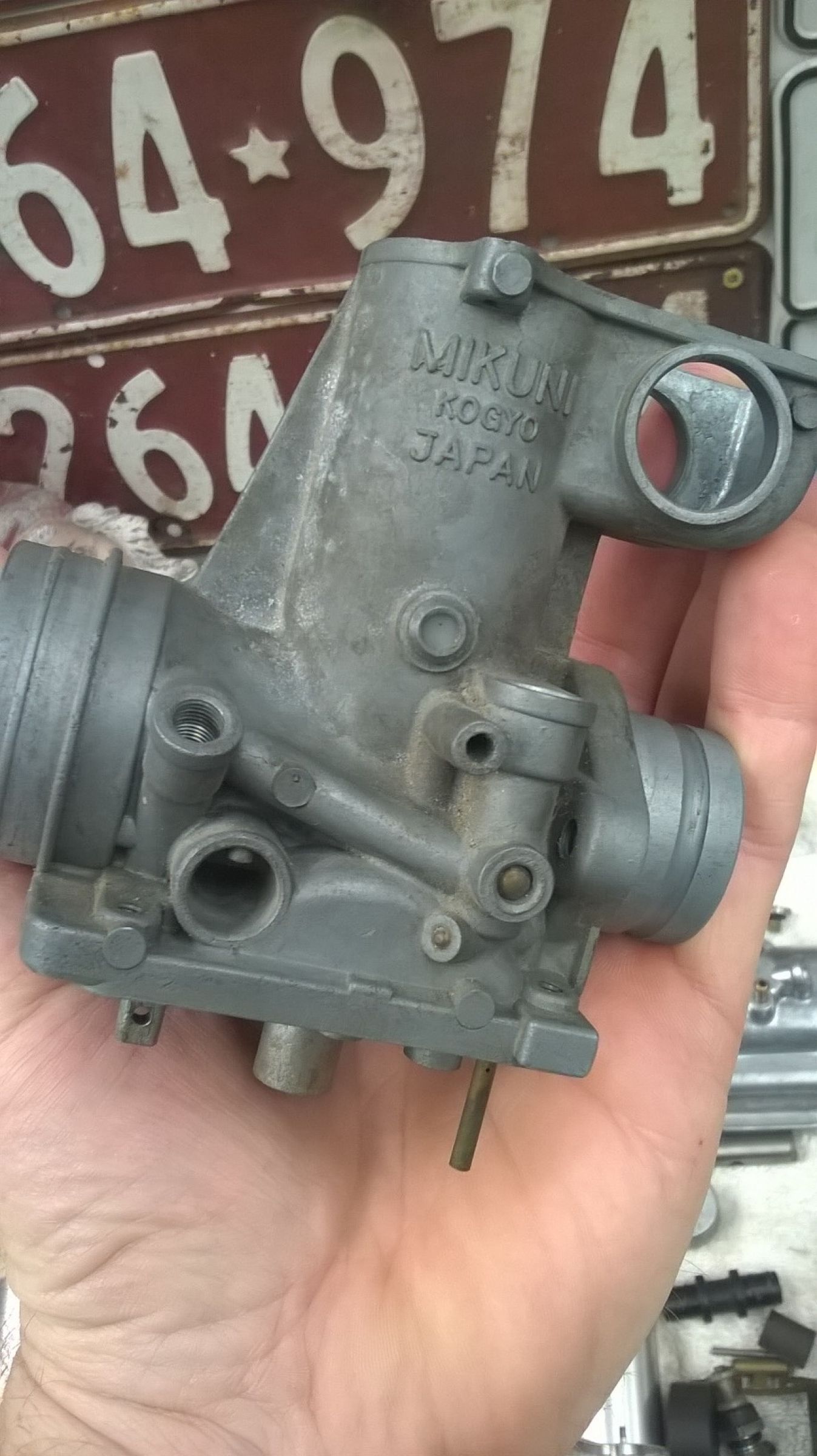

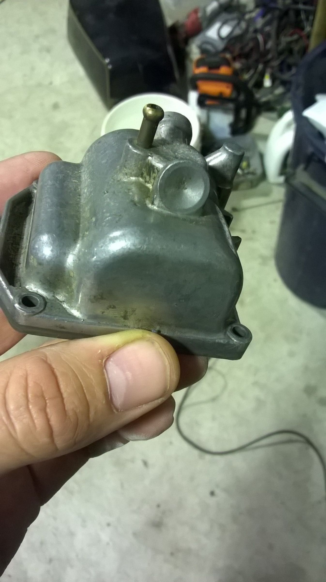

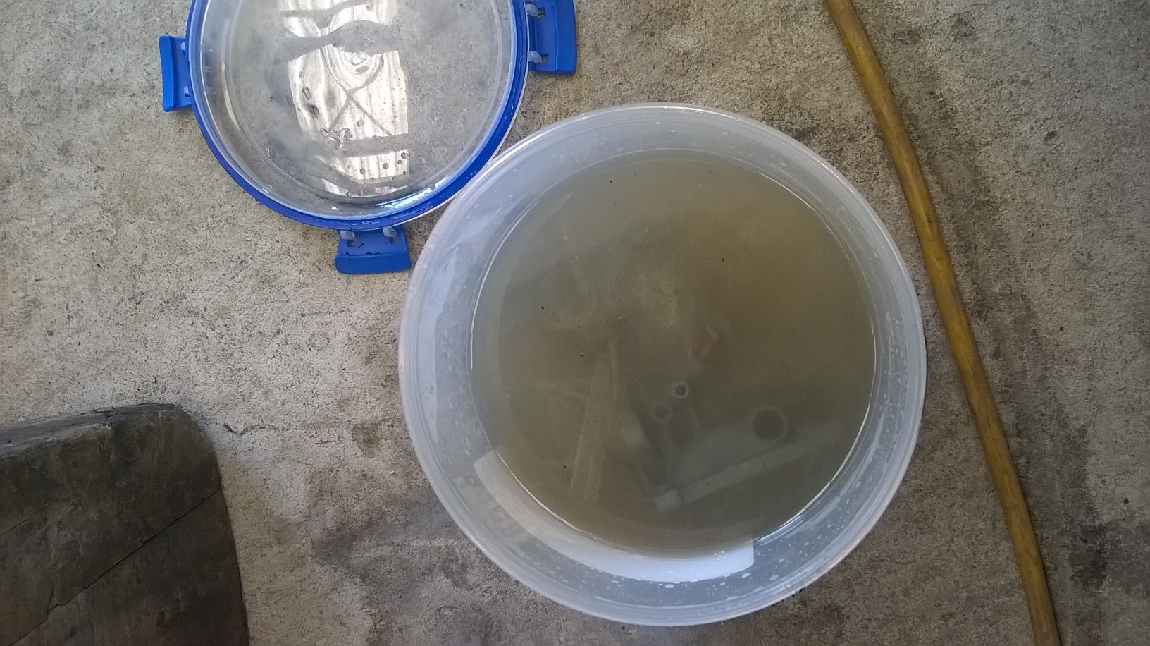

Funnily enough I did that lol. Basically I got the same result with the CLR by itself but I had to leave it in the solution for 3 and half hours to get it. Photos show the shaken/CLR on the left, just CLR in the middle, and unclean on the right. Not a lot of difference just time really. I am going to pop into town tomorrow and find a jar big enough to fit the main carb body in and have a crack at that.

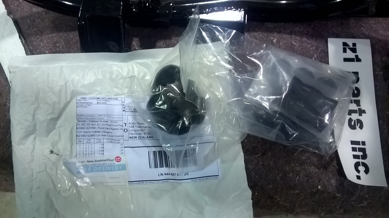

I ordered some rubbers n bits and bobs from Z1 Parts Inc the other day and blam!!! ...........................................three days later they were on my doorstep. Not bad considering they have come from the US to New Zealand. I can buy parts here in NZ and they take longer to arrive. Big thumbs up to Z1 Parts. Well happy and I will be shopping with them again.

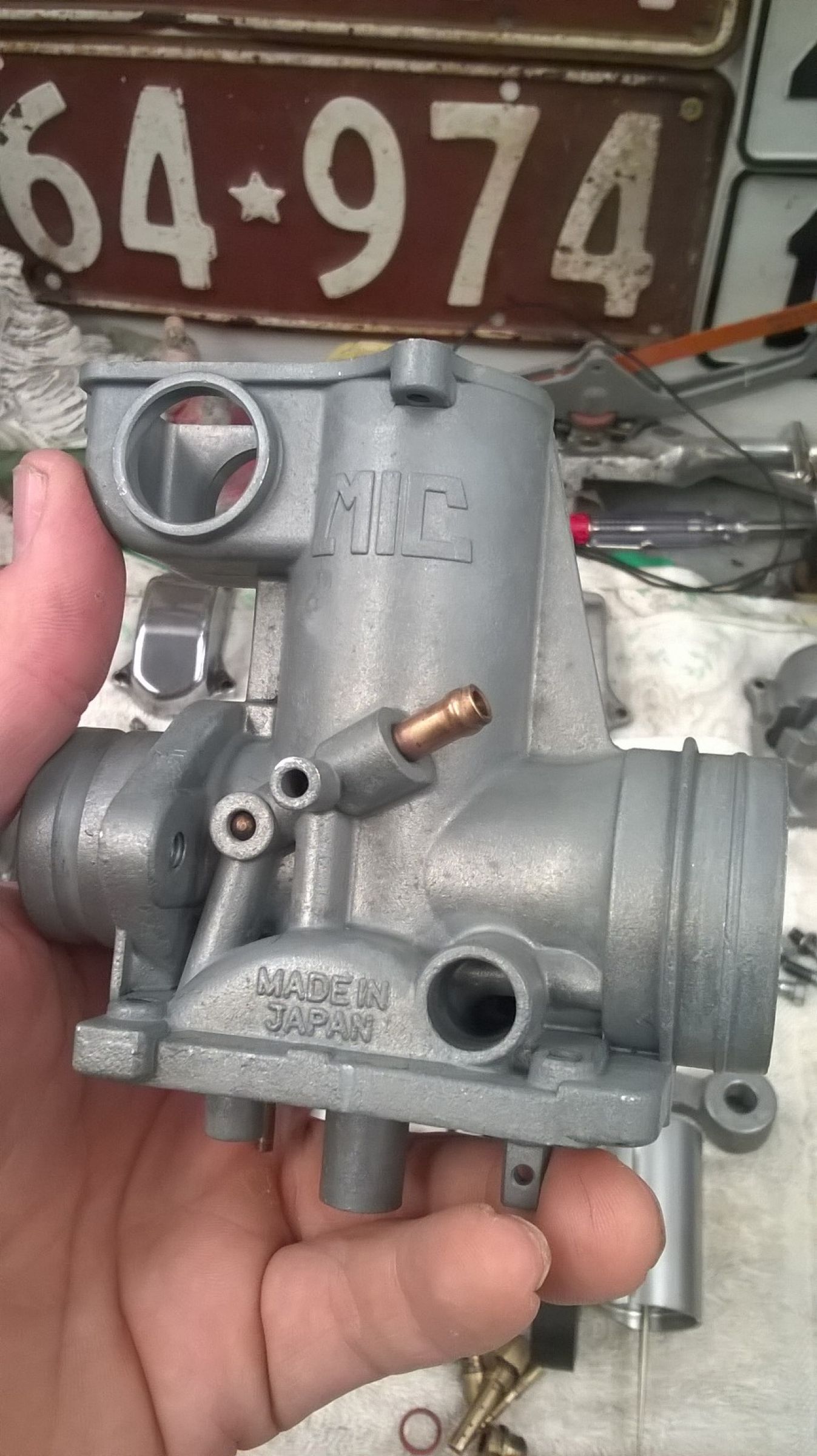

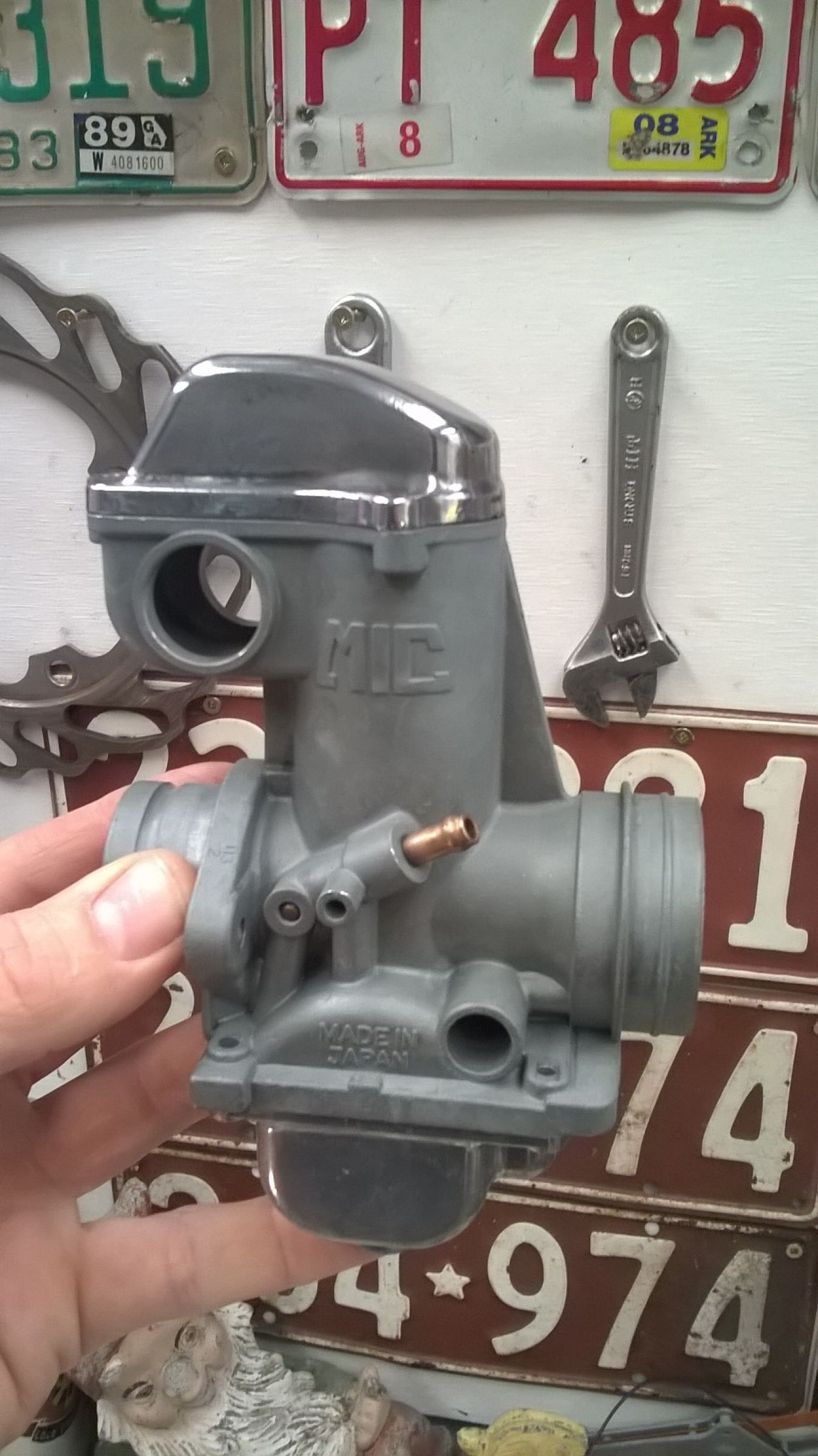

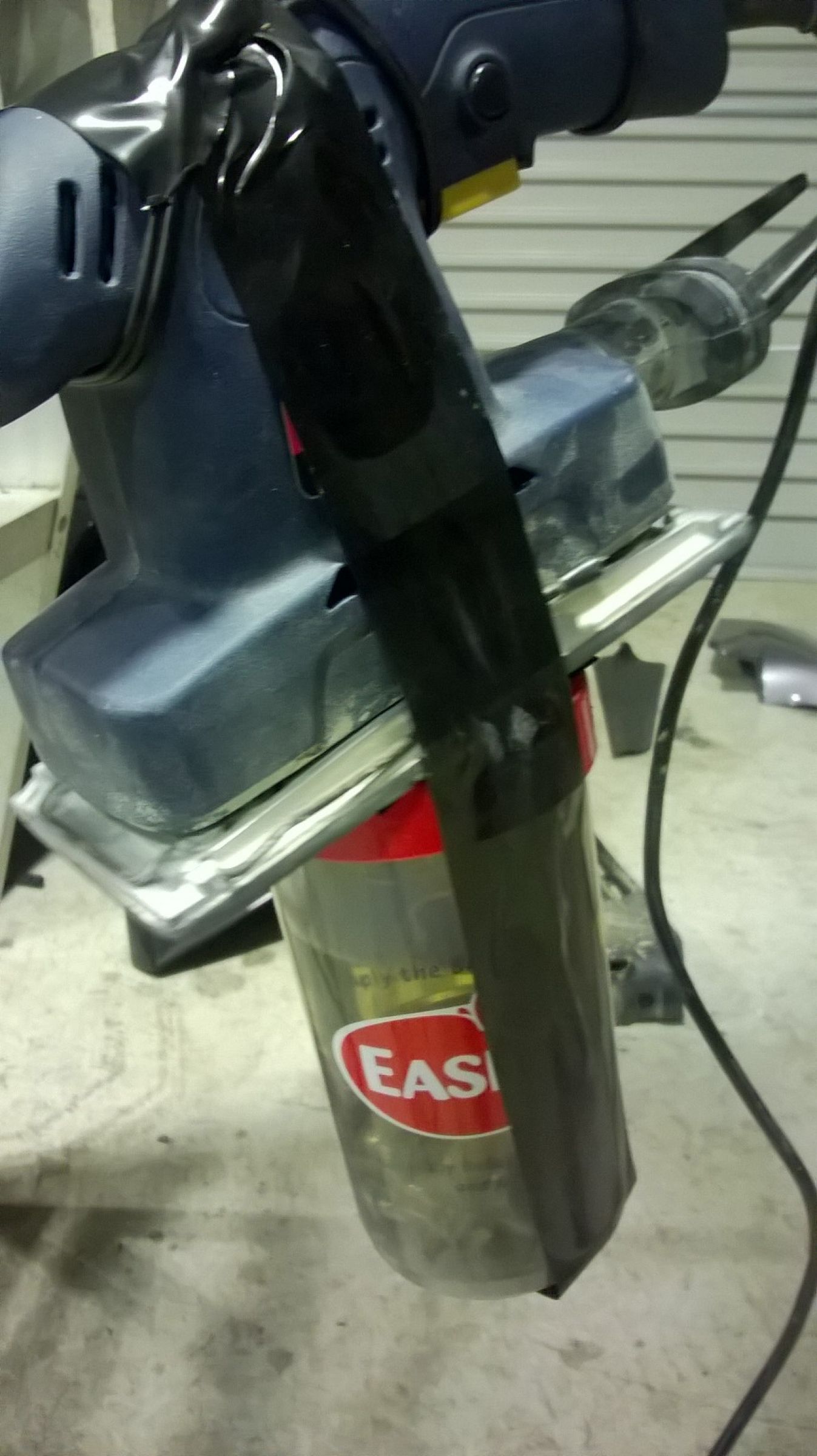

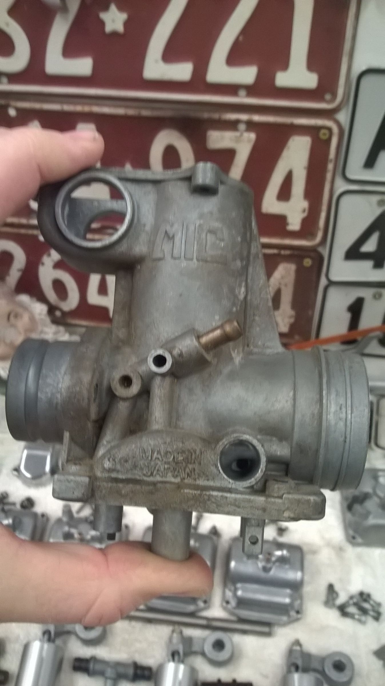

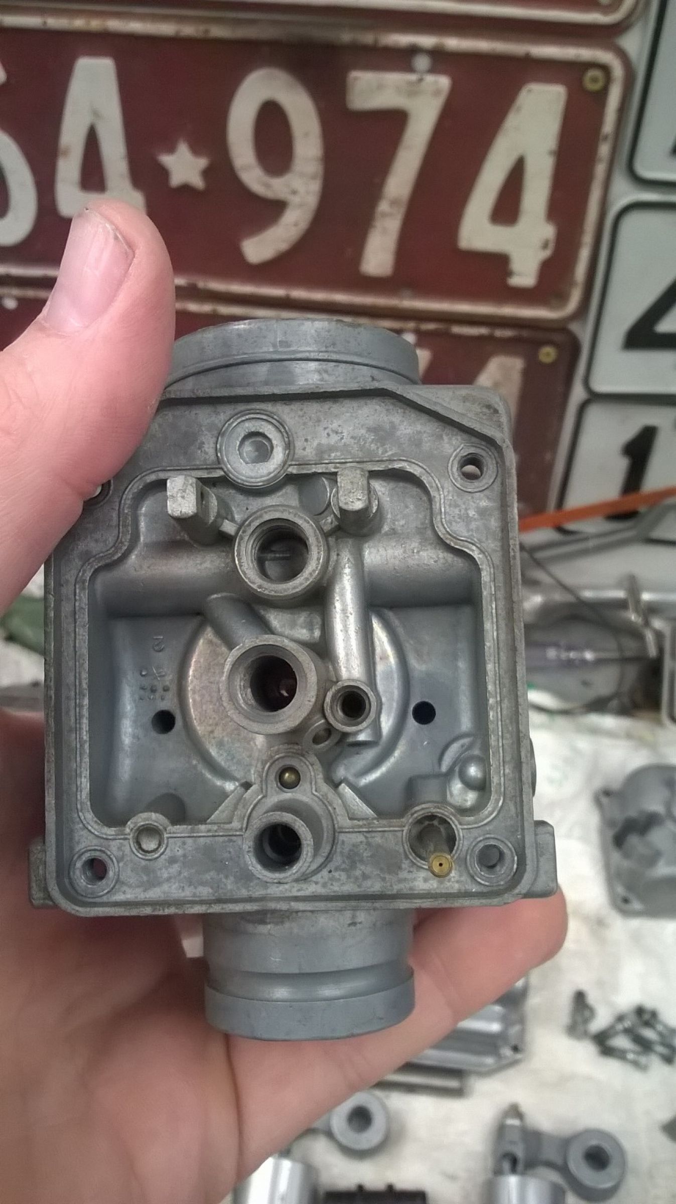

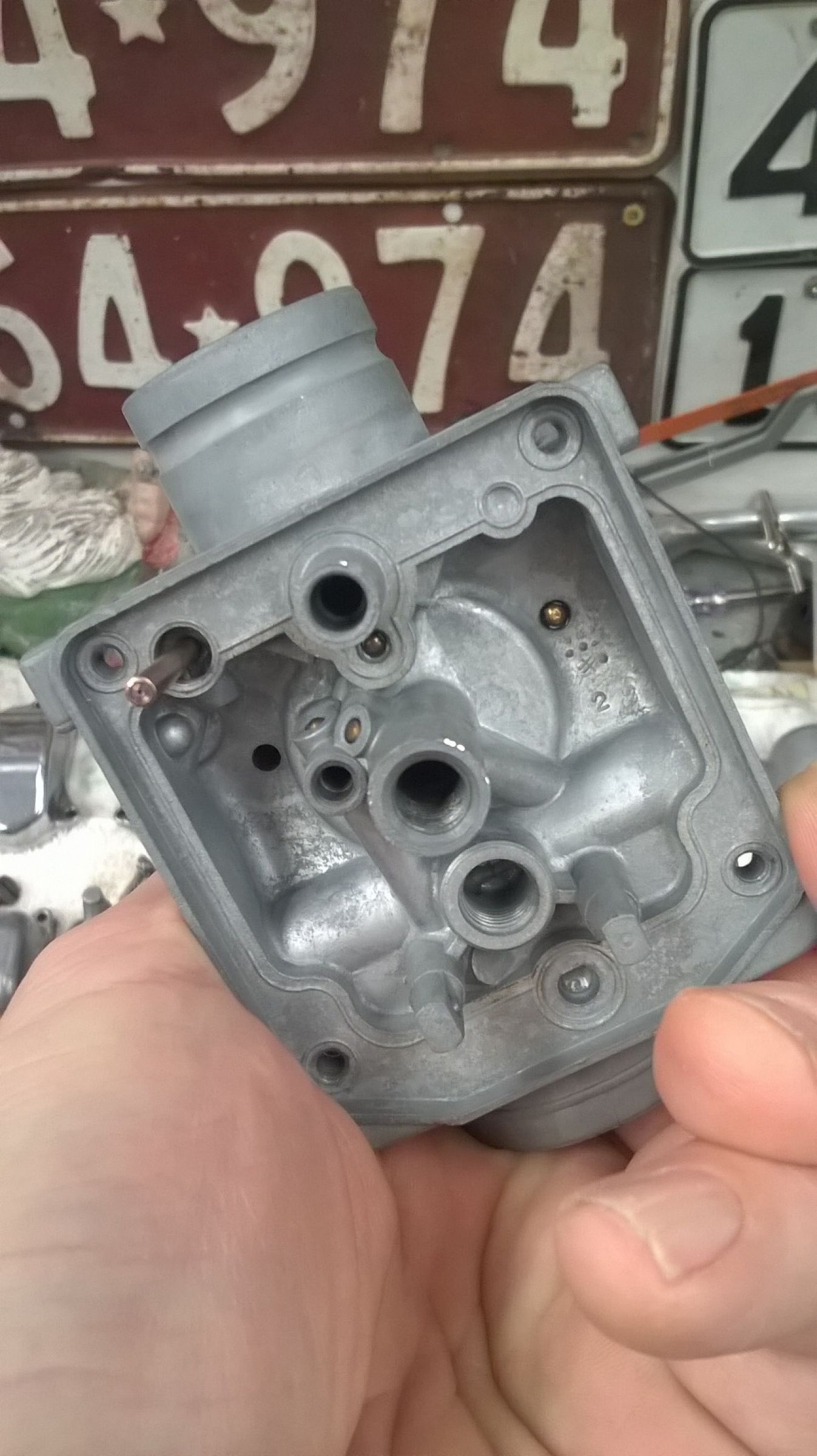

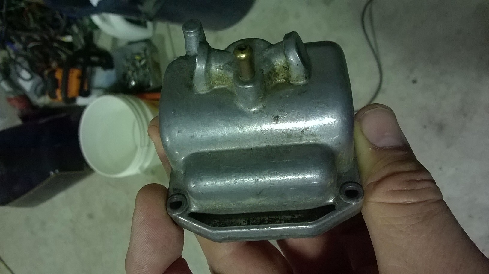

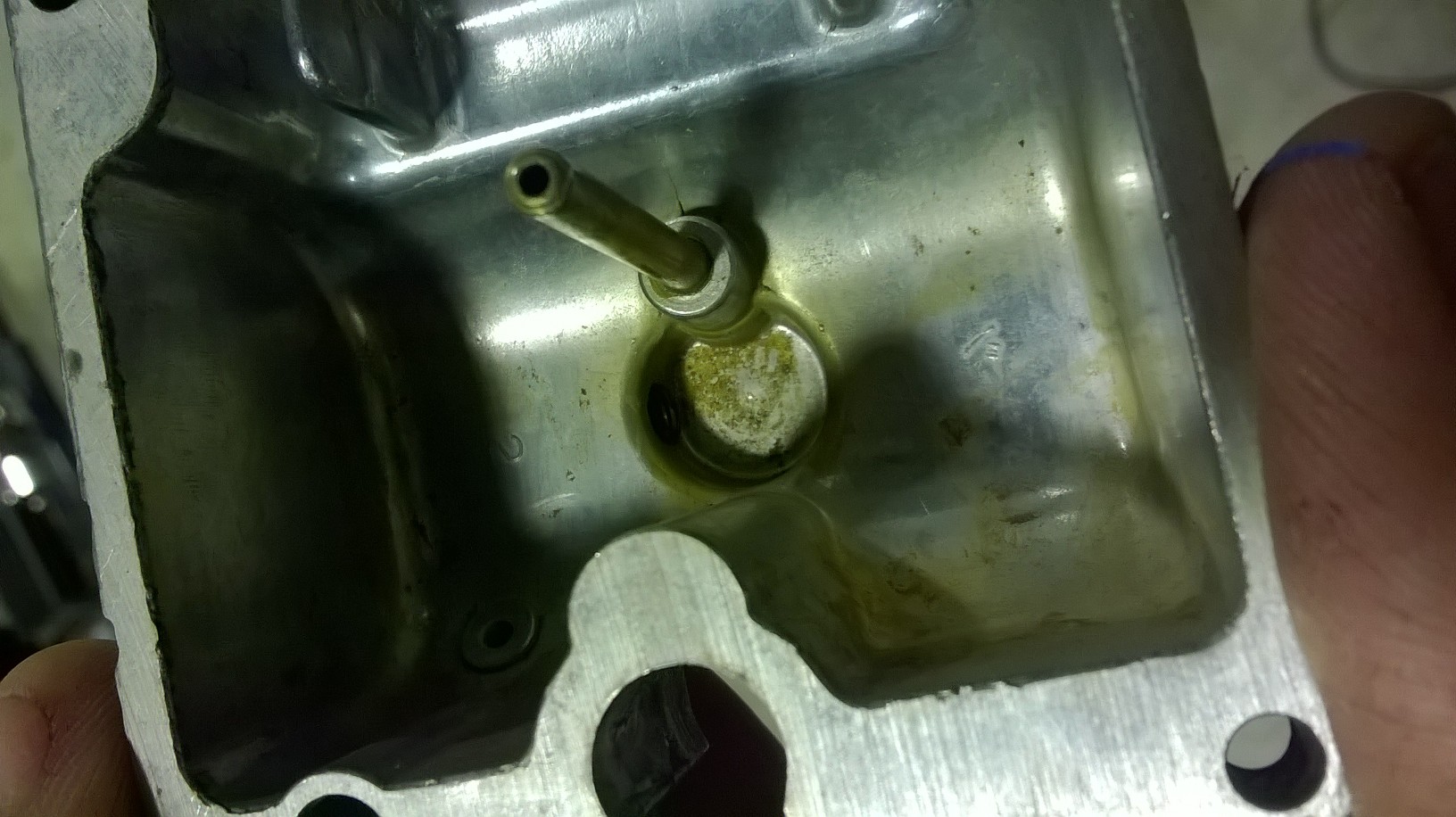

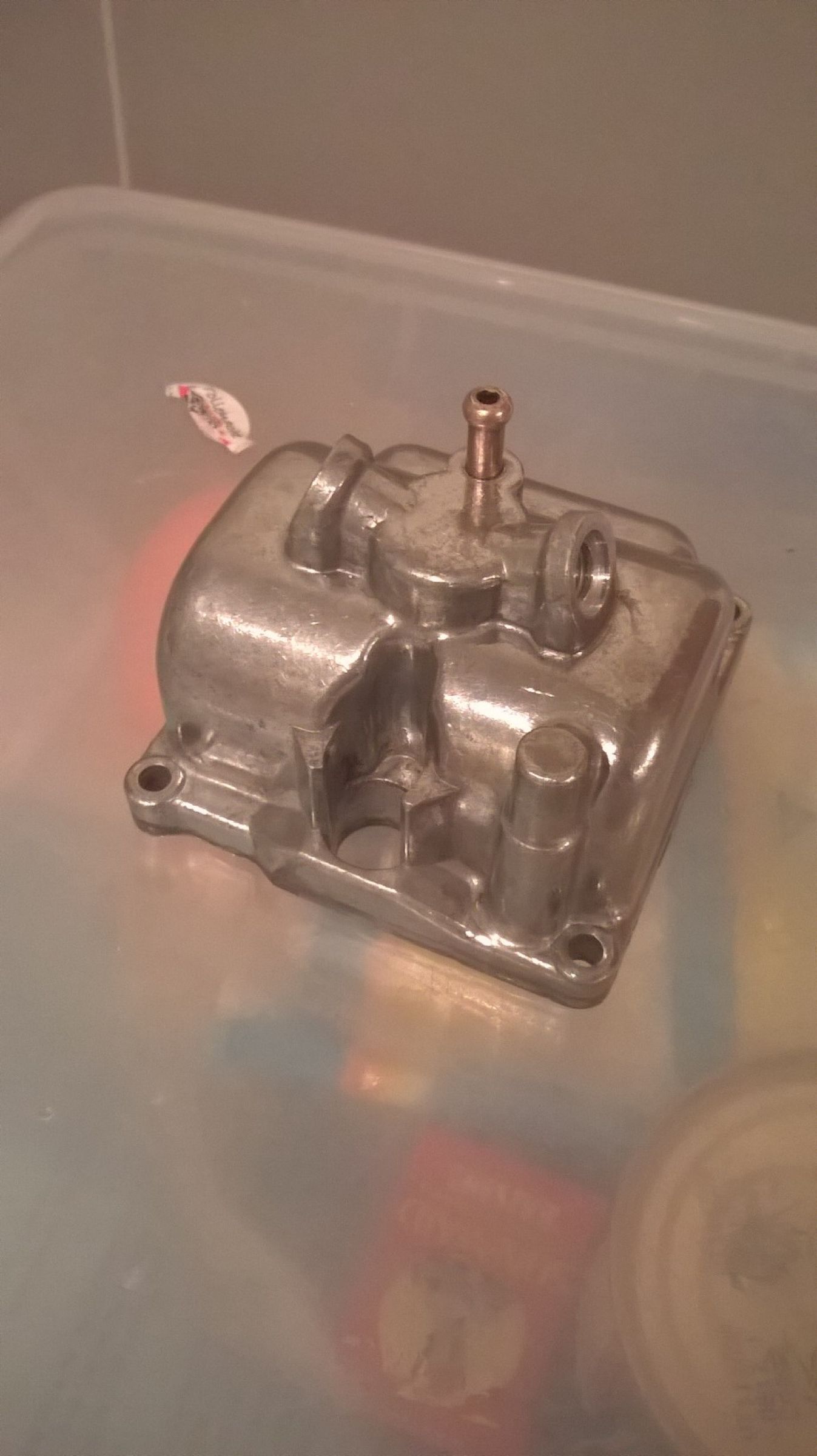

Okay, the plastic jar got an upgrade to the carb body sizd version.
Got a growling for using the sink to rinse and scrub the carb parts. Oops :laugh:
Before................
and after..................

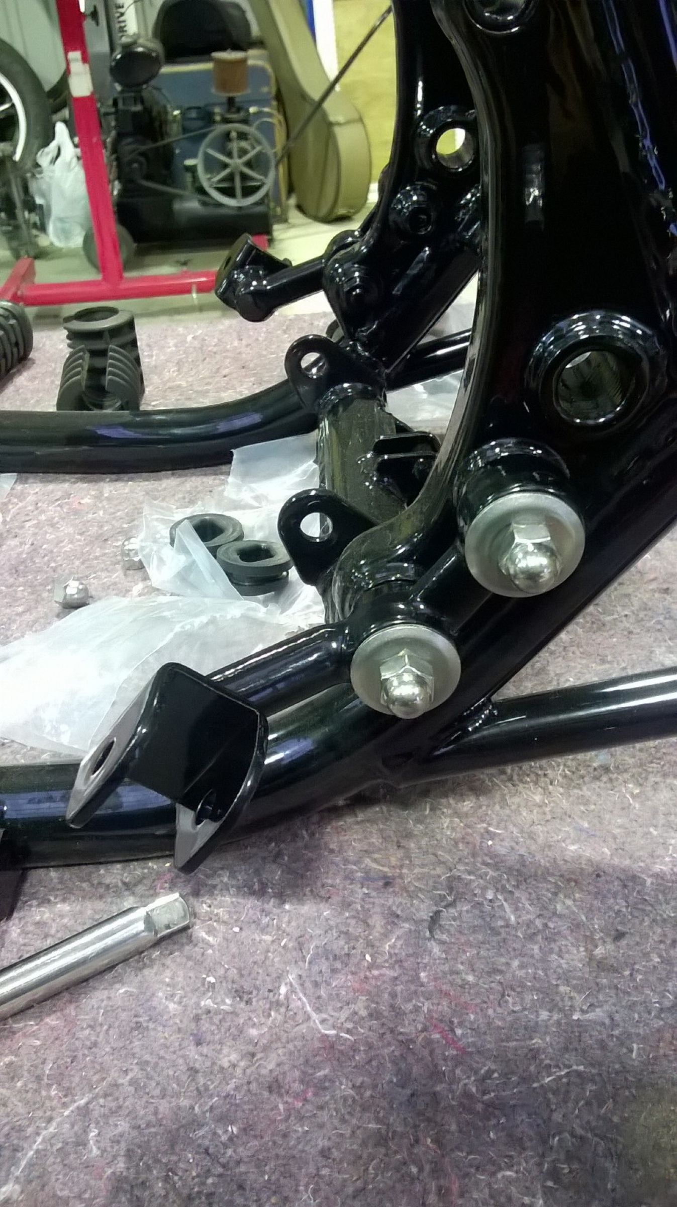

Oh yeah baby!!!!

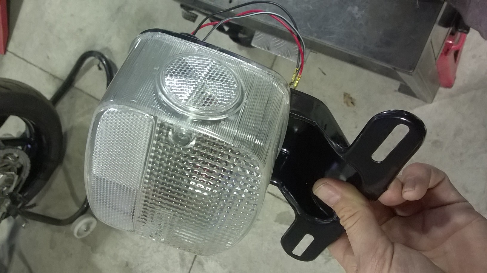

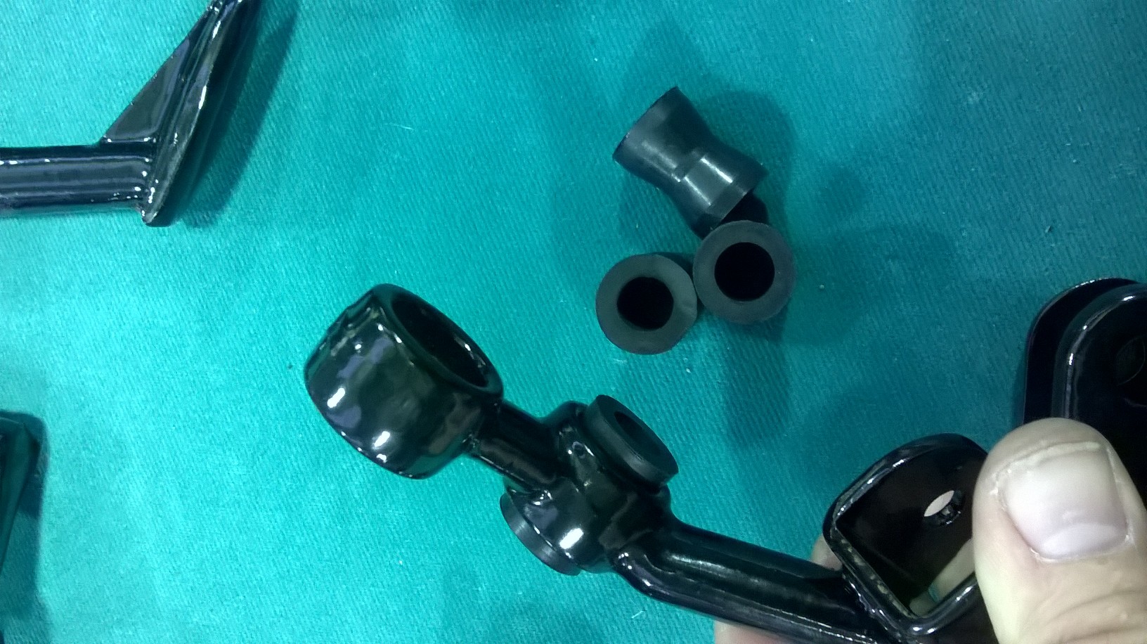

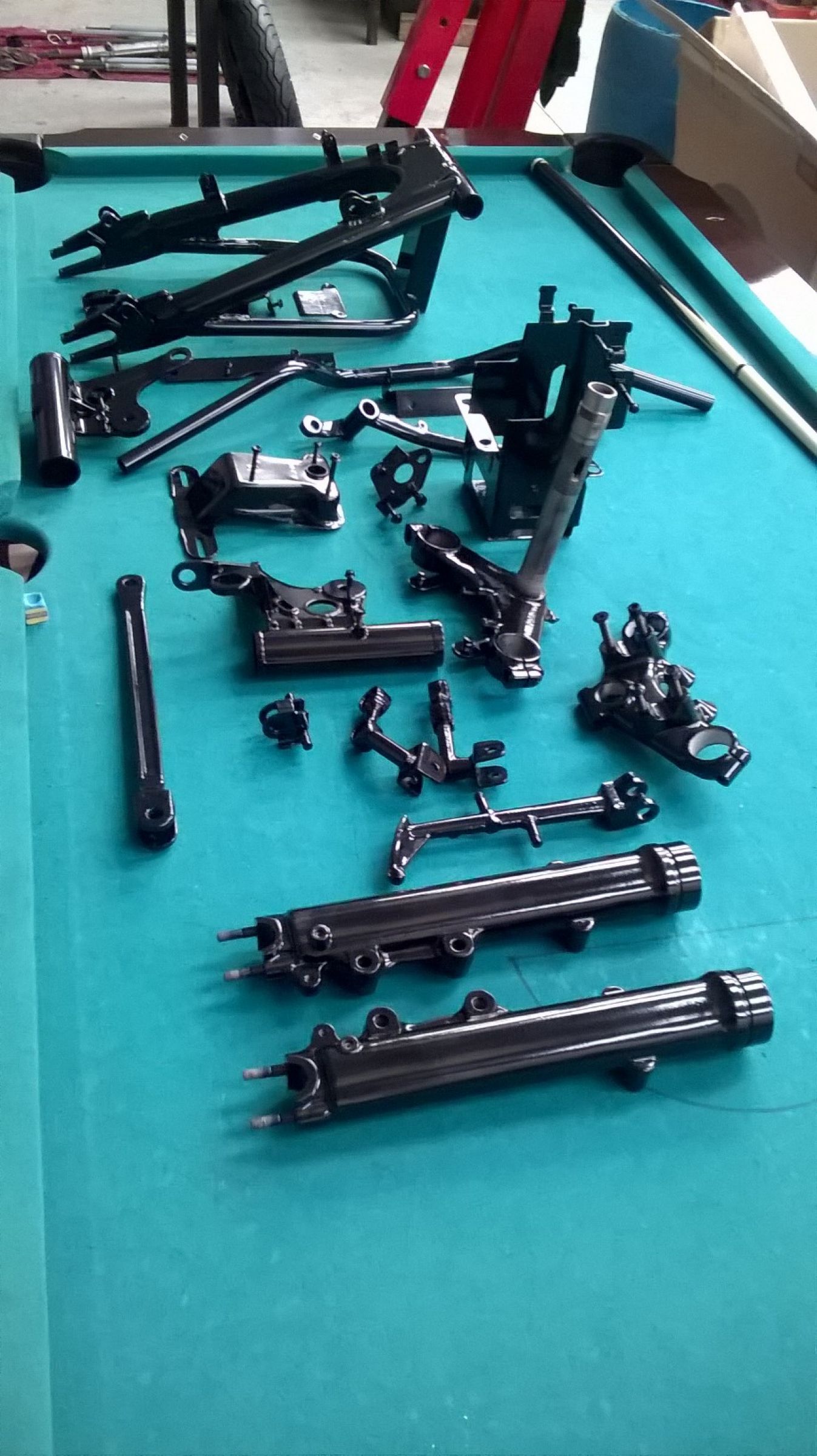

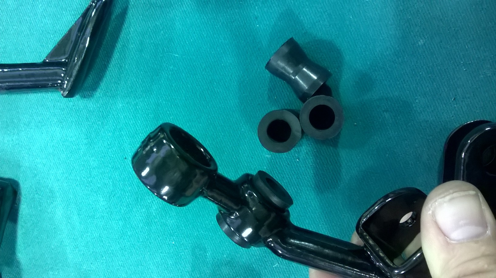

Got my bits back from the powder coaters. Love this bit when you drop off all this old ratty looking shit and voila you beautiful looking motorcycle parts again. Yep, I get a little over excited. Funny thing is this is also the time when you find the couple of parts that you forgot to drop off for coating too :blink: .
Footpeg mounts and new rubber dampers. Done! Might have no motor or wheels but at least I have a place to put my feet (sortof).

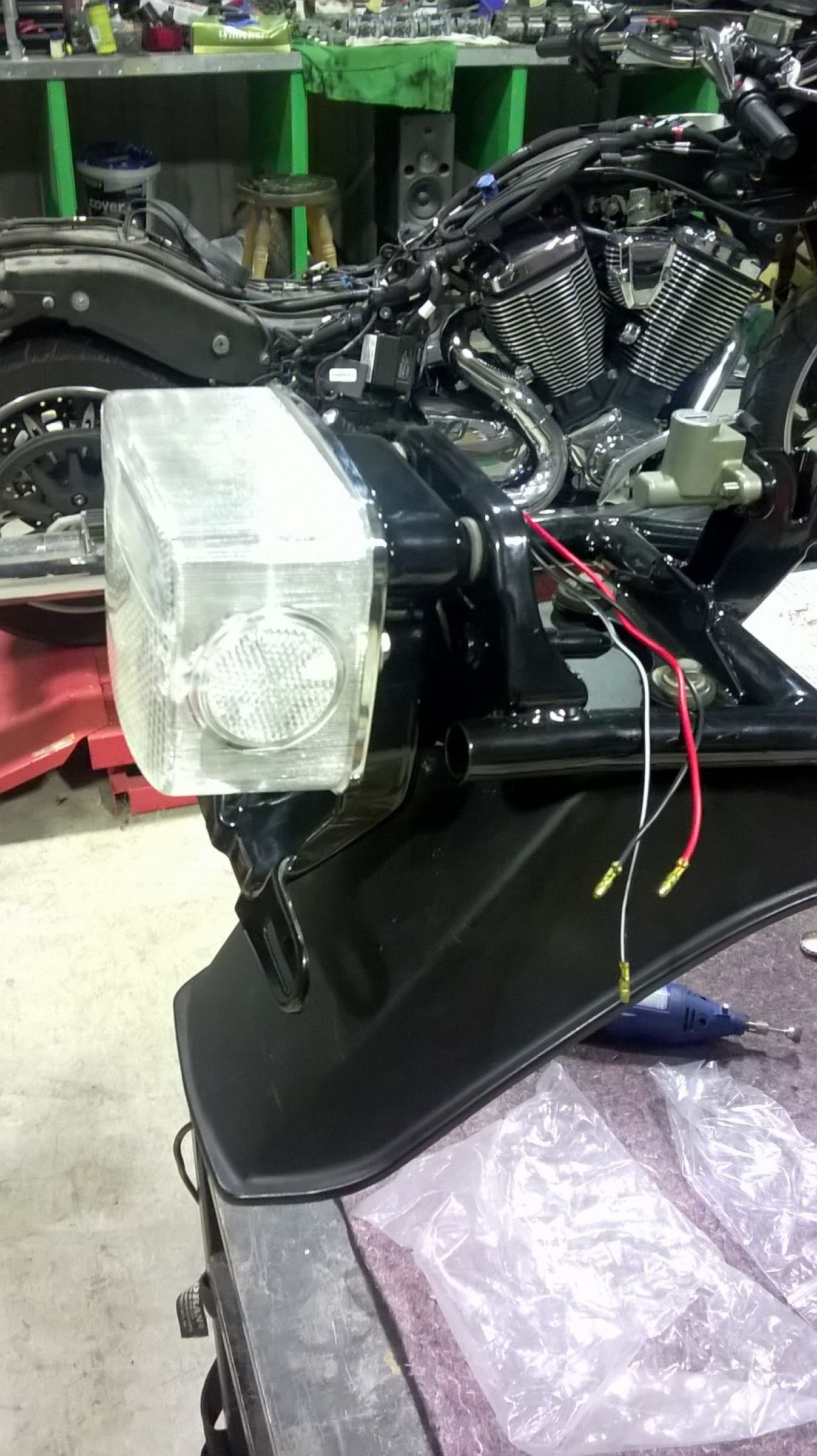

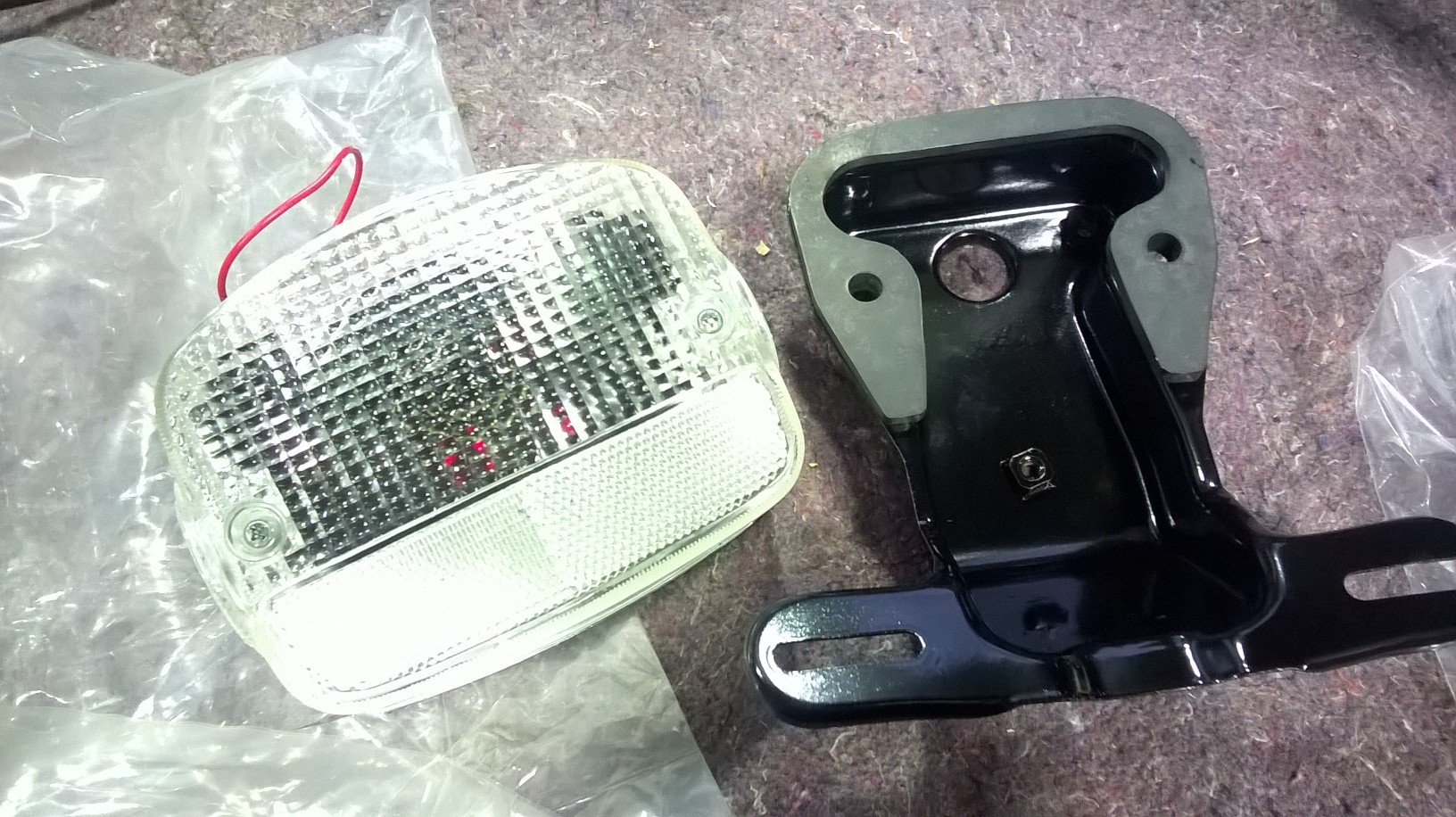

Also cracked open my clear tail light since I have a nice shiny black bracket to attach it to. Not sure if I will stay with the clear but I just couldn't help buying it. ..............
