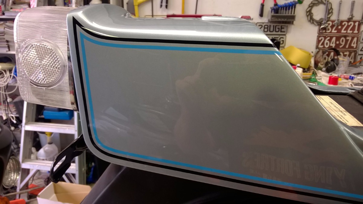

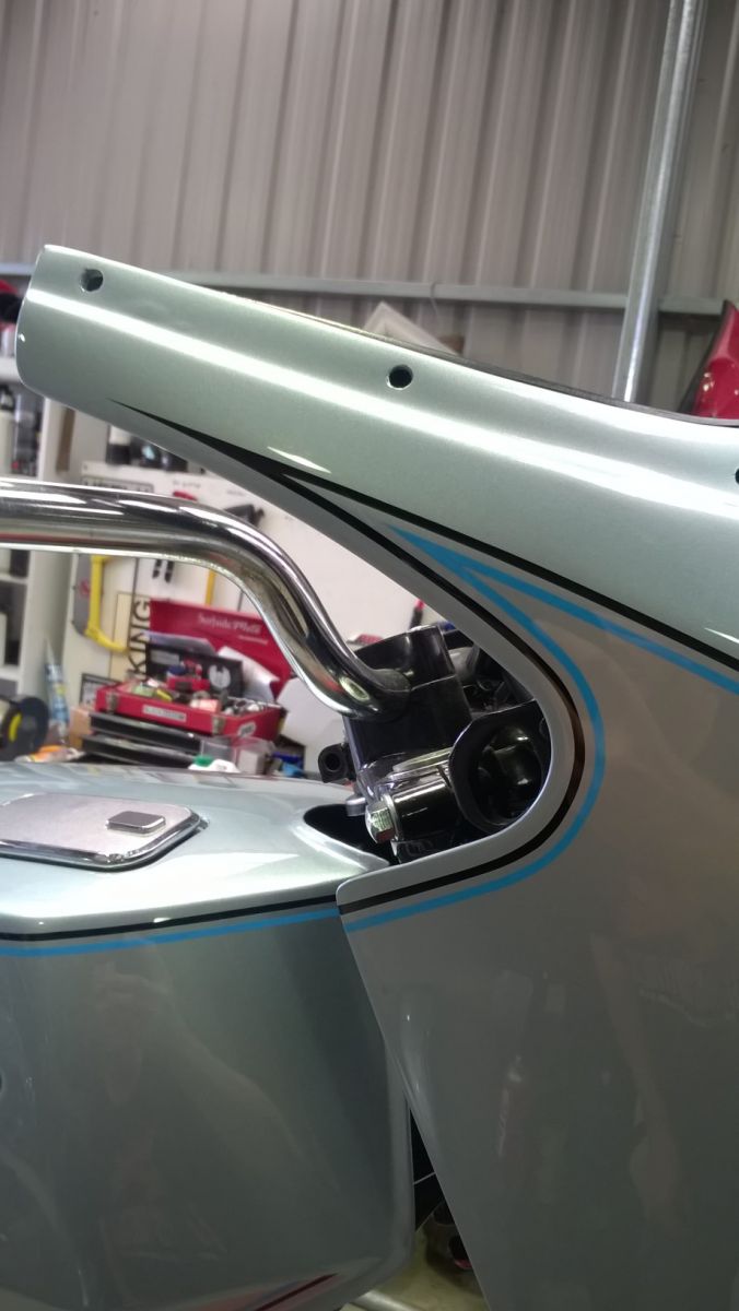

Started farting around with the bodywork now that I have it all down of the shelf and complete. PMC for the Z1R side cover badges. I had nothing to go off other than photos so just took an educated stab in the dark at positioning the badges lol.
.........and just because it was killiing me I fitted the brackets inside the fairing and fitted it just for a look.

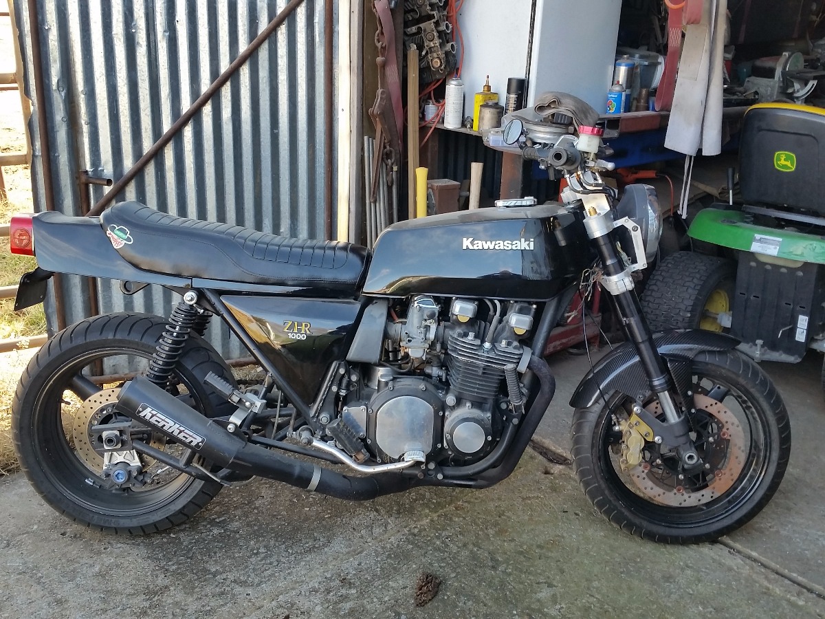

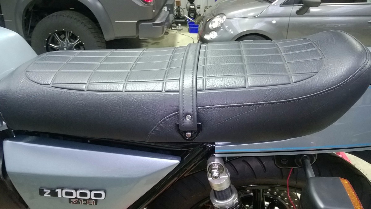

Hi all, me again. Got the seat back from the auto trimmers today. It has come out pretty good and considering the shitty base that it had to be stuck too. Only complaint would be that the front of the seat where the seat butts up to the tank has curve down rather than running straight into the tank (hope that makes sense). Pondering whether or not to take it back and get it straightened up, haven't made up my mind yet. Think I'll sleep on it. Yes, I know... the strap buckle is black! I like black lol.

i think it looks good.
but i do understand about the front of the seat.
mine kinda does that to.
i think you should go through the time and effort and sore finger tips :pinch: to fix it properly :whistle:
that way when i see it finished i'll be inspired to buy a new cover and re-do my seat
where did you source your heat stamped cover from?
- DoctoRot
- Posts: 2621
- Thanks: 784
Re: Kiwi Z1R
09 Mar 2017 09:03
I had the same issue on both the seat covers I made. The way I overcame it was to add more foam there, like way more than you think you need. That way when you pull the seat cover tight it compresses the foam to where you actually want it.

Man I love your bike! I just got the local auto trimmers to make the cover for me. That heat stamped section is just a generic lot of vinyl that they had in stock.
