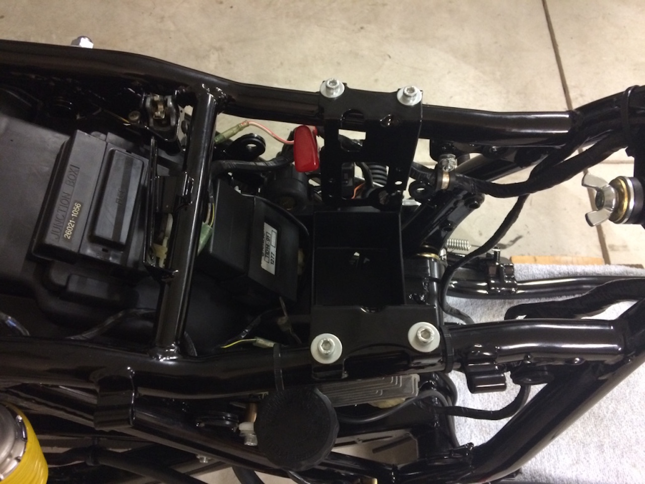

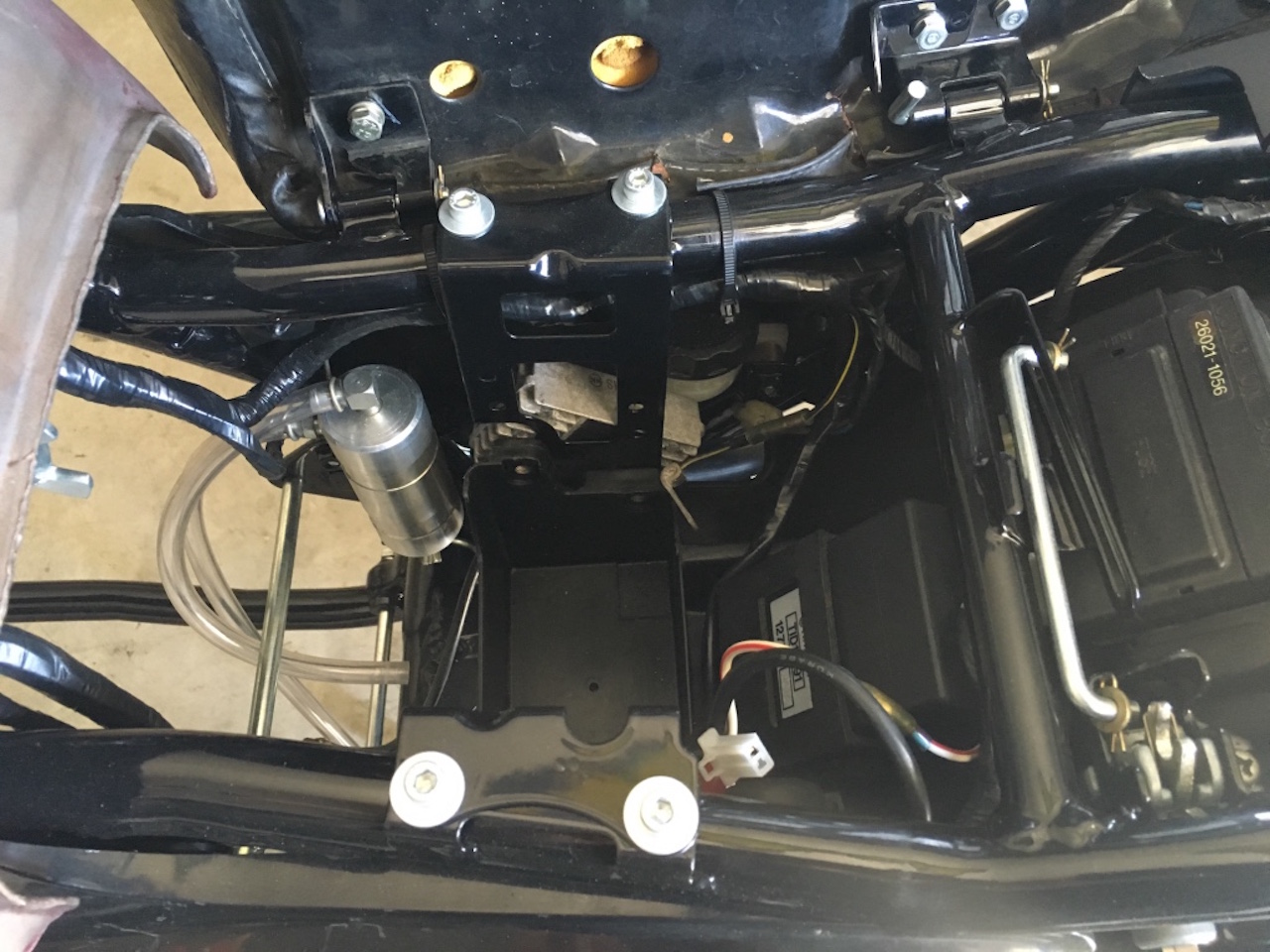

The whole electrical system on the kz750 was in kinda poor shape when I got it. The brake light blew a fuse every other time it was used and every electrical component near the battery box was corroded.
I knew I wanted to use the zr550 gauges and possibly the switch gear, so I eventually came to realize it might be easier to make the entire zr550 wiring harness fit the bike than trying to adapt the kz750 wiring to the zr550 components.
First I test fit the one-piece plastic battery box and electrical panel in the kz750 frame and it almost fit. I had to do some creative trimming of the plastic around the shock mounts and where it met the kz750 rear fender but it fit in really well. The battery box portion wasn’t braced at all, so I cut up the rusted stock battery box and used them as a cradle to support the weight of the battery
Once that was done I installed the zr550 ECU, fusebox, headlight bucket and other bits and plugged in the wiring harness to see if it was going to work.
It fit perfectly, except the front of the harness was about 6 inches to short. Fudge!

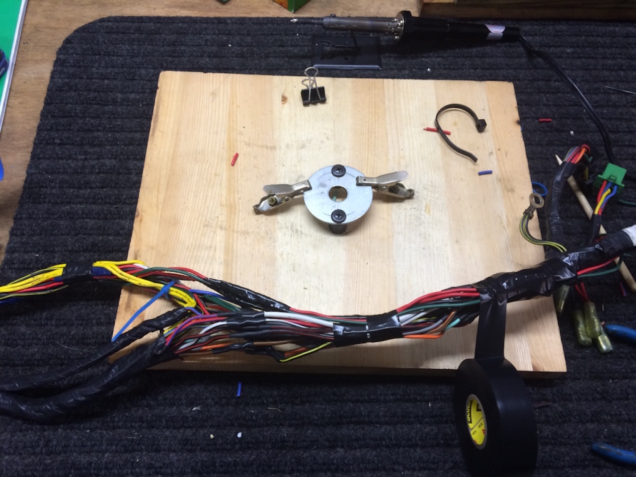

So I had a spare zr550 wiring harness that was in almost unusable condition, so I decided to cut the “good” harness in half and splice it together with a section from the “bad” one. Also the zr550 kick stand switch needed to be deleted and the oil pressure wiring needed to be moved from the “bottom” of the harness to the “top” (550 motors have the oil switch in the oil pan and the 750’s is next to the ignition pickup.)
I cut a 8” section of out of the middle of the bad harness, and then labeled the wires as to their function. I could have used generic wire, but I wanted visual continuity so there would be little risk of me splicing the wrong wires together. I then proceeded to solder and heat shrink each connection together. I rerouted the oil pressure lines through the harness, bypassed the kickstand switch and then wrapped it all back up.
I also discovered I had to change the connector on the rear brake light to match the one on the zr550 harness and that I had to use the extra long Positive battery lead from a 2001 zr-7 because the zr550 one was to short to go around my ghetto battery box support.
Once I had the entire wiring harness attached to the components on the bike, I hooked up a battery and crossed my fingers……
And it worked! The turn signals flashed, the horn honked, the brake and running lights worked, the gauge lights and idiot lights worked. The starter relay clicked when I hit the button (engine was not in the bike so no starter to test.) the only thing I couldn’t verify was the head light, as I can’t figure out how to get it to turn on without the engine running. Normally the head light remains off until the engine starts and then the headlight comes on. There is probably a way to trick the headlight into coming on, but I’m afraid of damaging something if I do it wrong.
