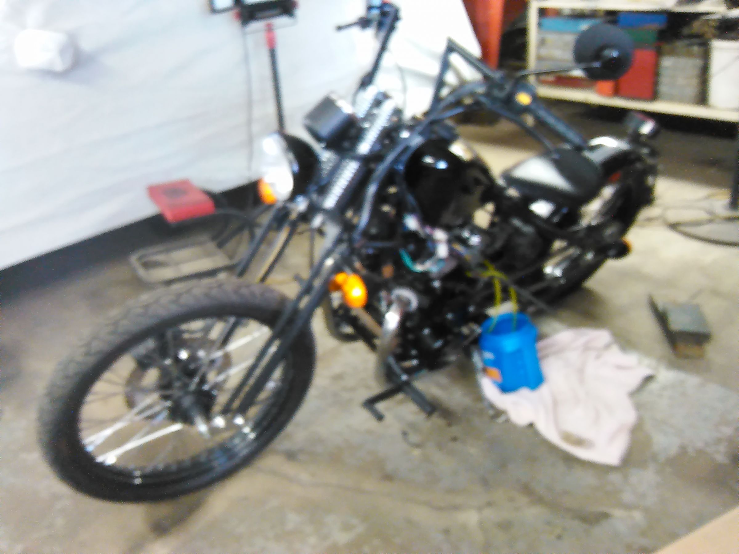

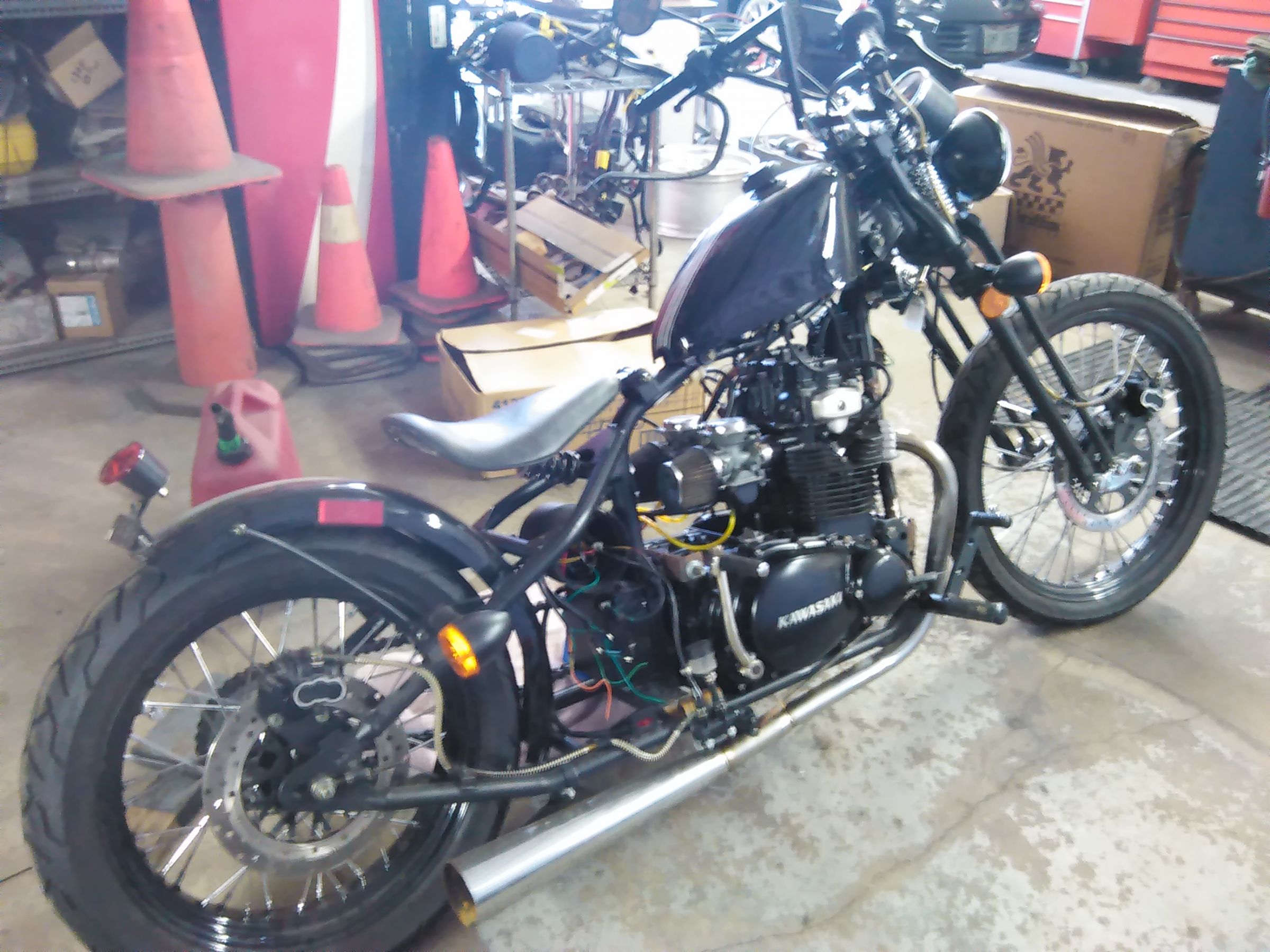

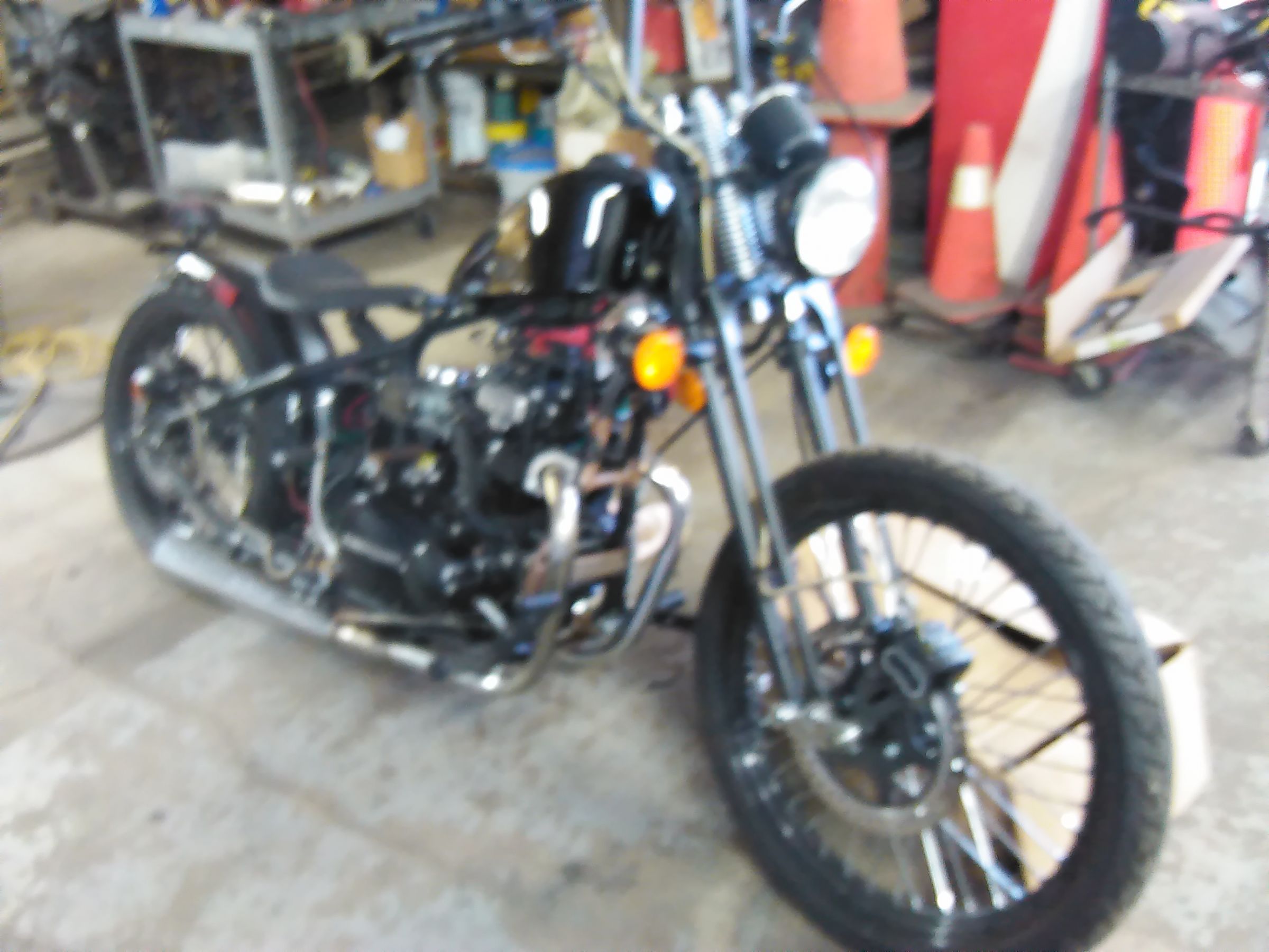

09 May 2016 11:37Yes you read that right I'm working on a Dongfang Kawasaki. The bike belongs to a friend of a friend and he asked me to help the guy by getting the wiring sorted out. What this thing turns out to be is a Chinese made chopper/bobber that originally came with a 250 cc Chinese made POS motor that lasted for all of 327 miles before it but the dust. His son decided to put a KZ400 motor in it as a replacement. I got the wiring sorted out and got it to pop on ether. I then decided to check the fuel in the tank which was stale as he'll. After draining the tank I decided to pull the carbs and check them over. Good thing I did. In addition to having green stale gas in the bowls and plugged jets there was no needles in it at all and the floats were bent to shit. Of course now that I need some decent carbs they are no where to be found at any sort of reasonable price. I thought I had the problem solved by finding a complete 440 engine with carbs in Iowa on eBay only to have the seller cancel the listing due to a local buyer. Anyhow here's what a Dongfang looks like.

That motor looks like a mix, to me. I don't know for sure, but I though the external oil lines (which are great to have) were on the newer style motors. That motor in the picture has the old-style cover over the eccentric valve adjusters. The newer style has the 4 round, threaded caps to access the screw-type valve adjusters. Also, I thought the diaphragm type carbs came with the newer style motor (four threaded caps). I would have expected piston style CV carbs on that motor.
Either way, it should all eventually be workable, but those CV's will take some time to dial in.
