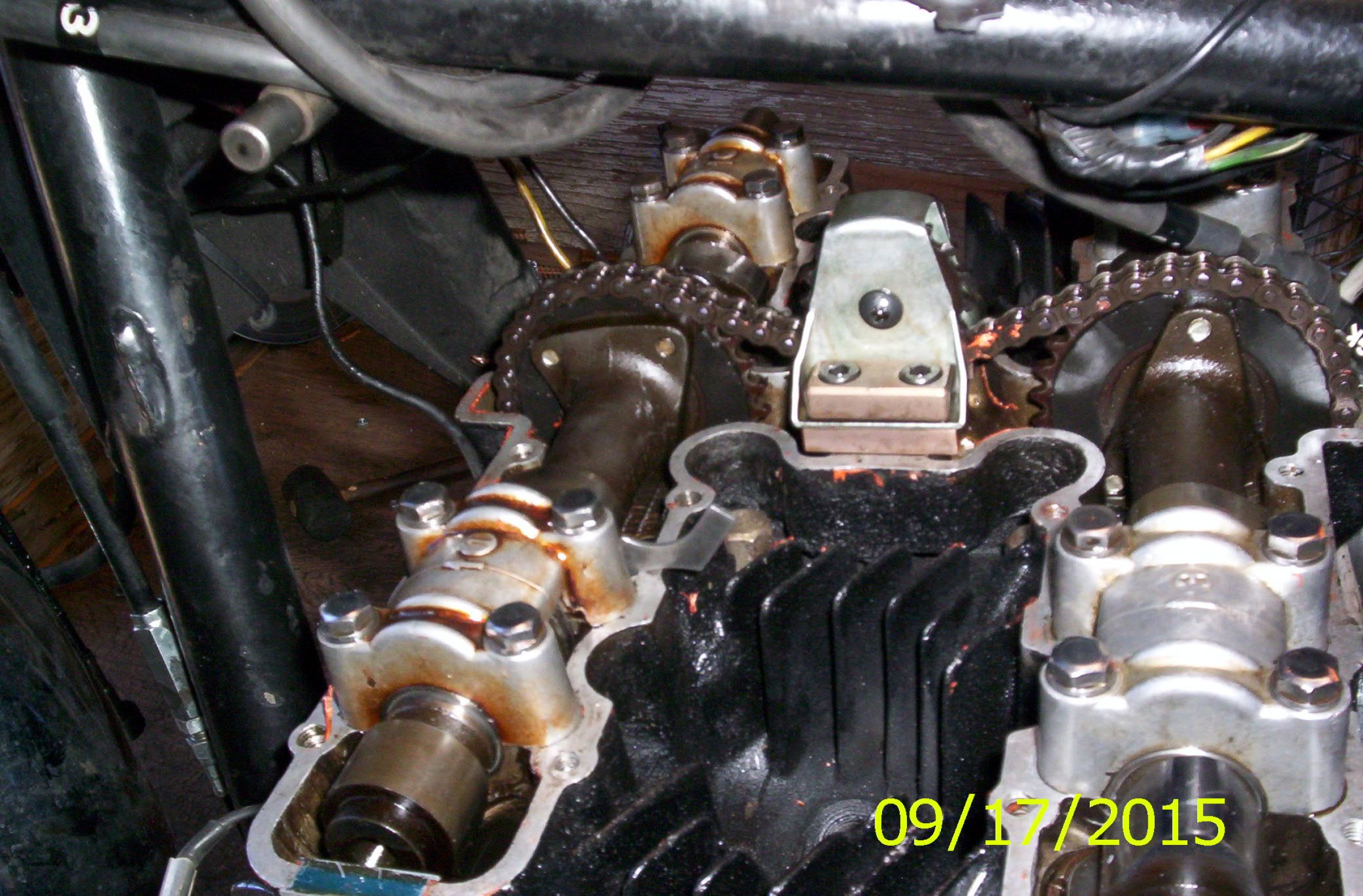

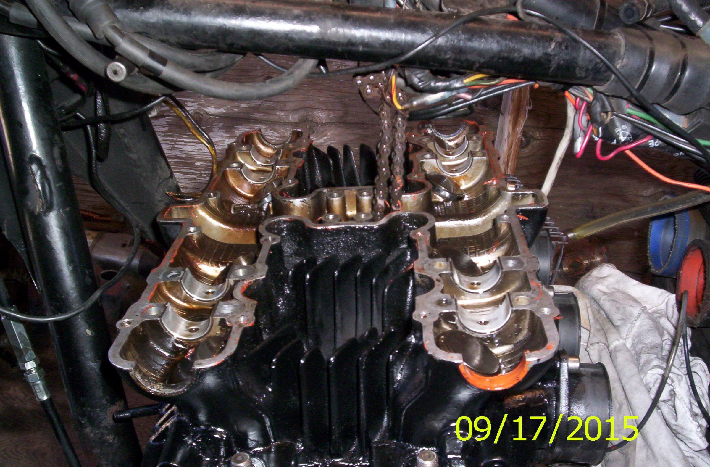

Once again I appreciate all the help I am getting. I have been trying to problem solve. So today I decided to take the cams out and was thinking I could possibly switch a few shims back and forth to get the clearances correct. For example if #1 is .002 and #4 is .006 I could change them over and maybe they would balance out to be more in the .002-.004 area...Is this a bad idea?? either way once I took out the cams I noticed that there was no scratches, scores or wear. Things looked really clean and in good condition BUT... there was oil all over the place...Have a look at the pictures and please fill me in if it is normal and if not what my next step is.
Thanks again.
Mark
The tappets seems to be tarnished but not scored.>>
Thanks again.
Mark

oil everywhere is normal.
if you can just swap the shims around that is just fine as well.
that was the way i was first taught was to average out all the shims.(before i ever seen a manual)

Looks like mine before I did my valves. The seals were hard and not sealing letting exhaust gasses into the head causing the oil to cook. It would also smoke at start up and foul plugs every 2-400 miles.

I replaced my valves and springs. It sat 15 years after a three angle valve job. The seals were junk. New Viton seals, lapped the valves and installed the springs. The valve train "sings" like it did when new.
