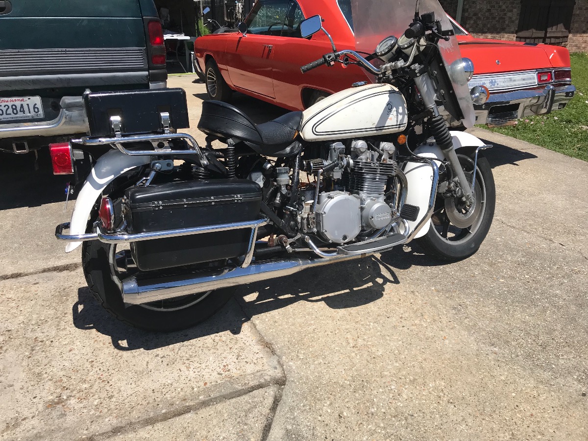

I cleaned up and sorted out some of the parts and here is where it is at now.

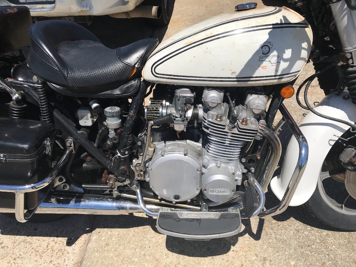

Re: 1978 KZ1000 C1 Police bike project
12 Mar 2016 07:20
I cleaned it up a bit before I mounted it in the frame. I used wire brush and alumibrite to get corrosion off and then painted with high temp paint. Going to polish outside covers for contrast. Sprocket cover is halfway there.
25 May 2017 18:50
Two weeks into riding and the motor starting making some noise. Sounded like cam chain so I picked one up on ebay and installed it. Then I drilled and tapped the end for a 6mm bolt and lock nut. Being the stock cam chain tensioner had the flat side, its own set and lock screw, I just set the tension device as called for in the book then tightened it manually according to instructions for the Ape tensioners. Set the lock bolt and two locking nuts now.
Sounds like it should now. Been a couple weeks and besides on hole still running a little rich and no rear brakes, I'm getting there.
