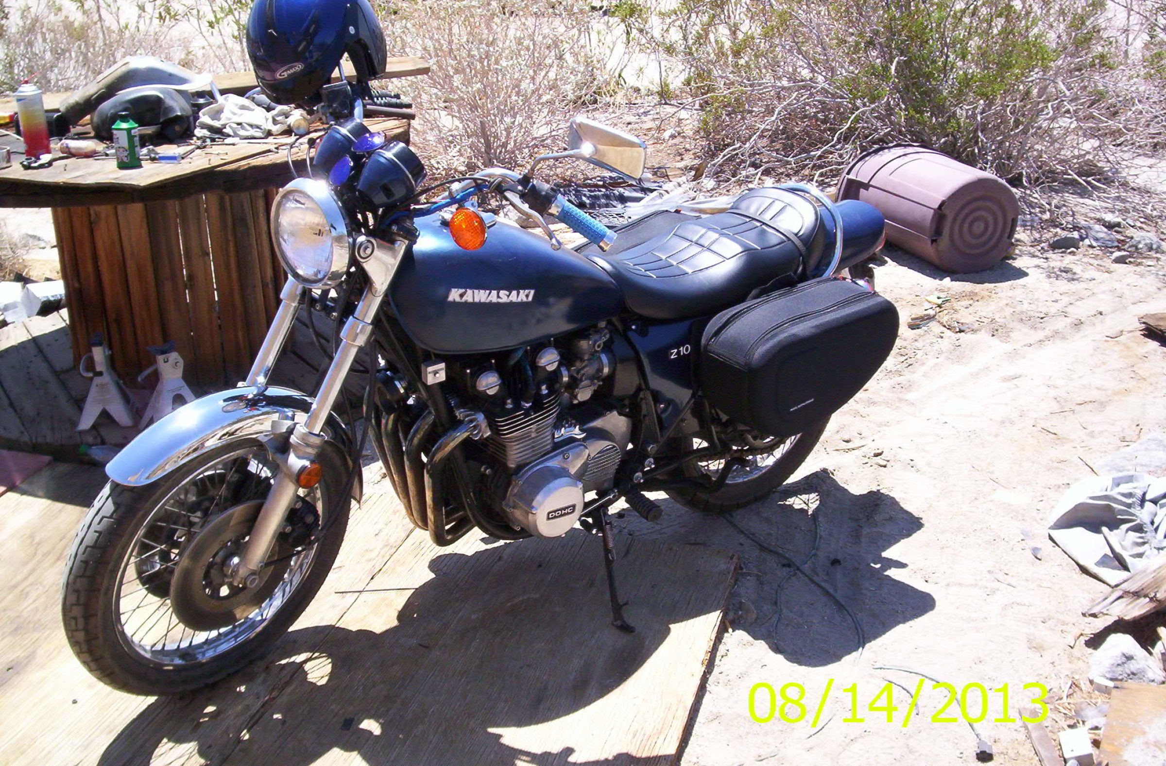

Progressive springs up front and got these for the rear.
Got a used seat for $40 delivered.
I like to take some stuff with me so I added some room.
