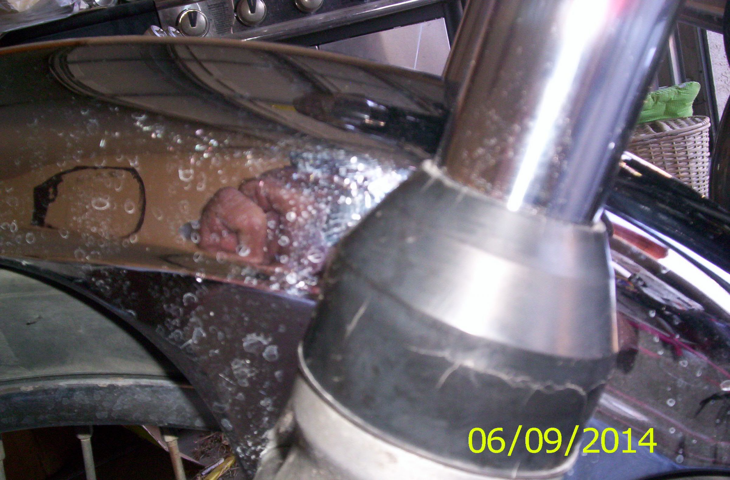

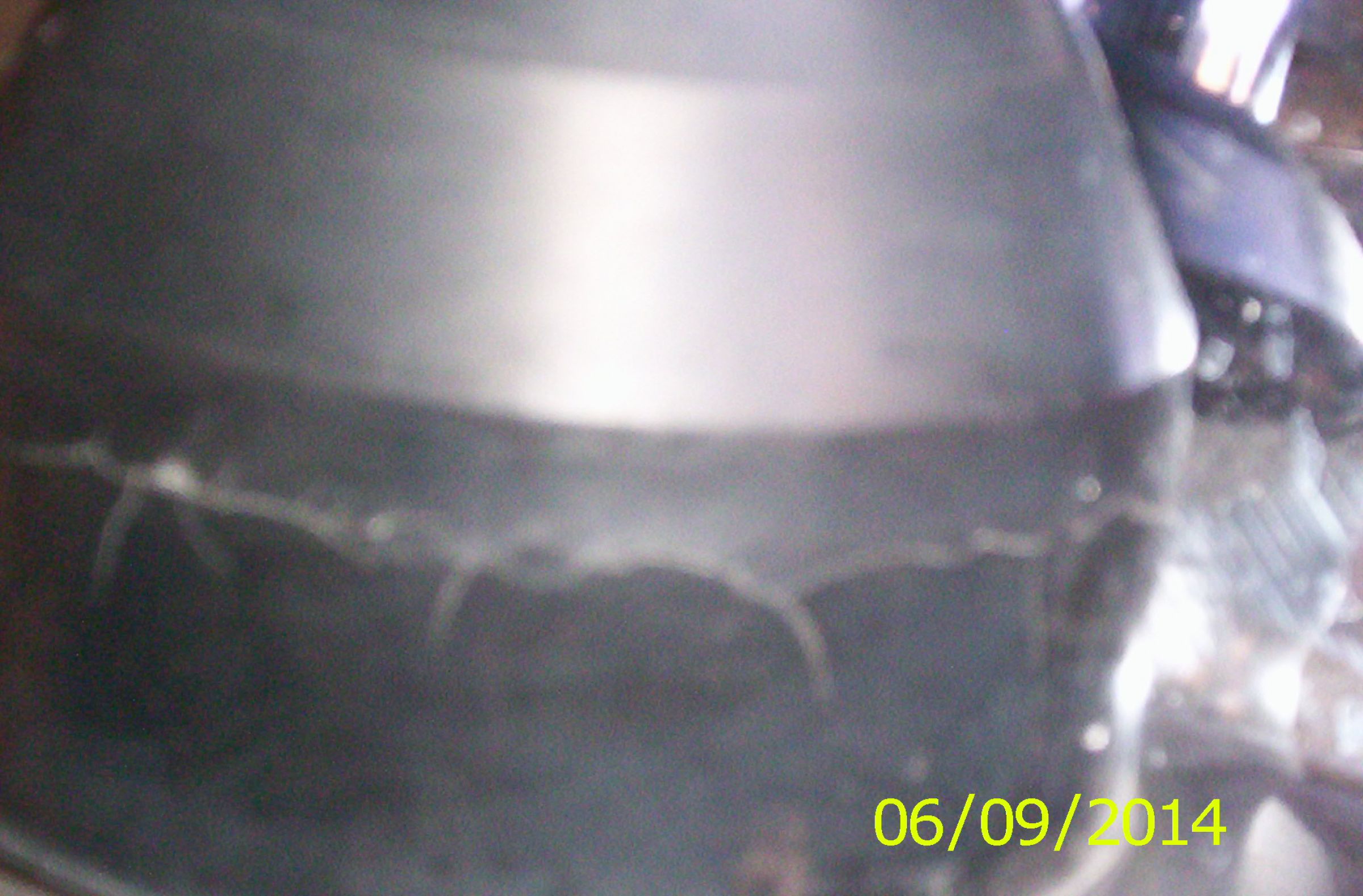

Thanks Steve appreciate the information and pics that helps! Also good to know that when it comes to the seals and caps NOS is not the right way to go simply due to age of materials there. The 15W and no air is what I had read so good to hear that you are using the same setup with good results.
