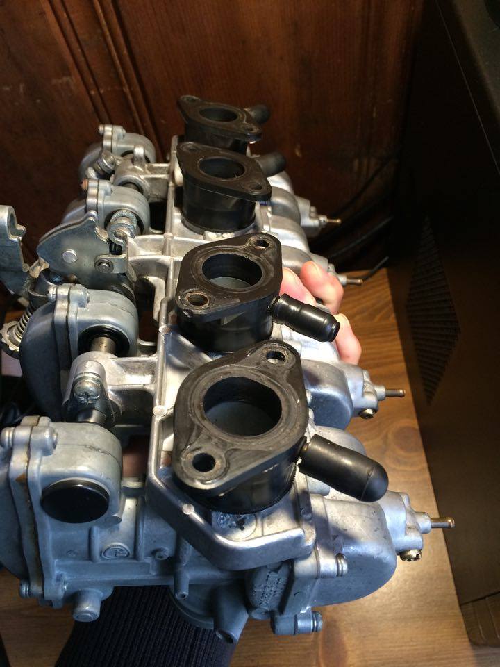

Ok, so next question.
The last owner had the vacuum line from the petcock running to one of the ports on the intakes.
I see there is a port on the furthest right carb.
That's where its actually supposed to go, yeah?

Pics?

The line had been on one of these -
But it appears that its supposed to go here -

Re: 1980 550 LTD dual sport/cafe project
30 Dec 2015 11:07
If it leads directly to the intake, you're right.
30 Dec 2015 11:38
You are correct. The petcock vac went to the #4 carb itself.
Two of the four intake ports were capped (the two inner ones, which point down), and the two outer ones went to the emissions control valve.
