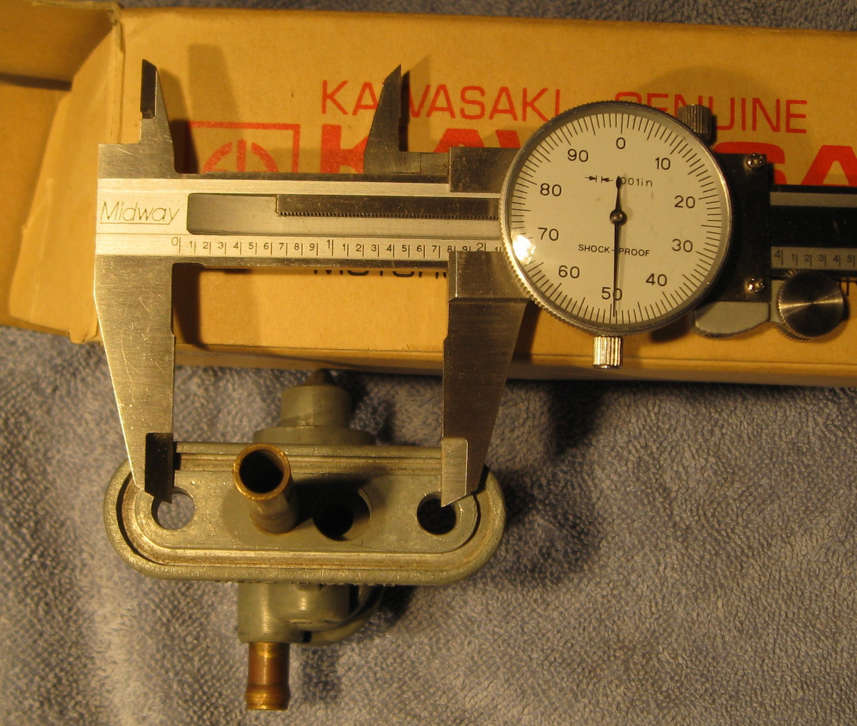

22 Mar 2016 19:23 - 22 Mar 2016 19:23rrsmsw9999 wrote: For the record Nessism was right from the get go, now what to do? It has a rebuild kit in it. I carefully cleaned it too. Even took some emery cloth to it. Will a 650 tap fit? It is a tough fit with a rearward exit fuel line. Any suggestions.
R
The image below shows the hole spacing on the 1977 KZ650 C and B model petcock. These petcocks are manual (thank goodness!) with no diaphragm or any other gadgetry in there to go bad. Ed

Pretty sure the 550 is 44mm. Dang, I did clean it out. The diaphragm is fine. The oring side was varnished and rusted when I started this process. I cleaned it again and lightly buffed it. It's holding for now, but it's a short term solution. There was some pitting on that seat area when I started cleaning it three months or so ago. I may try a thicker oring, but will have to look around. The size thicker I have is not the right ID for the stem of the diaphragm. More to come. Great little bike. R

So I am satisfied that my petcock is trashed. It was very rusted and has some pitting that is not recoverable. I ordered a replacement that has downward exits for fuel and vacuum ports which should work well. I could not fit a rear exit manual one as the fuel line hit the air box. Even with a 90 and 180 degree elbow I couldn't make it work to my liking. Carbs are back on, waiting for the mailman. I also replace drain screw orings. The inner ones were smashed and brittle. I could have had some leaking from there too.
