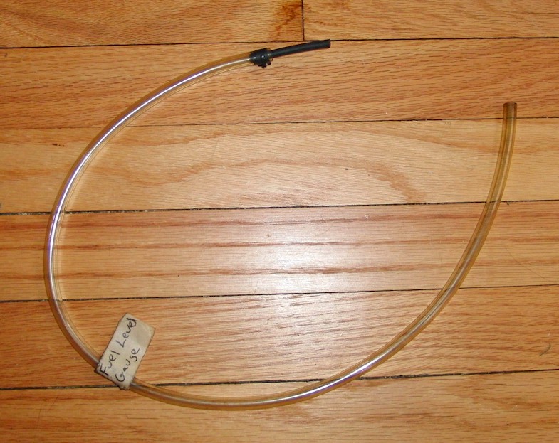

The bowls are vented all the time, so fuel can spill out of the bowl anytime, as long as there is a way out. I regularly drain the fuel out of a bowl, which then drains the fuel line and filter before I remove a tank. I get less fuel drips that way, when I remove the tank.
When I check the final fuel level, I usually do it while idling. This way there is a little vibration to make sure there is no sticking of the floats artificially giving a false level.
Your clear tube should have a 1/4" inside diameter. to prevent capillary action from affecting the reading. I just jam a short, like 2 inch long, small diameter, rubber tube into the end of a long, 1/4" ID vinyl tube. This gives the shortest possible length for bubbles to migrate through. (Air bubbles must not be in the tube as they throw the reading way off.)
EDIT: looking back, it looks like you might have the correct tube setup, but I can't tell the diameter.
The label is so it doesn't get thrown away again. :laugh:
