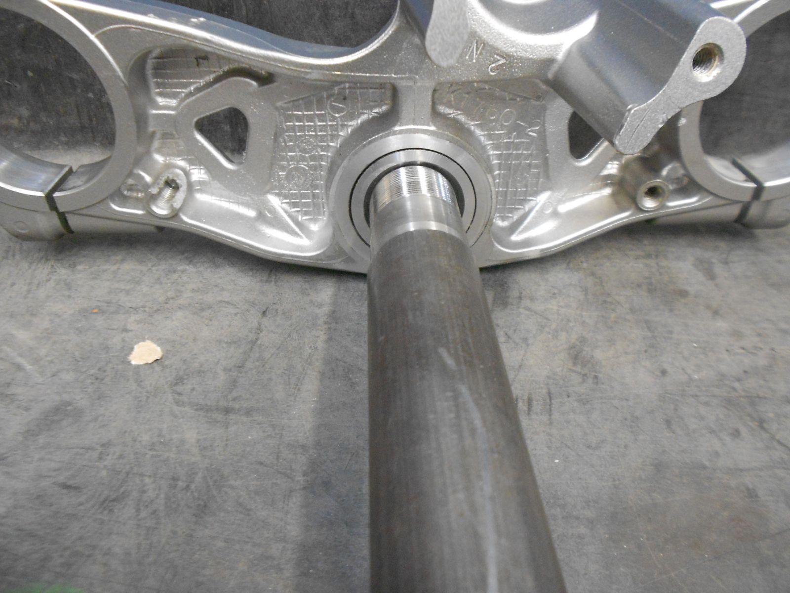

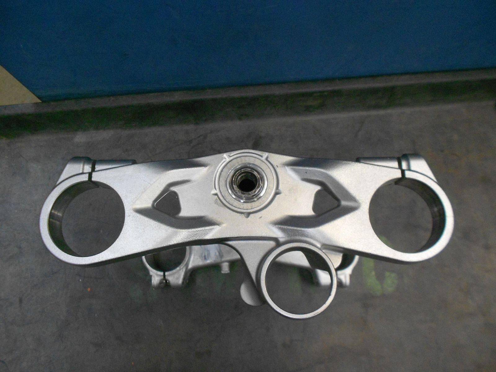

There has been progress on this. Not much, my 3 month old take a lot of my time now so i dont get quite as much shop time. I bought a hydraulic press so I could swap steering stems.

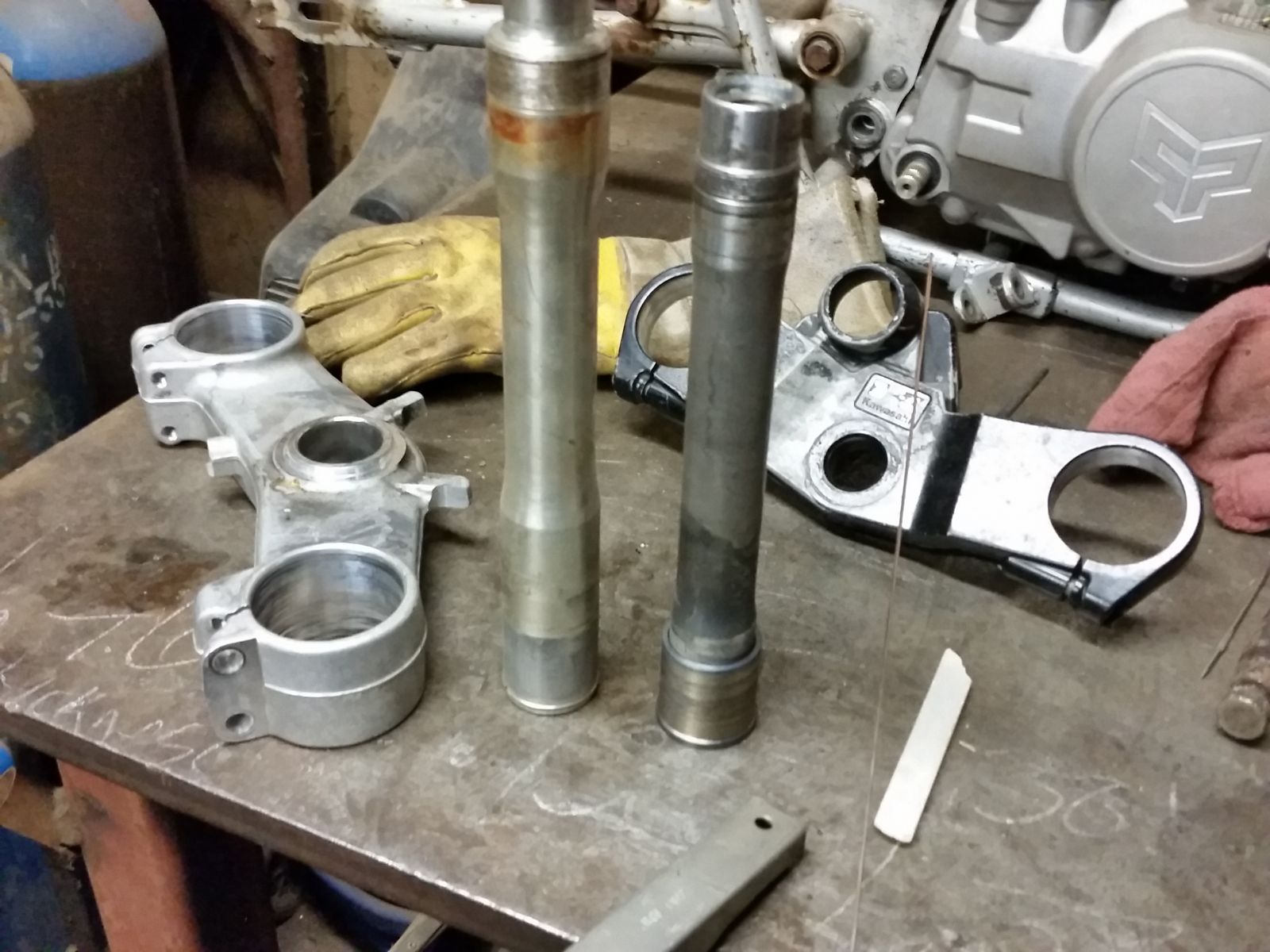

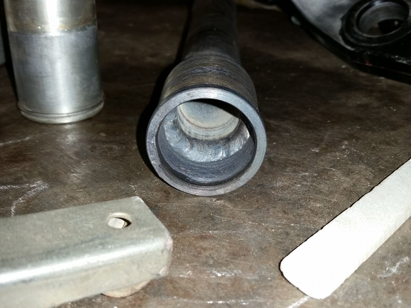

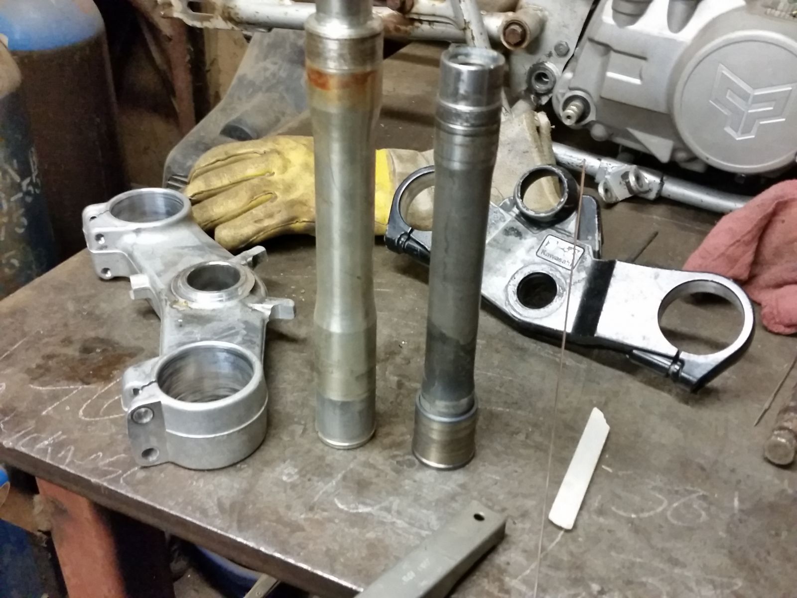

Didn't realize that the KZ stem presses out from the top instead of bottom so I bent it. Ordered a new lower triple and its on the way. The 900rr stem is 2mm bigger than the KZ stem so I am going to build up weld on it and have my buddy turn it down to the proper thickness.

i just finished a front end conversion over the weekend.
if your buddy can turn stuff might as well have him machine you out a bushing and weld it on.
although sometimes the difference is so small that welding and machining is the best bet.
either way works.just gotta add some material :evil:
sometimes i am able to machine the stem of the donor front end out to accept the kz stem thus using the donor stem to create the bushing.
sometimes i use the material from the donor stem to machine out a top bushing if need to close up the hole to fit the kz stem.
ya just gotta get in there and see what it takes to make it work.

We looked into making a bushing but it would have only been 1mm thick. We both decided it would be easier to build up weld material and then turn it down. I will have to bore out the 900rr top clamp. The top of the kz stem is the same diameter as the bottom so it won't fit through the top clamp.
