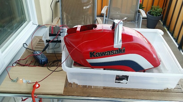

If you have limited room on your balcony and want to remain eco-friendly in rust removal of your fuel tank; why not try electrolysis?
My KZombie has a pretty nasty tank and this is the method I was going to try.
Your time will depend on your tank's rust situation but the materials investment is cheap assuming you have motorcycle battery and a battery charger or battery tender.
Here's a video demonstrating it, however, this example does not use the battery, just the battery charger. Some chargers won't work and need you to connect your battery in parallel to the tank and anode (basically charger's positive to battery (+) then to sacrificial anode and charger's negative to battery (-) then to tank steel.

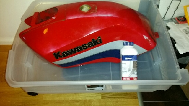

Ok @Wrenchmonkey you convinced me, I will try the Sodium Carbonate electrolysis method.
Went to the hardware store and picked up laaarge under bed storage box that the tank can sit in, so that I will not be spilling Sodium wash on the neighbor below. Sodium carbonate and a roll of iron fixing iron wire and I will be all set up to getting going tomorrow.
Isn’t an irony that when I bought the new battery the other week, I bought a new “smart” charger and tossed my old “stupid” charger in the bin. Thinking why shall I keep this! :blink:
Looking forward to see if this will cure it.
@Steve I have picked up some fuel filter, but as the petcock got jammed there I thought better trying to fix it up as I ordered a refurbish kit for the petcock. Thinking there is no use in buying new stuff and then sending a known problem in to it. :silly:
Will keep you posted.

The electrolysis method works like a charm. I rescued my XS650 tank that I was sure was a goner. Looks brand new inside.
After the electrolysis I used a rust remover (evapo rust? ) and let it soak for a day.

It really works but it took about a week until the tank was clean and of course I learned stuff on the way.
1. Duct tape is not sufficient to keep the fluid in the tank. One need to fabricate washers to cover the petcock and fuel level indicator openings with. Next time I will use an old nylon cutting board to close to openings with.
2. You need to fabricate at least two offer anodes that you can switch between. I made mine of spray can tops, 3mm iron wire that insulated with crimp tube at the top, so it didn’t short against the filler hole.
3. The shape of a ZX750A tank requires that you flip the tank upside down at the end in order to get the rust that will build up at the top as it’s practically impossible to fill the tank to 100% and whatever that is not covered with the electrolyte will rust like an Italian car.
So if you suffer from a rusted tank, this is the way to go, cheaper and faster than vinegar. Hell of a lot cheaper than phosphoric acid (but slower) and absolutely harmlessly compared with hydrochloric acid (fastest and not suitable for a balcony derusting).

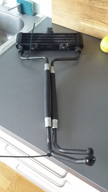

I took a gamble and took my oil cooler to the local hydraulic work shop. They were more than helpful when they heard what it was for.
The workshop guy said
- a Gpz 750! That was I was dreaming for when I was riding my 50cc moped when I was fifteen.
Then he asked for some extra time as they were running short in the shop. Not a biggi for me as there was rain in the forecast for the next couple of days.
Went back yesterday and picked the cooler up with new hoses fitted, for 403:- SEK approx. 45 USD.

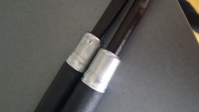

As far I can see it’s an example of good workmanship considering the welded, used once, throwaway fittings Kawasaki used on the oil lines.

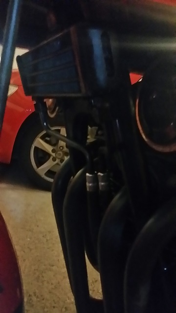

But now the cooler is back on and I can’t see any oil sweat on the hoses anymore, hard to tell about the cylinder head as the entire engine is glistering since the oil shower last Wednesday.

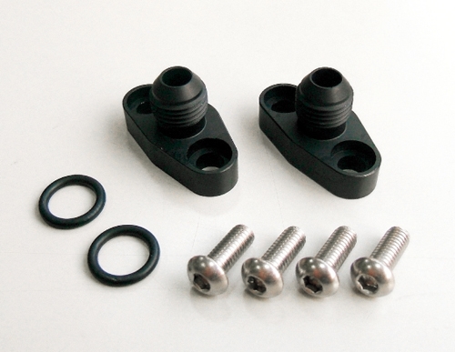

Nice going! Those hoses are NICE! I like those AN fitting adapters too!

Swapping out the oil cooler hoses stopped the worst flow, but a thorough degreasing of the cylinder head reviled that the sweating from the cylinder head is a little bit worse than just a sweat. :huh:
