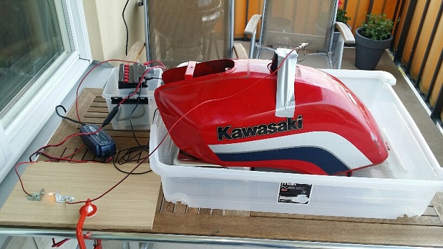

Ok @Wrenchmonkey you convinced me, I will try the Sodium Carbonate electrolysis method.
Went to the hardware store and picked up laaarge under bed storage box that the tank can sit in, so that I will not be spilling Sodium wash on the neighbor below. Sodium carbonate and a roll of iron fixing iron wire and I will be all set up to getting going tomorrow.
Isn’t an irony that when I bought the new battery the other week, I bought a new “smart” charger and tossed my old “stupid” charger in the bin. Thinking why shall I keep this! :blink:
Looking forward to see if this will cure it.
@Steve I have picked up some fuel filter, but as the petcock got jammed there I thought better trying to fix it up as I ordered a refurbish kit for the petcock. Thinking there is no use in buying new stuff and then sending a known problem in to it. :silly:
Will keep you posted.

It really works but it took about a week until the tank was clean and of course I learned stuff on the way.
1. Duct tape is not sufficient to keep the fluid in the tank. One need to fabricate washers to cover the petcock and fuel level indicator openings with. Next time I will use an old nylon cutting board to close to openings with.
2. You need to fabricate at least two offer anodes that you can switch between. I made mine of spray can tops, 3mm iron wire that insulated with crimp tube at the top, so it didn’t short against the filler hole.
3. The shape of a ZX750A tank requires that you flip the tank upside down at the end in order to get the rust that will build up at the top as it’s practically impossible to fill the tank to 100% and whatever that is not covered with the electrolyte will rust like an Italian car.
So if you suffer from a rusted tank, this is the way to go, cheaper and faster than vinegar. Hell of a lot cheaper than phosphoric acid (but slower) and absolutely harmlessly compared with hydrochloric acid (fastest and not suitable for a balcony derusting).
