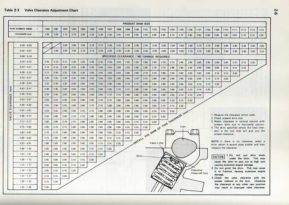

Did a valve check today. I didn't check the torque on the bolts as my nice torque I loaned out. I picked up one from harbor freight for 9 bucks...not very good. Hopefully I can exchange these shims around.
Exhaust
1. .1mm
2. .08mm
3. .18mm
4. .1mm
Intake
1. .08mm
2 .065-.07mm but not .076mm
3. .105mm
4. .105-.115mm but not .12mm
Exhaust
1. .1mm
2. .08mm
3. .18mm
4. .1mm
Intake
1. .08mm
3. .105mm

Re: 1981 750E2
05 Mar 2016 12:47
Here you go Steve! hopefully you can give me some good advice! This is my first under bucket valve/shim swap. Thanks guys! I also have pictures of the shim if that helps
Exhaust
1. .1mm Shim 2.65
2. .08mm Shim 2.0 or 2.60 or 2.80 Think it is a 0 not 6/8
3. .18mm Shim 2-30?
4. .1mm Shim 2.5
Intake
1. .08mm Shim 2.0
2 .065-.07mm but not .076mm Shim 2.5
3. .105mm Shim 2.55
4. .105-.115mm but not .12mm Shim 2.5
Exhaust
1. .1mm Shim 2.65
3. .18mm Shim 2-30?
4. .1mm Shim 2.5
Intake
1. .08mm Shim 2.0
3. .105mm Shim 2.55

Re: 1981 750E2
05 Mar 2016 14:18
I d\o it in inches. Greek to me. Some seem too much to me. I have to wonder why.
Shim table in mm.
Shim table in mm.
- DobbinsCMA
- Posts: 299
- Thanks: 13
Re: 1981 750E2
05 Mar 2016 19:55
Thanks! I saw that chart in the manual. I do need to grab my micrometer and check the shims again because it seems odd that a 2.0 shim would be there on a bike with 10000 miles. How do I grind down the valve stems?
