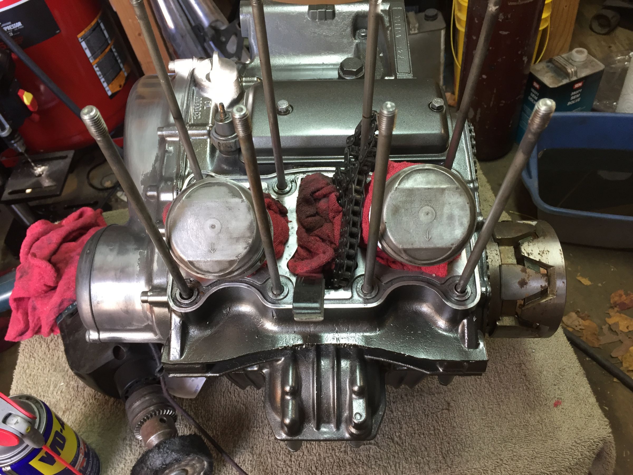

Here are a few engine pics. The bottom end is rock solid, being that it's a 3300 mile bike, but it did have the dreaded top end oil leak that was never dealt with under warranty. Actually, it was one big leak where the cylinder meets the crankcase in the front by the timing chain tensioner. The previous owner had tried to fix it with a top end rebuild but it still leaked. He also decided to paint the motor when he did it, and that didn't turn out too well either, so I had to take it all back down to bare metal and do a decent VHT paint job on everything. The bottom end is the frame and stripe color, and the top end is VHT SP127 "Universal Aluminum". The previous owner must have started the motor dry and tore the valve seals, hence the extra carbon in the combustion chambers. That's all since been cleaned up and I have NOS piston rings, viton valve seals, top end gasket kit and all new seals for the motor. While we were in there, we lapped the valves and did some mild porting and polishing for better flow.

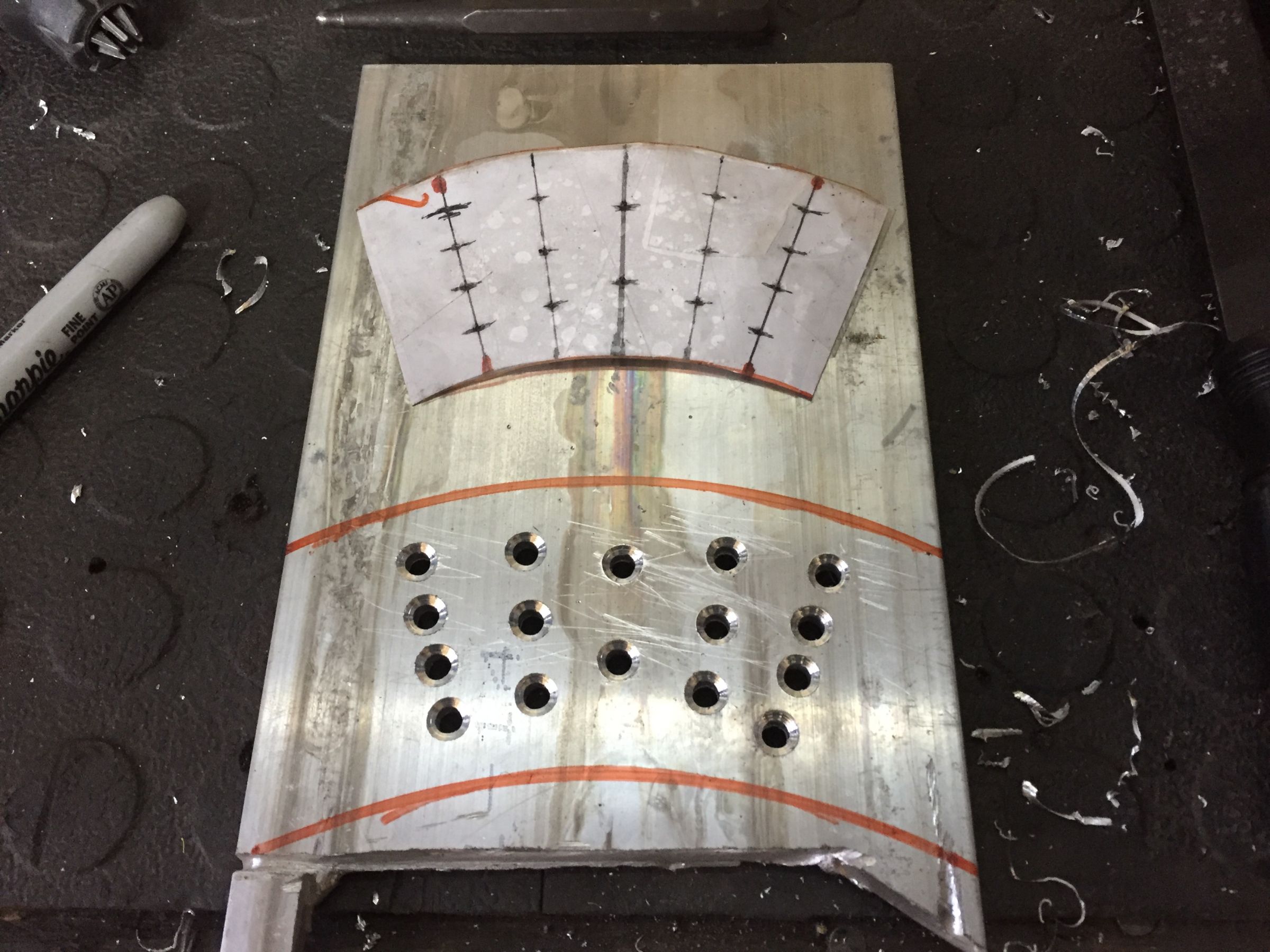

Pistons cleaned up and ready for NOS rings and a test pattern for the brake rotor.
