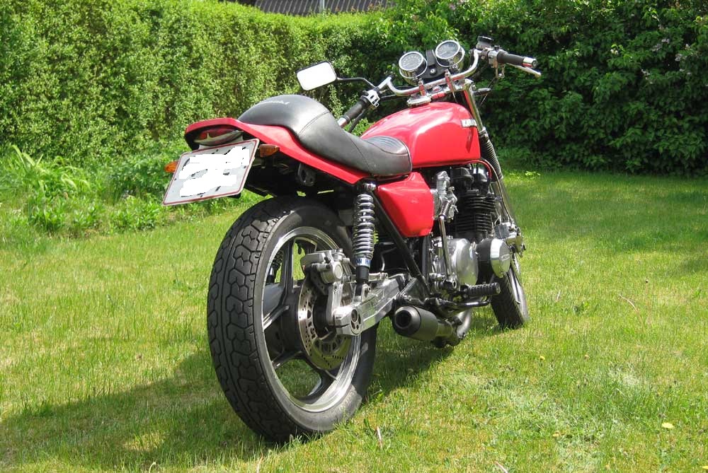

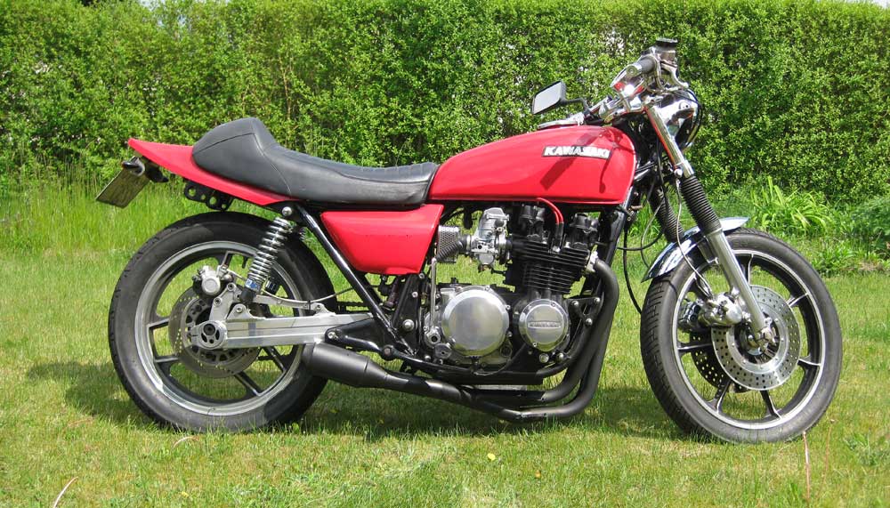

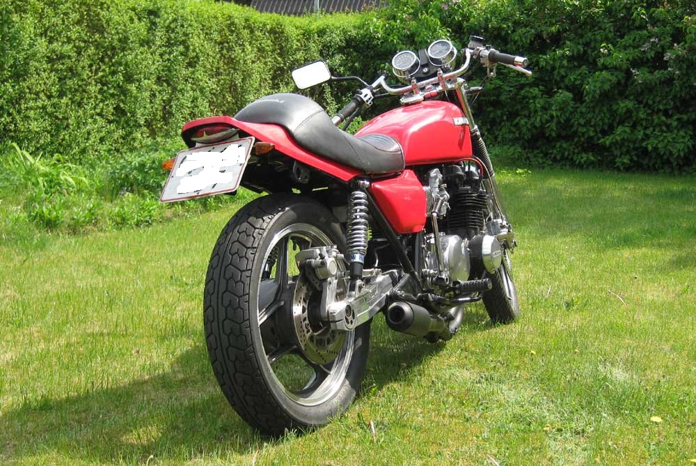

17 Sep 2015 00:23Zephyrrider wrote: ...Be interesting to hear if anyone has ever adapted a 750 swing arm to anything else Steve...
Close, I have a Zephyr arm on my 650 - it's a 550 arm though, not a 750 but as far as I know there are only minor differences between the two.
Very easy swap, had to fab a couple of spacers at the pivot and dril the frame to accept a 17 mm pivot bolt I had made, the rest was straight forward.
Also adapted a GPz900 rear wheel and brake, which wasn't hard to do either.
And to stay on topic, apart from powdercoating the frame and machining the pivot bolt and rear axle I did (and do) all work myself.
77 KZ 650 B1, 82 GPz 1100 B2.

Zephyr, the original 650 pivot bolt is 16 mm, really no way to make a spacer sleeve only 0.5 mm thick so I opted for drilling the frame. Funny thing is I bought this arm advertised as a 750, a couple of years passed before I realized it was actually off a 550, as you say the groove down the middle is the big difference, I believe dimensions between the two are pretty much the same.
With the longer wheelbase (app. 2") and the lowered rear (also about 2") the bike is solid as a rock at any speed - took it up to an indicated 180 kph/112 mph (only a couple of times, after all she's 38 years old as we speak) and never had the slightest hint of a wobble, but then my frame is braced in two spots under the tank, around the steering stem area and also between the front down tubes, obviously that'll help with stability.
Braking is much improved too - the bike originally came with a single front disc and a drum rear, I converted to dual discs up front using Z1R discs and calipers and adapted the GPz900 rear disc, caliper and master cylinder, also installed (homemade) SS braided lines all around, all in all a huge improvement.
The instruments are stock 650 items, I just put on some aftermarket chrome covers, they do look a lot like Zephyr instruments now that you mention it.
Might add that since the pics were taken I ditched the Henry Abe breadbox in favor of a stock airbox and changed the Clubmans (mounted upside down Euro style) for a set of stock looking Tommaselli handlebars.
