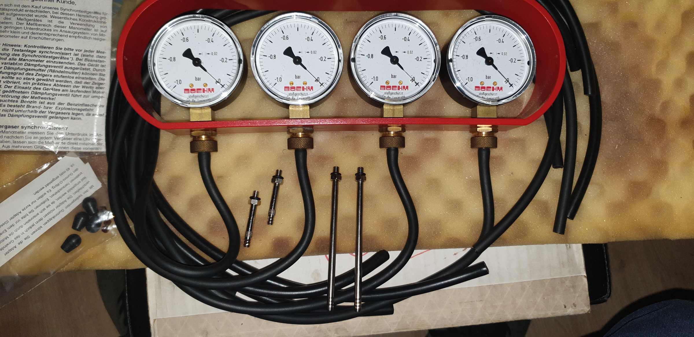

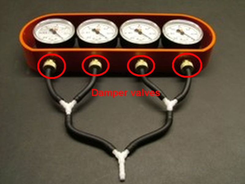

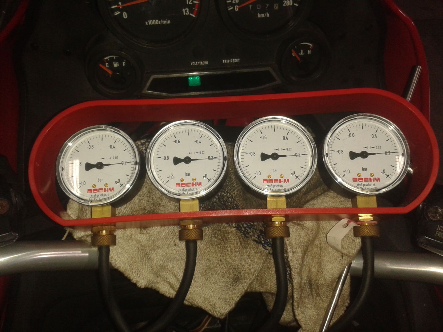

Re: 1981 KZ750 LTD four questions
08 Jul 2024 13:33 - 08 Jul 2024 13:47
The engine sounds good and need only a good carb sync.
Sounds like three cyl. pushing/pulling the one cooler cyl. in question.
Don´t use the cheap chinise carb sync gauges, they are junk without an adjustable damper valve, so you can
adjust any single gauge if needed to the same equal vaccum reference.
