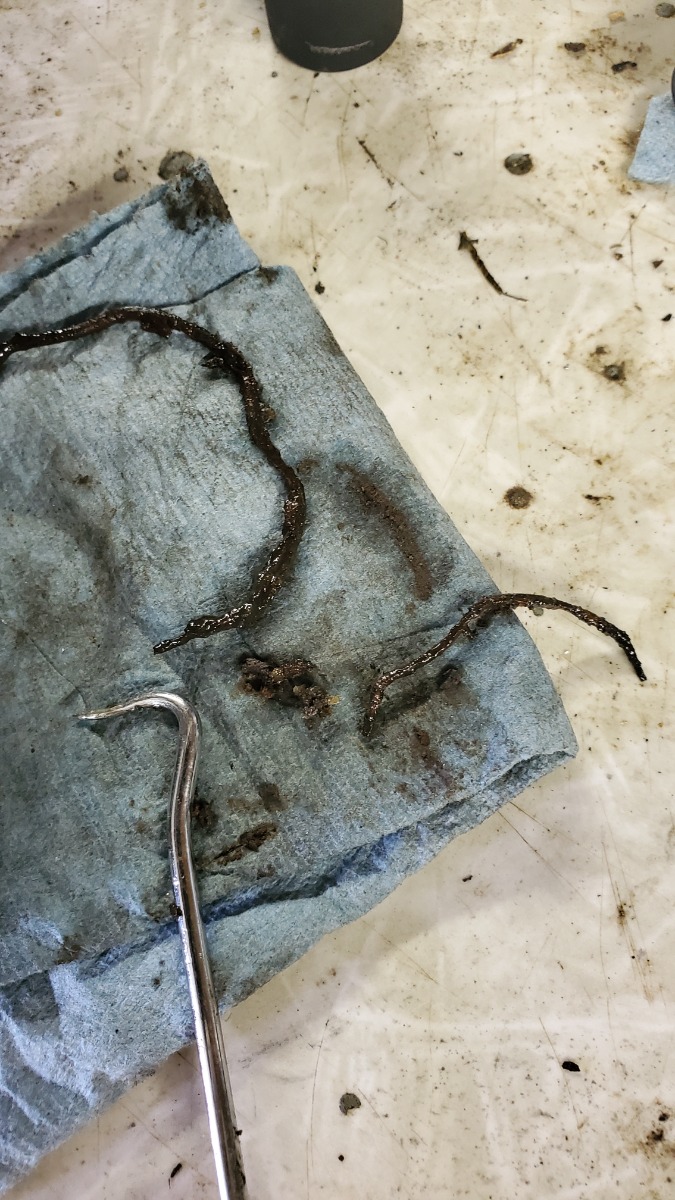

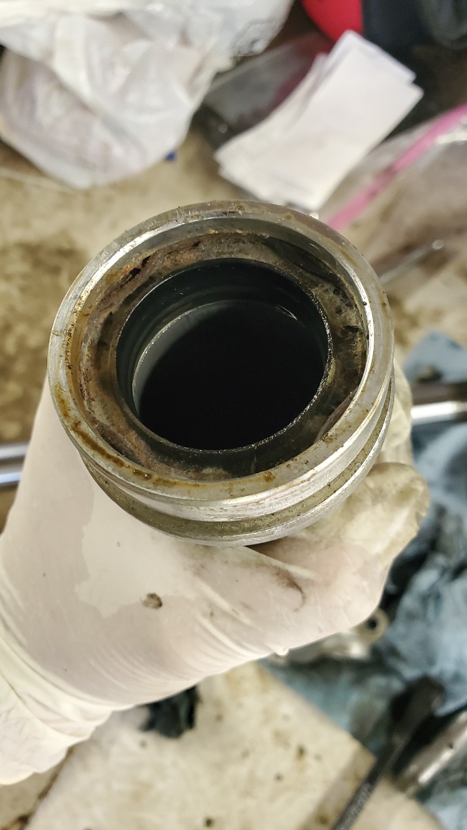

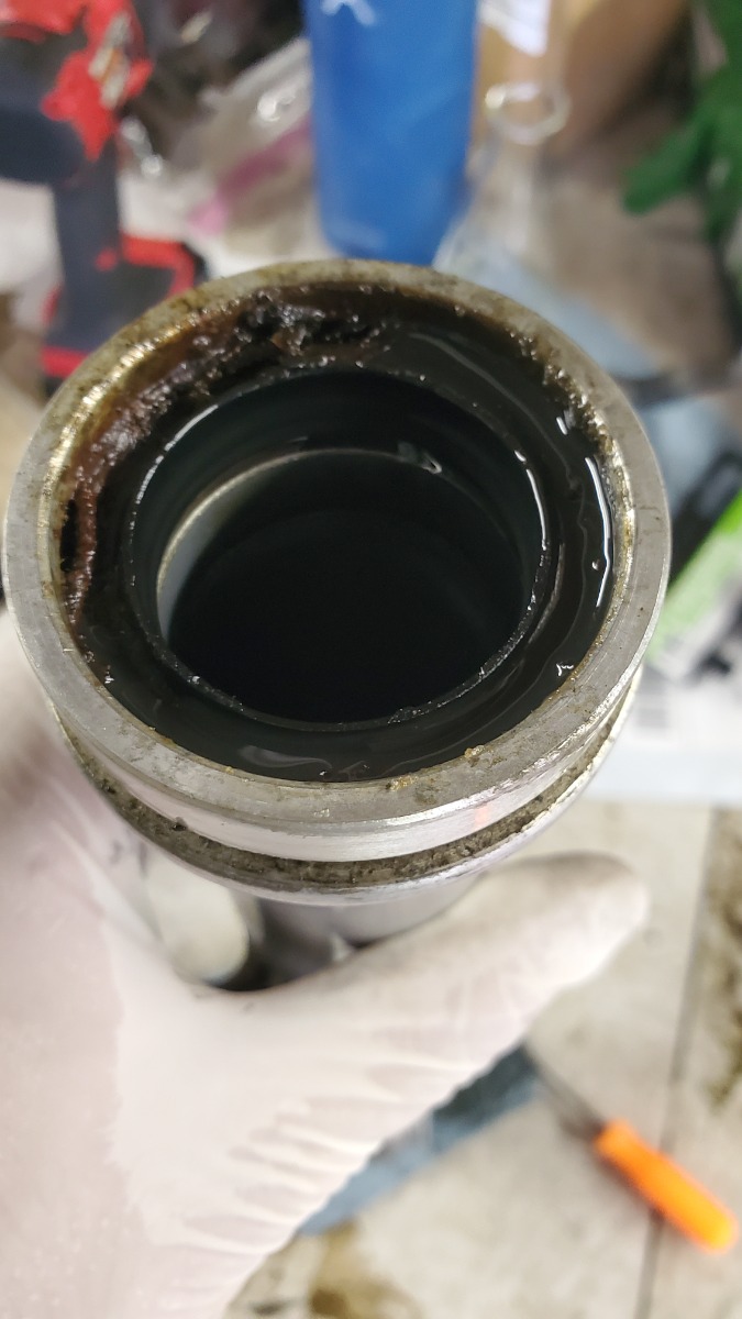

Went to change the fork oil and seals because who knows when it was done last... Photos of the old seals and retainers attached. Yikes.
In my disassembly, there was a part that seemed to be missing but the parts diagram is somewhat unclear. In the service manual it is called the piston ring, and resembles a washer, but in the OEM parts diagram it is part of the piston/cylinder unit. Neither fork had such a ring but each did in fact have a small black ring that fit into the groove at the top of the piston/cylinder.... Are they the same thing?

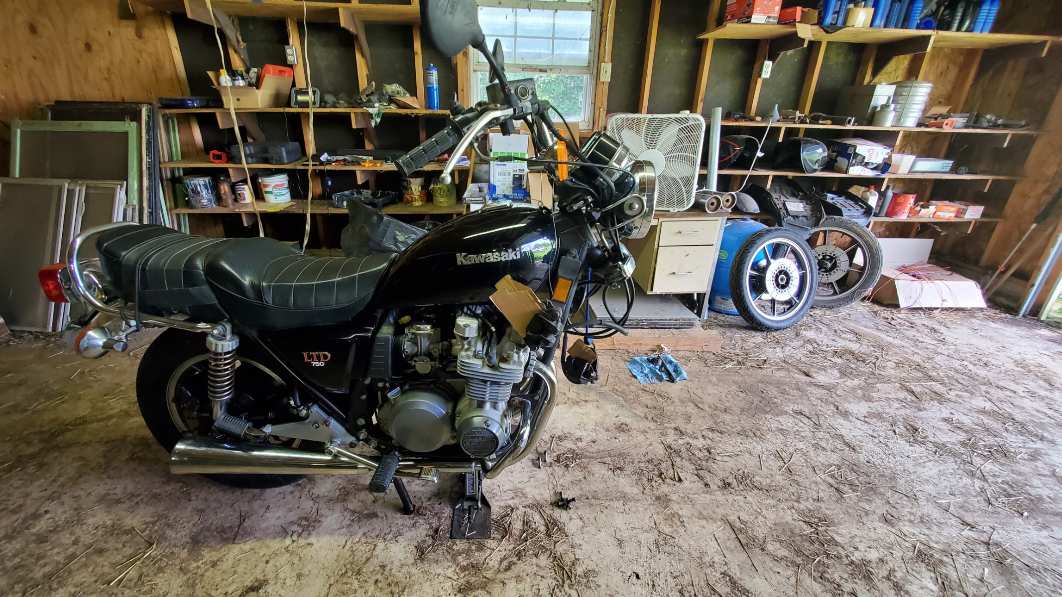

Almost ten years later, and this thing is still kicking. Two weeks ago, I had my first crash and I was fortunate enough to miss all the boulders on the side of the road and more or less walked away with a lot of severe bruising. The bike definitely took the brunt of it, but all things considered we're looking at mostly cosmetic damage to the bike, but of course it's all the expensive bits like the exhaust, tank, and instrument housings. That being said, I've managed to find another, this time a 1980 KZ750 that's been sitting outside for who knows how long and while some things are roached (seat, tank, mirrors) the bike is in surprisingly overall good condition and with only 7k on the clock and oil in the engine still, it turns freely!
So I'm at an impasse - I can use it as intended as a parts bike to fix "my" bike with 26k on it that I love dearly, or I can swap good parts from my bike to this new project. But that's for mulling over some more later perhaps with a few fingers of bourbon and a campfire. For now, I just want to get back on the road.
That said, looking at part numbers and diagrams most everything should swap fine, but I noticed the gauges on the parts bike are slightly different in terms of what indicator lights are on which pod, as well as the addition of a voltage meter on the tach side of the 1980 not present on my 1981. I know the mechanical tach and speedo will be fine, but am I correct in guessing getting the electronics to work will just be a matter of matching the correct wires to the correct pod? What about that voltage meter?
The other curiosity was the swingarm on my 1981 has no grease fitting which I always thought was odd - the swingarm on the 1980 DOES have one and I was considering swapping them. Is there a reason it was deleted on the 1981 that anyone knows of?
Probably cost. 1 less part. 1 less step in the mfg process drilling/tapping the hole. 1 less step in the labor process.
possibly because most riders who have it ignore the thing. ha ha.

As mentioned, they probably deleted it for cost savings. My 81 1000 LTD didn't come with one either. When I did a frame up resto on it several years ago I saw how bad the swingarm was and installed a zerk fitting in it myself.

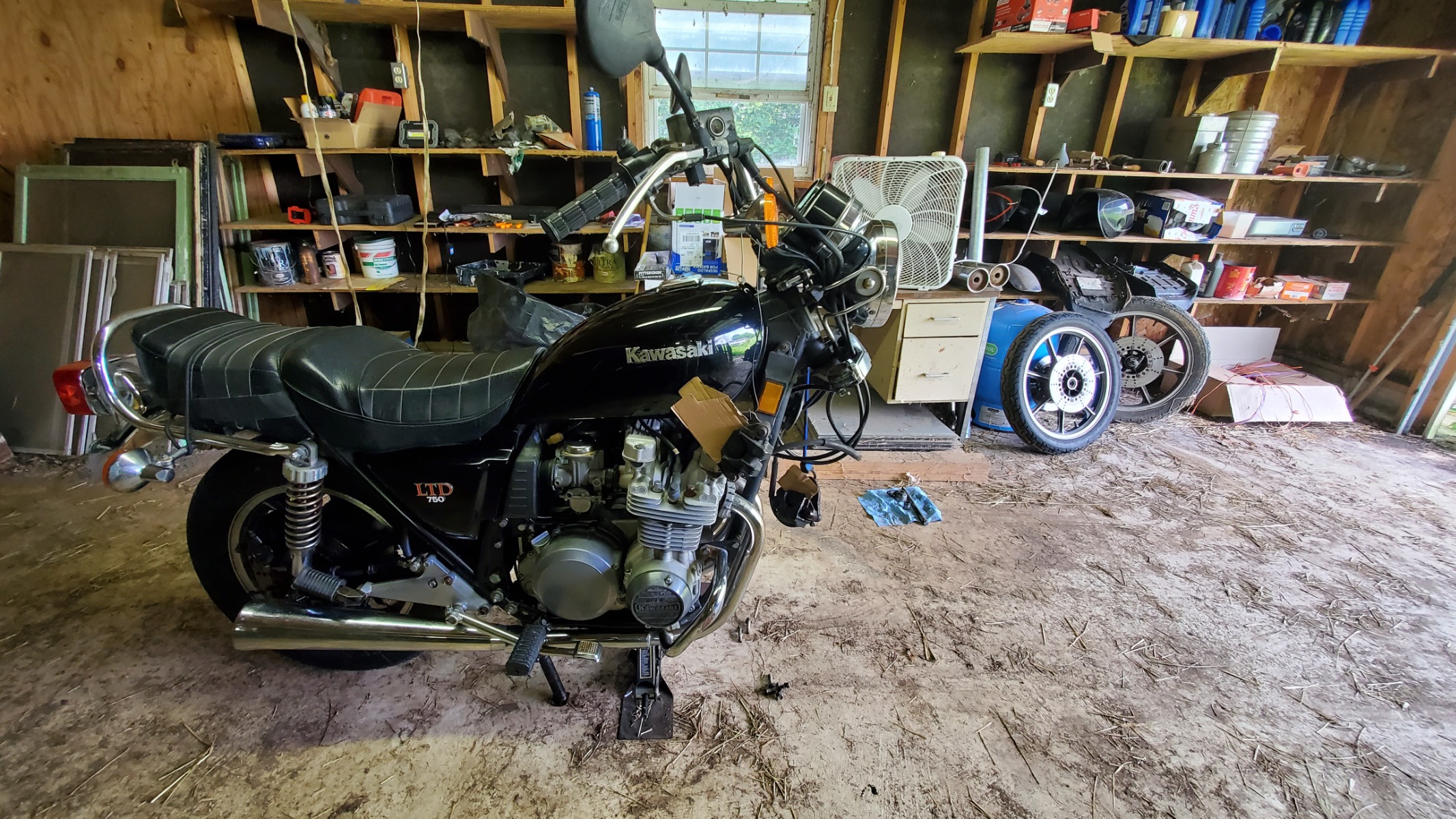

Update - bike is 95% back together after frankensteining a couple of turn signals together from crashed parts and parts off the parts 440. Different internals on them much to my chagrin. Did bearings front and rear last weekend, new tires, lubed everything, chain aligned and slacked, new gear ordered... went for a very quick half mile ride for a preliminary shakedown aaaaaand Carb issues. Starts great, runs at idle with half to full choke and once it starts to warm and I start to let the choke off, surges to 4-5k until I touch the throttle (dies) or choke it back up (returns to normal idle). Pulled the carbs and went through them again, crap in the bowls and all around the bowl gaskets. Replaced all four float needles, gaskets and main jets because I had them all on hand, pulled the slides while I was at it and discovered 3 pinholes in #1... pulled a donor from the parts 750 I picked up to fix this after the crash and cleaned it up. Cleaned everything up real nice and blew dry with the compressor (slides and floats out, per FSM)  Got everything back together, just waiting on some clear fuel line and a filter, because I've learned and said it enough times "Next time, I'm putting a filter in line!"
Hopefully that's all for the summer other than an oil change and regular maintenance items! Bike at least went down the road in a straight line on the half mile shakedown! Can't wait to get back out but definitely not rushing anything. Want it all to be 100%
