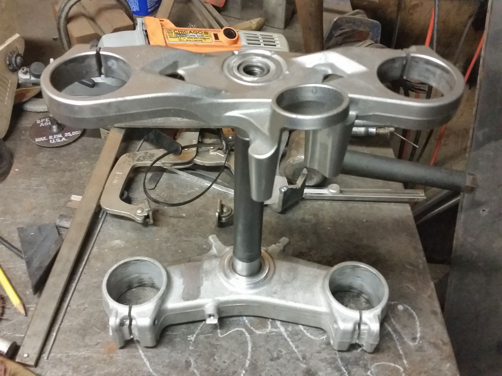

It was originally a shaft drive bike, but I'm converting it to chain drive. I've also got 05-06 ZX6R Forks, Triple Clamps, and Wheels, and an 03-04 ZX6R swingarm. I've been working with Leon on getting a pivot shaft and bushings/spacers made, as well as getting the steering stem swapped out for the new triple and forks.
