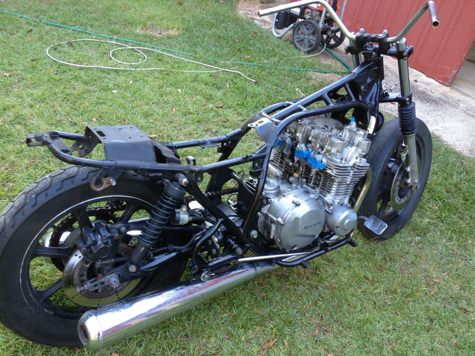

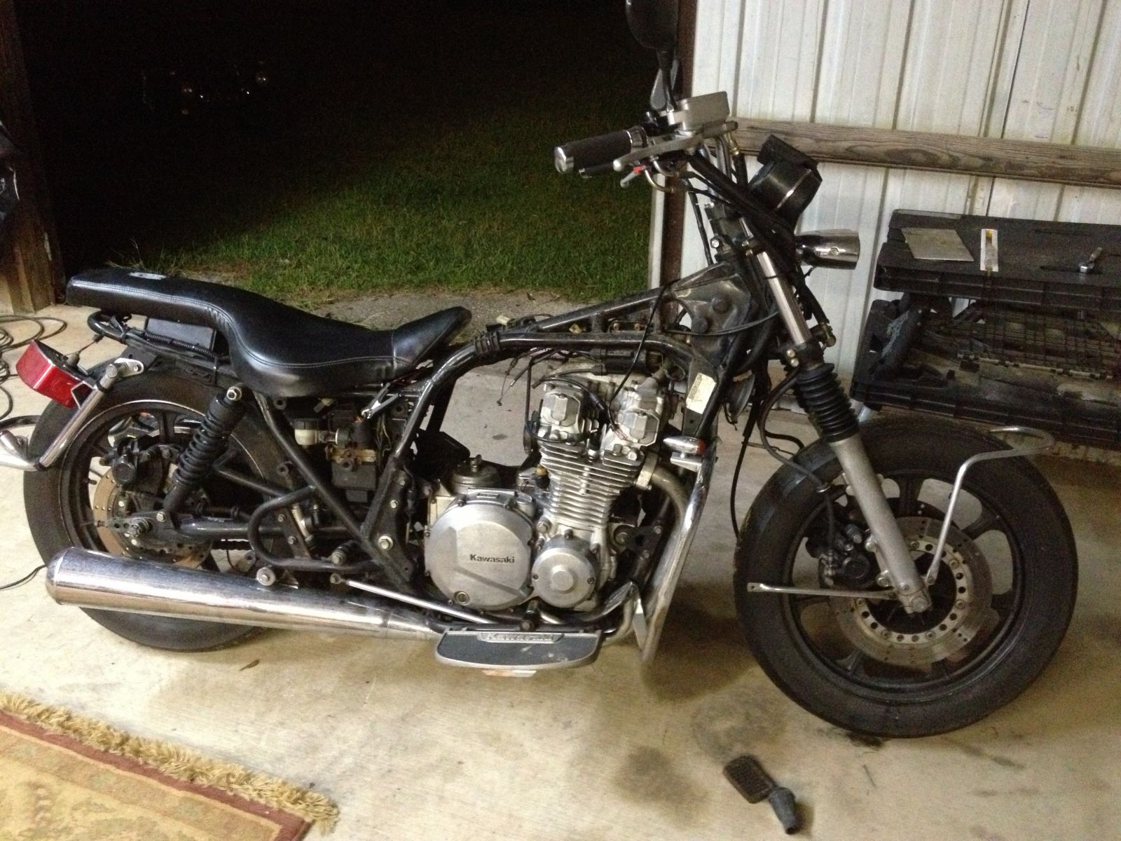

Thought I would post on my 86 KZ100P build I am in the process of building. Found this poor abused girl hiding in a shabby barn, was tortured by its PO, wiring chopped, nasty stuff all over it. We was willing to part ways for a few hundred so I dug her out and had to drag it 150 yards to my truck to bring it home, he had a pit bull who liked to use it for a chew toy. I let him keep the fairing and boxes they were cracked and beat but he felt they were worth a grand. Here she is after undressing the tank and other nasty pieces.
After clean off the odometer I found she had just over 37,000 on the clock, odometer works so I trust it is original, title for it shows 34, 828. The bike had been sitting up since 1995. Hooked up a battery and got her to crank over compression was averaging 115 between all cylinders so that was a good sign.

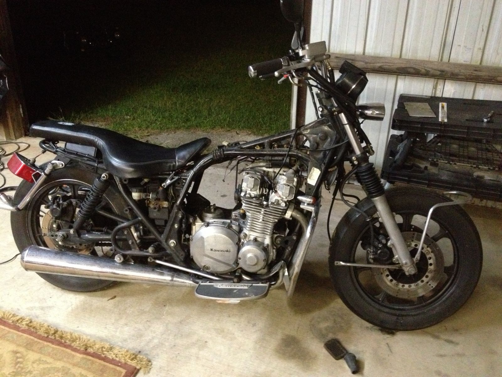

Thanks Davido, I have looked over that build, and many more, I am taking this one into a different direction. I plan to build the rear tail section out of metal and rivets, my background is military aviation, H-60 Blackhawks. I do love metal fabrication. Here are a few more pics of the teardown. Everything looks so much better in pictures, seeing it in person and you notice all the rust grime and crap

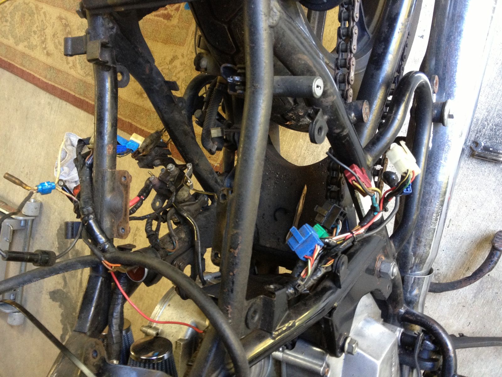

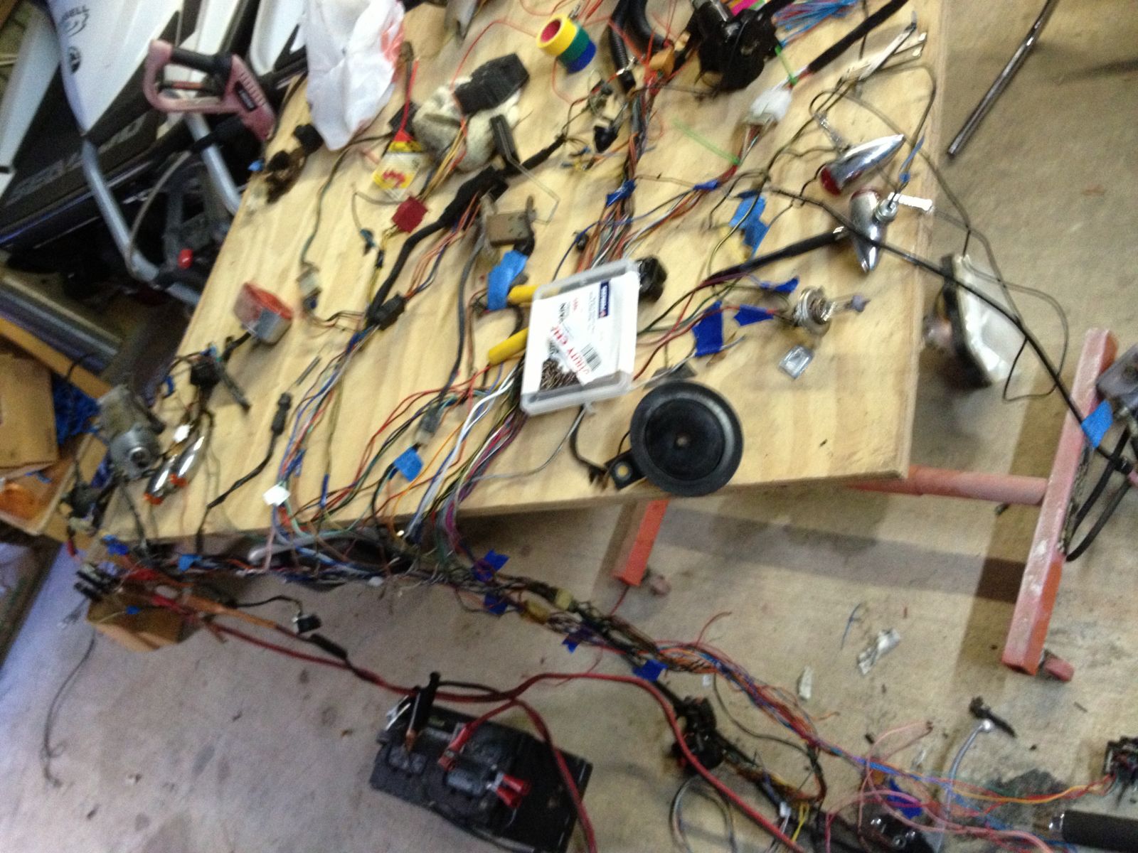

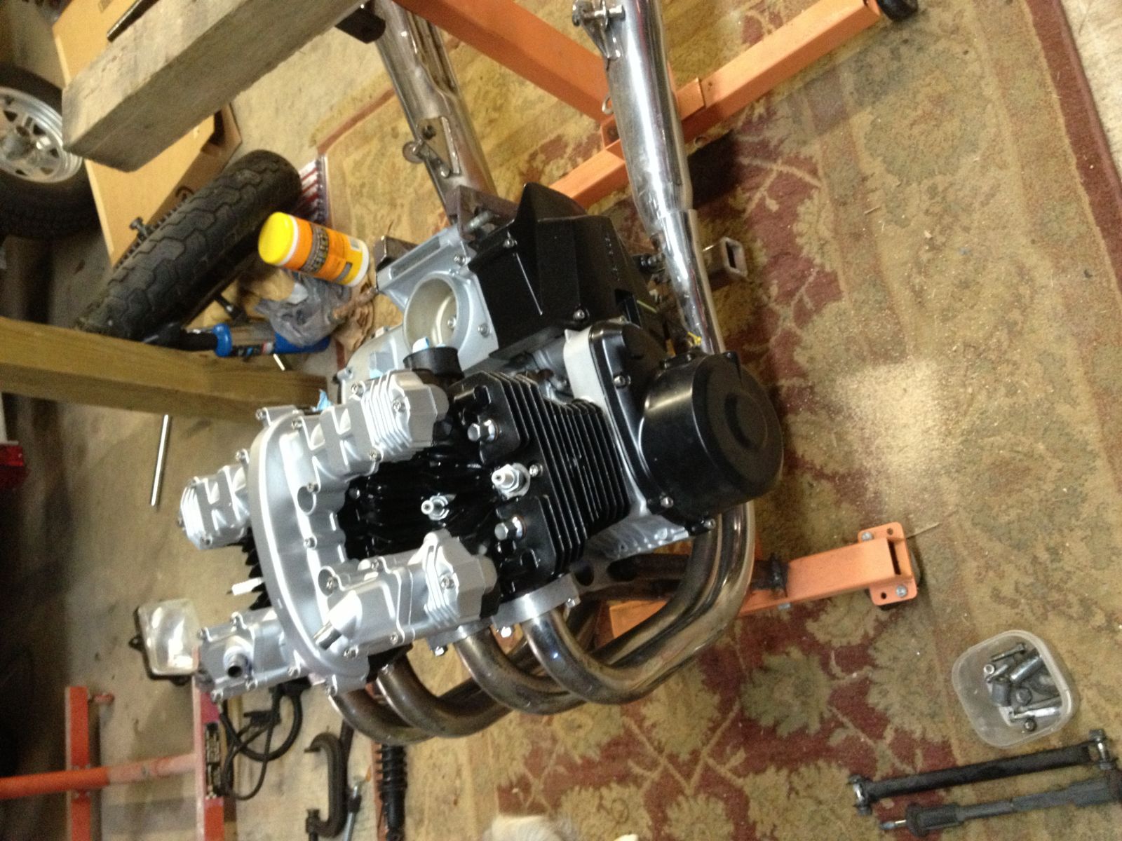

Here is the engine after a Freshing up, new seals gaskets, valve lapping, cam chain and rings. Engine showed very little wear, spent 2 weeks on the rebuild, checked everything and so I think I have a nice tight engine. Not sure on the black side covers, may polish them afterall.
Here is the wiring harness, spent another 2 weeks sorting out the chop job, replaced all connectors with new pieces from vintage connectors. New bullet connectors. I must have cut out 2 lbs of excess wiring, powered up the wiring and all looks good. Now new wiring covers are in order.

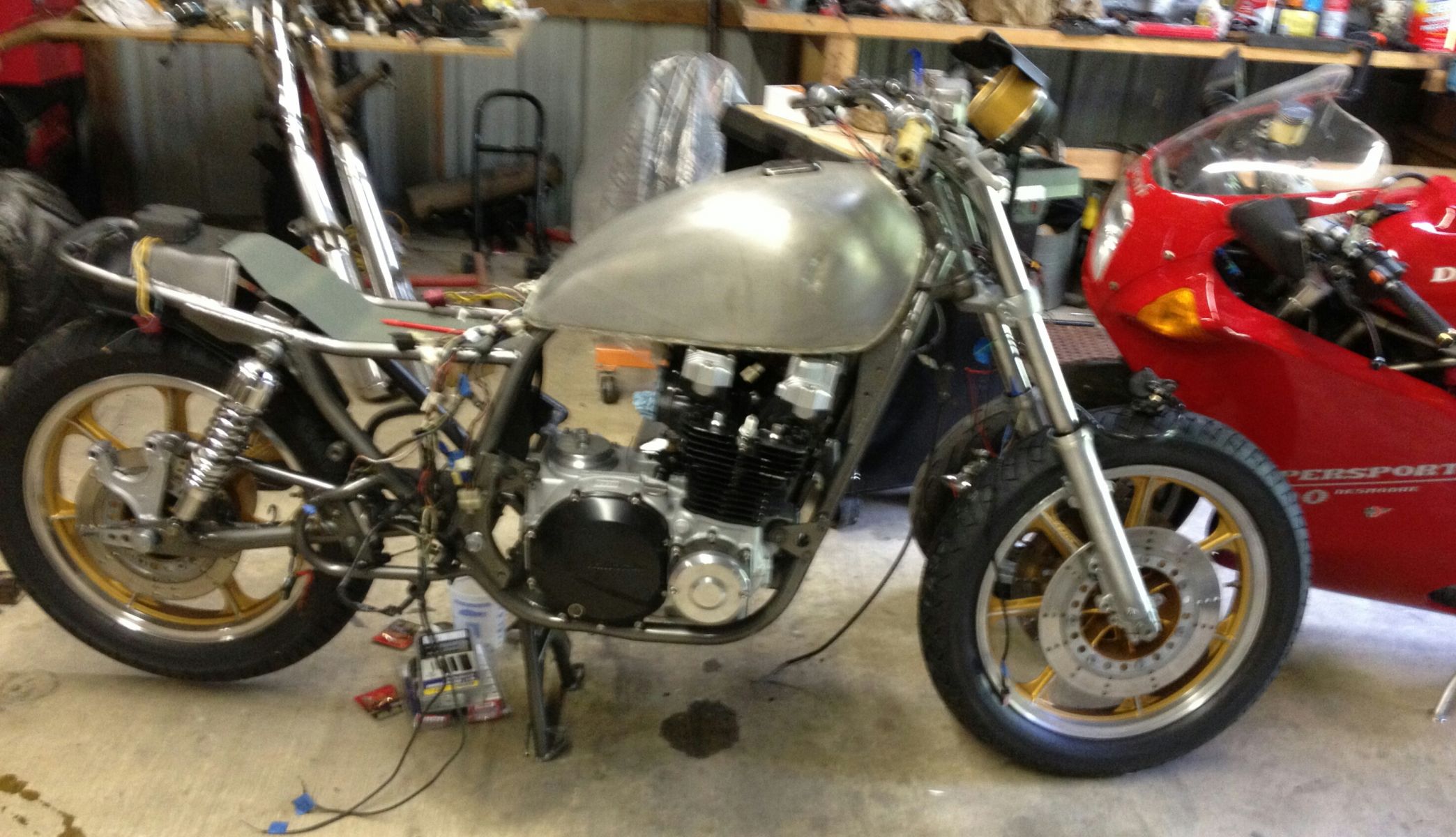

Ok, sorted out the picture issue. Here she is as of the 1st of july, work done so far:
Engine rebuilt
frame detabbed stripped and painted
wiring harness rebuild
forks rebuilt
rims stripped, re coated and new guts and tires.
new rear shocks
rebuilt brake calipers, re coated
Stripped and cleaned tank, few dents to fix
new drag bars
rebuilt kz400 swithches, polished. Working on throttle cable to work with bs34 carbs.
working on fiberglass seat pan for electronics.
rebuilt tach, not sure if I'm going to keep it gold flake, speedo in progress.

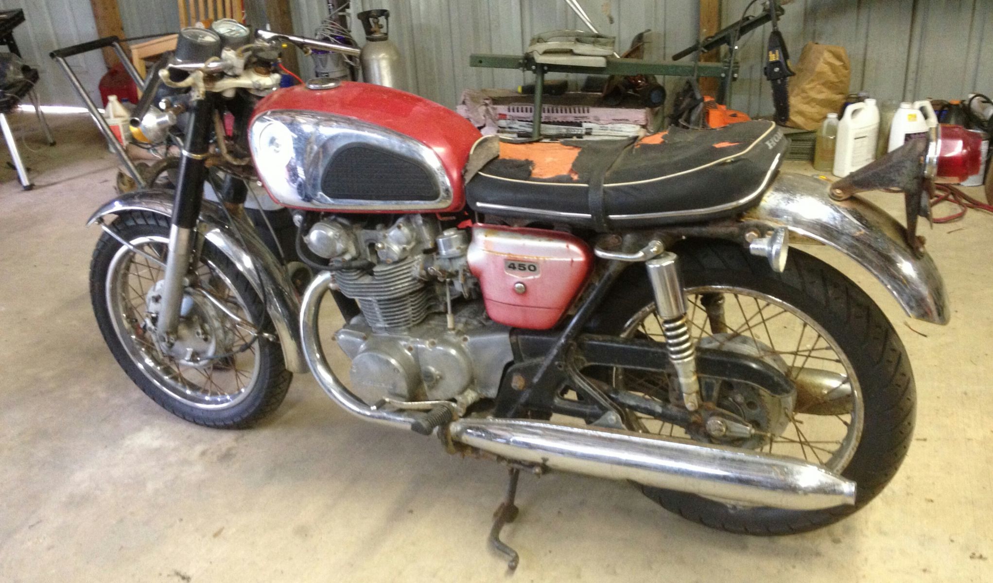

Next project, 1968 cb450k1. 4,000 miles on bike, been sitting forever. This on e will be fun
