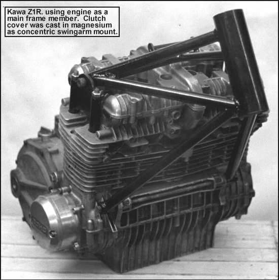

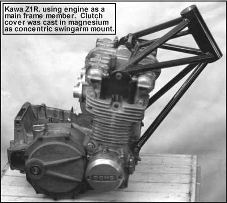

20 Nov 2015 04:52doesn't mean it can't be done tho :whistle: :evil:650ed wrote: I'm not sure what I'm looking at. Your picture shows the cradle frame missing the lower portion. Are you planning to use the engine as a stressed frame member similar to that of the Ducati? If so, you may want to consider that the Ducati has a strong trellis frame above the engine, and that the Kawasaki engine cases were not engineered to serve as a frame member. Ed

Yes, I saw that at
books.google.com/books?id=84hF-qoR5I8C&p...ame%20member&f=false
However, I didn't see how the thing ended up being a complete motorcycle, and if it did, anything talking abut how well it worked or how long it lasted before the engine cases cracked. I can tell you from personal experience that a cracked engine case (BSA in my case) makes for a pretty bad day. :laugh: Ed
Last edit: 20 Nov 2015 05:53 by 650ed.

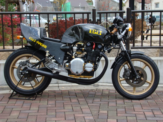

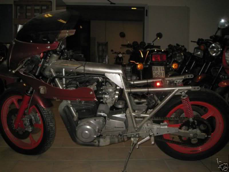

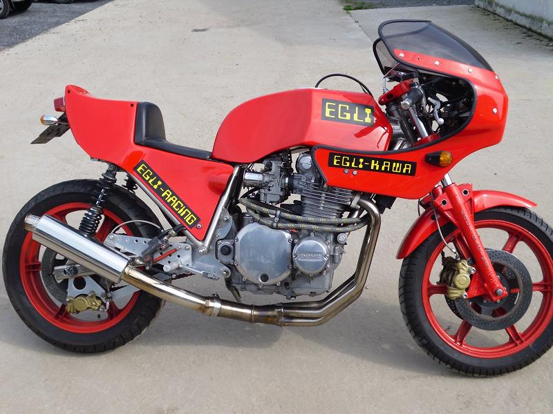

- Posts: 7442
Re: KZ1000/ZRX1200 Build
20 Nov 2015 10:08
i don't know if they ever completed it,ed.
but our favorite swedish mechanic Fritz W. Egli,
seemed very fond of using them as a semi stressed member.
