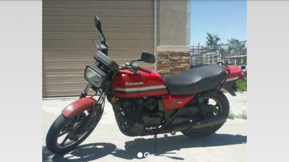

I'm keeping an eye on this one . I just bought one the other day for $500. Looking forward to riding it and fixing it up.

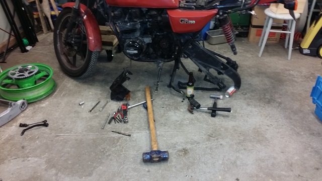

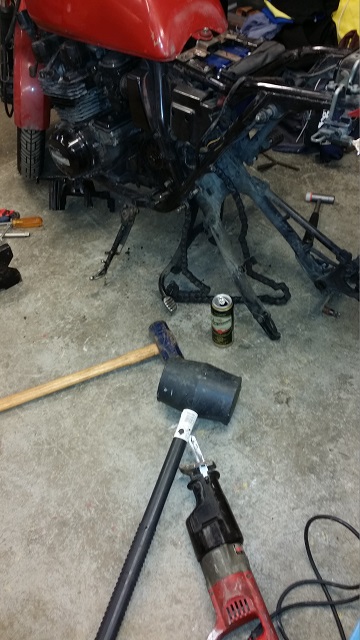

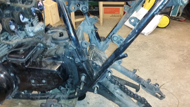

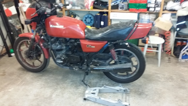

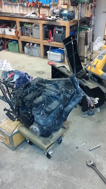

Finally it was time to get going with this winters project. My garage find that I bought for 50 US this spring proved reliable and I rode it to work basically the whole summer, clocking some 2000 Km without any problems. (of course there was a bit of rattle and bling and stuff falling off but what to expect from a bike 33 years old that had not received any kind of love for that last 20)
Considering the overall condition of my garage find, Erik and I was seriously concerned about how many bolts that would cause problems for us when we started taking it apart.
Ready to start in order to fit a Zephyr 750 -91 swing arm.
Much to our amazement all bolts came out just fine, even the headers came off without any fuzz, so far we could conclude that our choice of an Indian Pale Ale from a microbrewery in the city of Vaxholm was correct, as it got the job done.
But when it was time to withdraw the swing bolt we hit trouble. The swing bolt is seriously sized in the pivot tube and we realized that the Everyday IPA from the village of Hedemora that we were currently working with was not the right tool for the job.
We quickly changed to Czech pilsner and sturdier tools and managed to get the bolt to move about a 1mm. The movement was probably caused by us deforming the needle bearings, the bolt itself is totally sized in the pivot tube after happily living together for the last 33 years without any sort of care.
We have a hydraulic bench press, but how do you fit the frame in the press or the press around the bike? Even getting Kroll in the pivot tube is basically impossible, so this require some thinking and possible use of the jack saw.

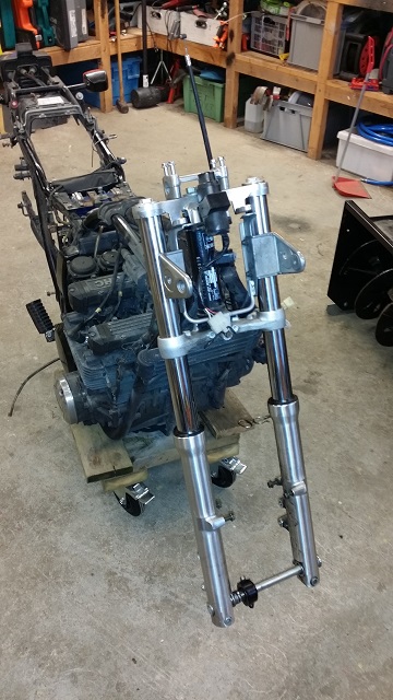

The front end however was easy-peasy, just dump the original fork
and the Zephyr 750 -93 (41mm) front end fits like a charm using the original GPz 750 bearings.

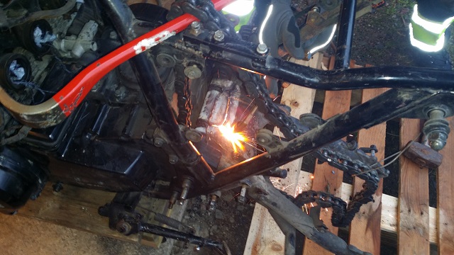

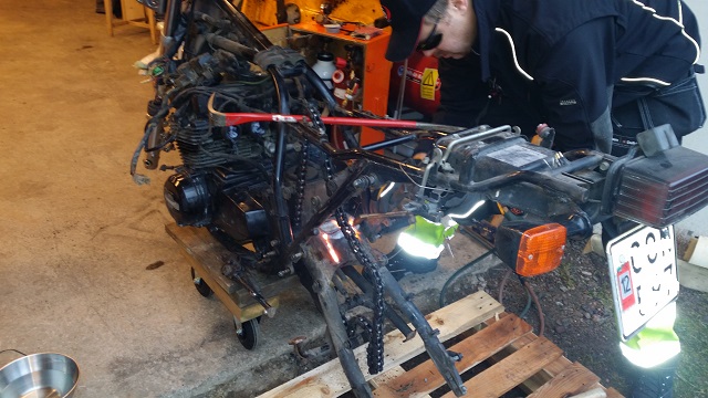

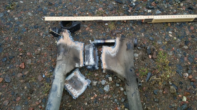

I could never imagine that the sized swing bolt was going put up such a fight, we tried every trick up our sleeve to get it loose.
Unfortunately the garage is a wooden structure so we could not play around with hydraulic jacks to press it out, so in the end I went out and bought a second hand used oxy-weld kit to heat the little F#&@er out.
But the swingbolt continued to elude us to big time and finally it had to pay the final price as the oxy-weld kit contained a cutting torch.
This means that we didn’t get a chance to measure up the swing arm before we start fabricating the new distances and bushings we will need when fitting the Zephyr swing arm to the bike.
Tks. to this excellent forum we already know that the pivot is 230mm

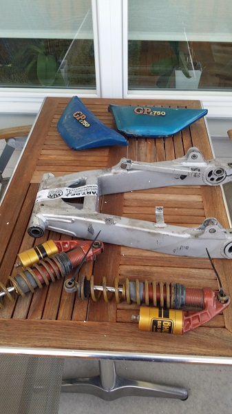

In short, we have a used Gpz750R1 swing arm for sale that some think can be brought back to life with a little JB-weld.
