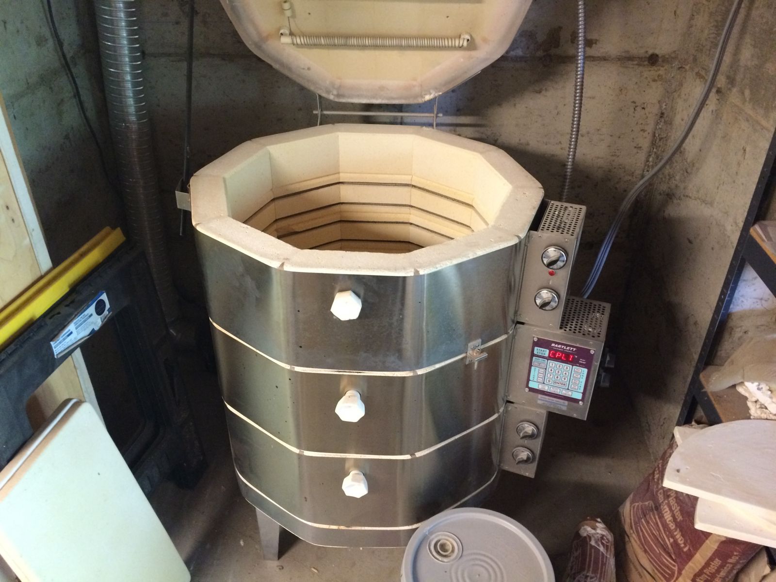

So i bought two alloys to try. 4340 chromoly which is on par with grade 8 bolts. and I bought some 17-4 stainless which is a precipitation hardnened alloy. Just so happens I have this....

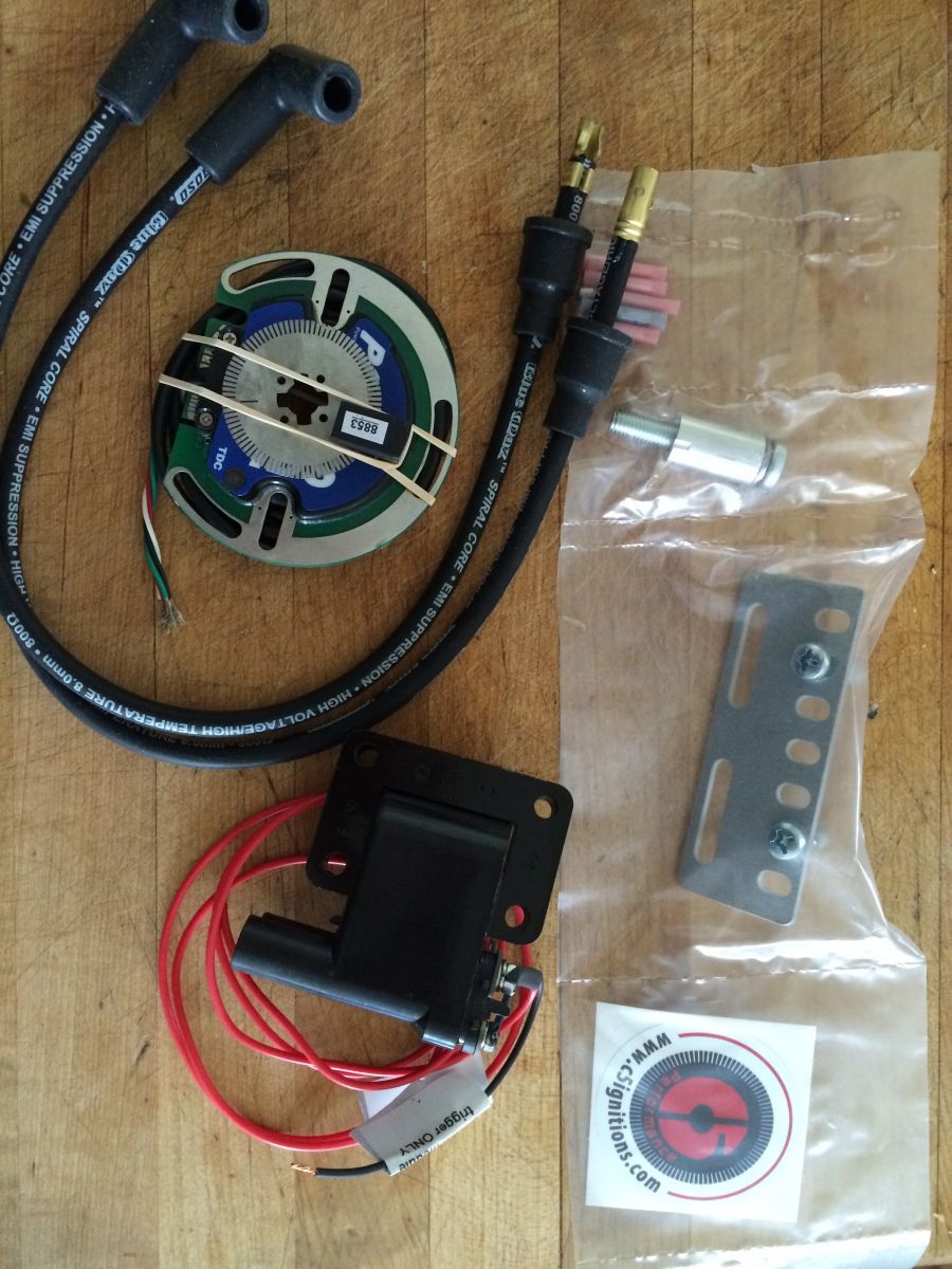

Also my optical ignition came in. super cool. thanks for the heads up on this Jon

woohoo another c5 ignition in play!!!!!
i have purchased one for a buell project i have simmering.
paul is a very knowledgeable/helpful guy.
nice to see folks using his product.
can't wait to see how it works for you.
