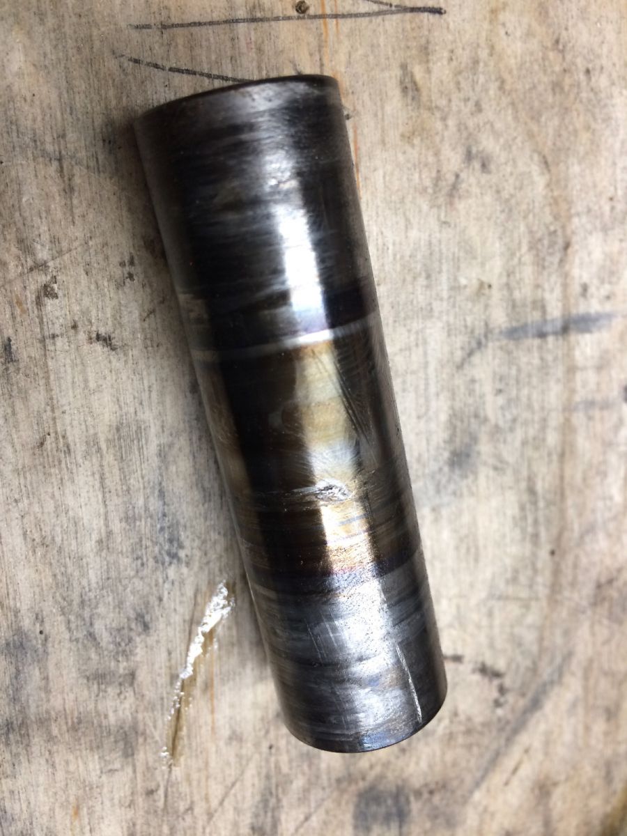

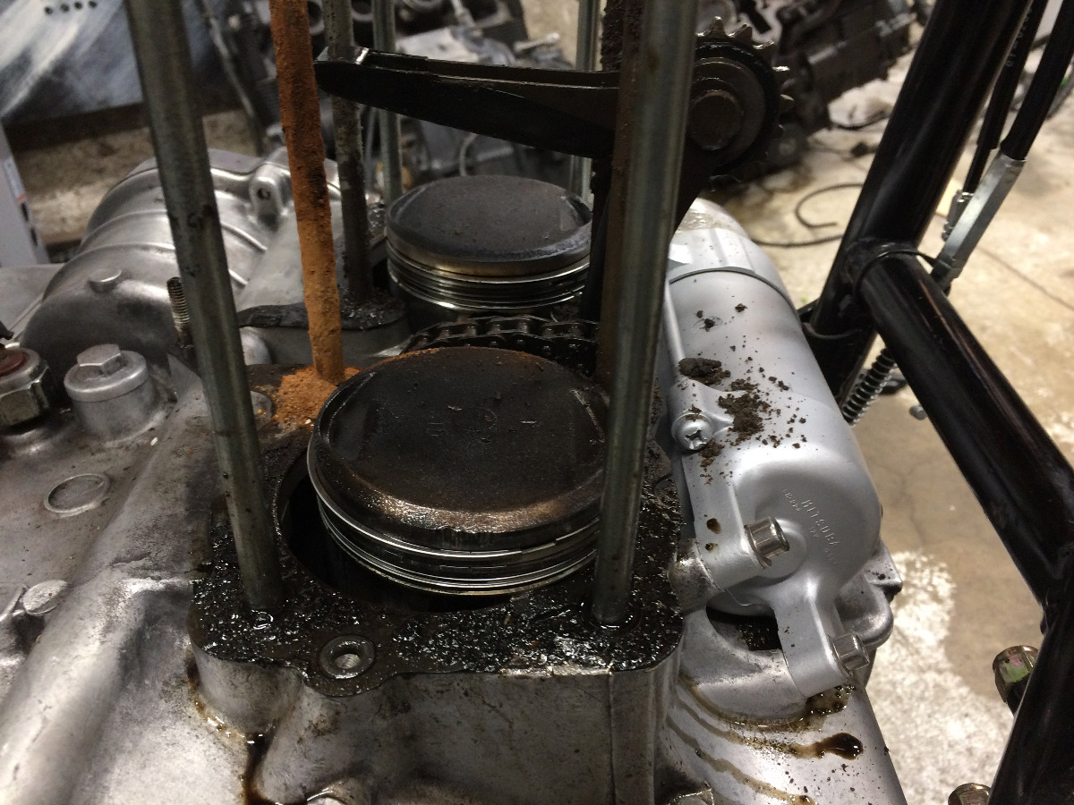

So much for my quick top end swap.... no wonder it seemed low on power. The right piston pin was seized in the piston and took a puller to remove. Not sure how it started; further inspection required. the small end of the rod is trashed. Luckily i can remove the rods through the oil pan. but since I have to go this deep I'm wondering if i should pull the motor and go through the whole engine? that's a bunch more work i'd rather not do. There didn't seem to be any big chunks in the oil pan, just a little dirt that fell down when i removed the jugs. I just can't seem to get an easy one on the projects lately....

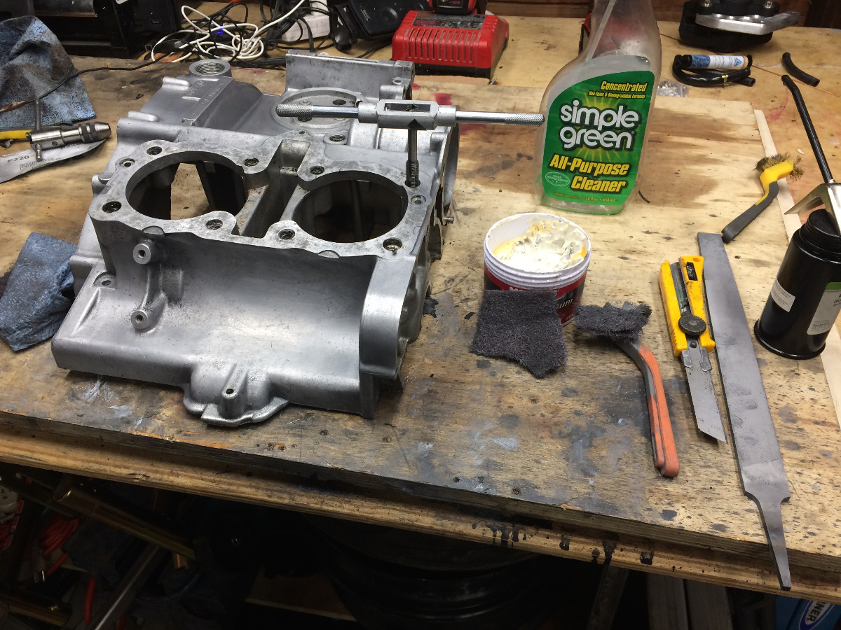

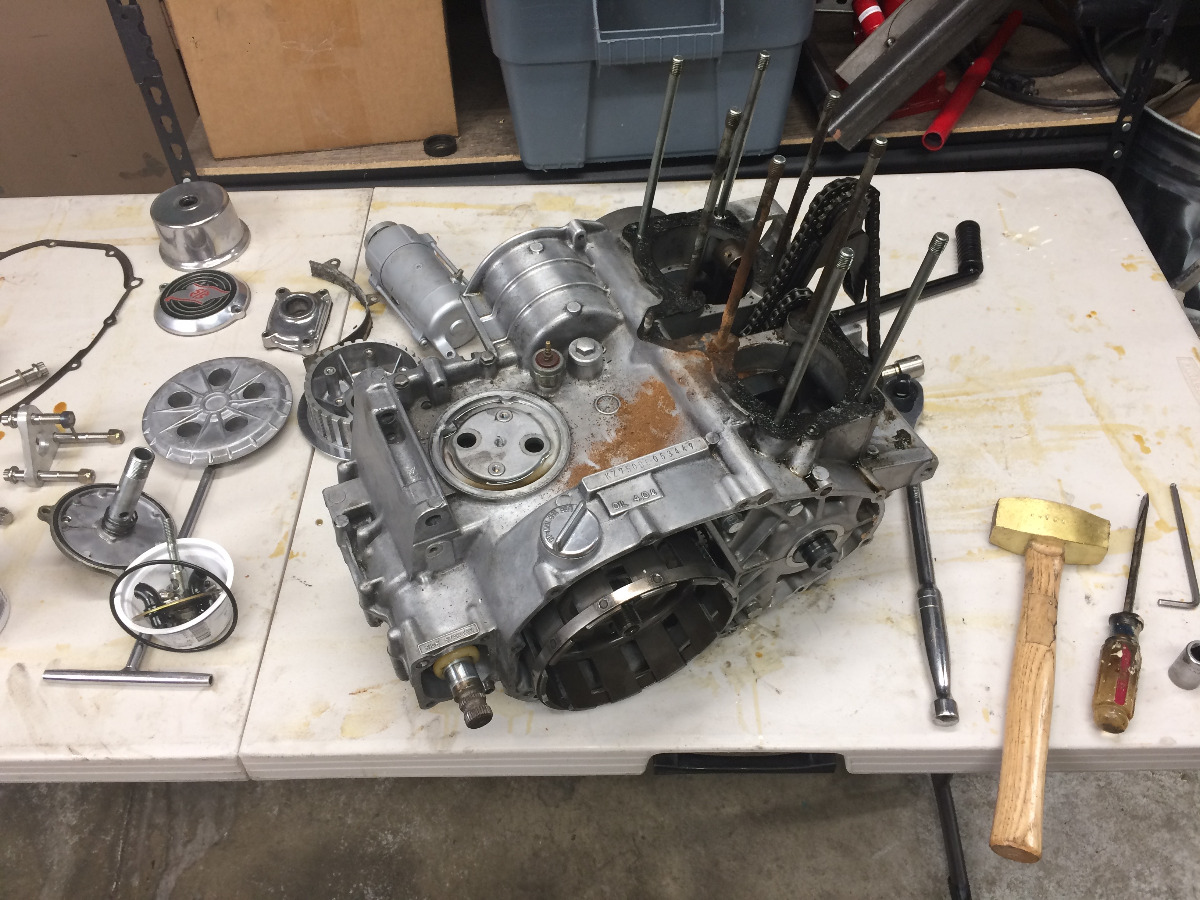

After inspecting the sludge in the oil filter/oil gallery I decided to go all in on the engine rebuild. Got some cool mods in mind as well. stay tuned.

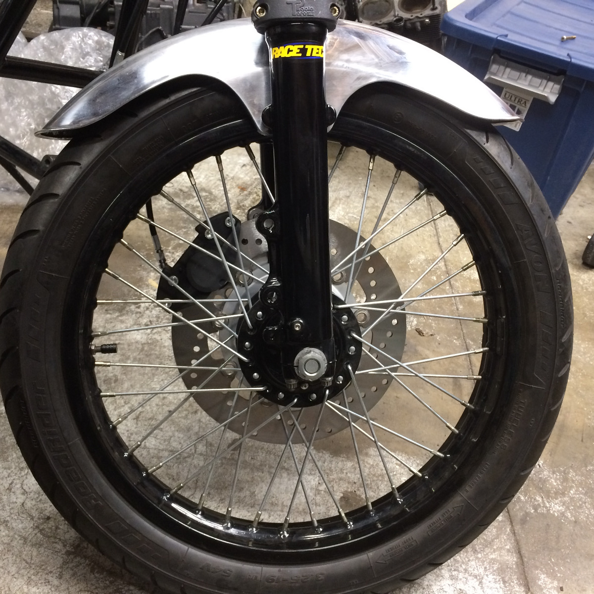

Finally got the easy win I was looking for. New EBC single disk setup. Shaved 4 pounds off rotational mass and an additional 2.5 unsprung with the removal of the extra caliper. I bought a 12mm brembo MC to match. The fitment is super tight. less than 1mm on spoke/caliper and disk/fork leg. I'm digging the new look. Very interested to see how it feels.

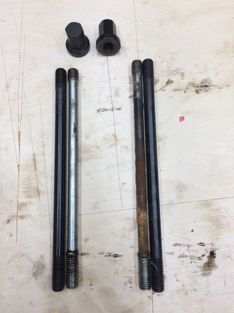

Small update, but one of particular interest to kz750 twin owners.
I was cross referencing part numbers and realized the z1/kz1000 share the same head studs as the KZ750 twin. This means you can use APE's heavy duty head studs and nuts which are intended for the z1/KZ1000. I have bought a set and can now confirm, however, you do end up with 4 extra studs and nuts you don't need. These bikes are notorious for head gasket leaks, increased compression will likely make this worse, hopefully this will help address that.

Break a stud?
