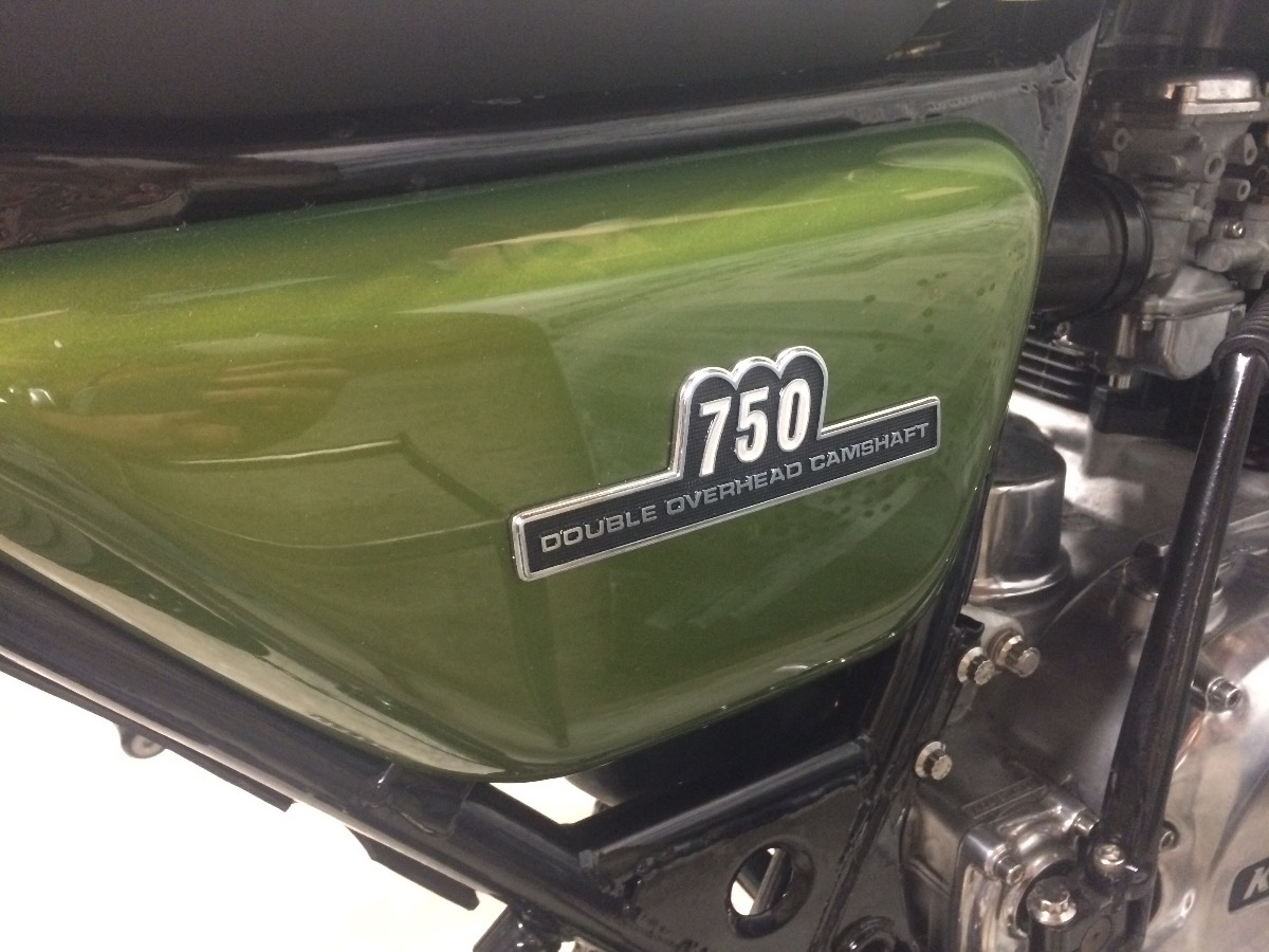

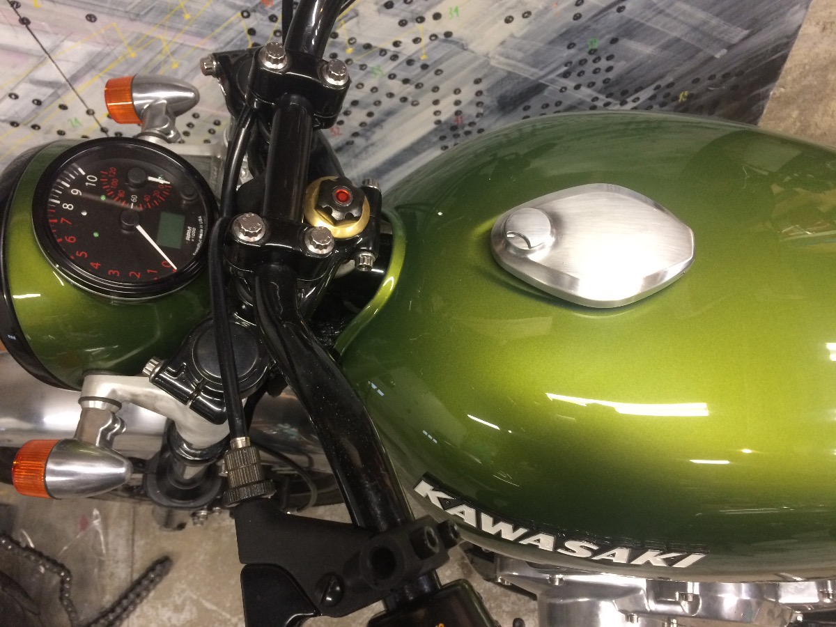

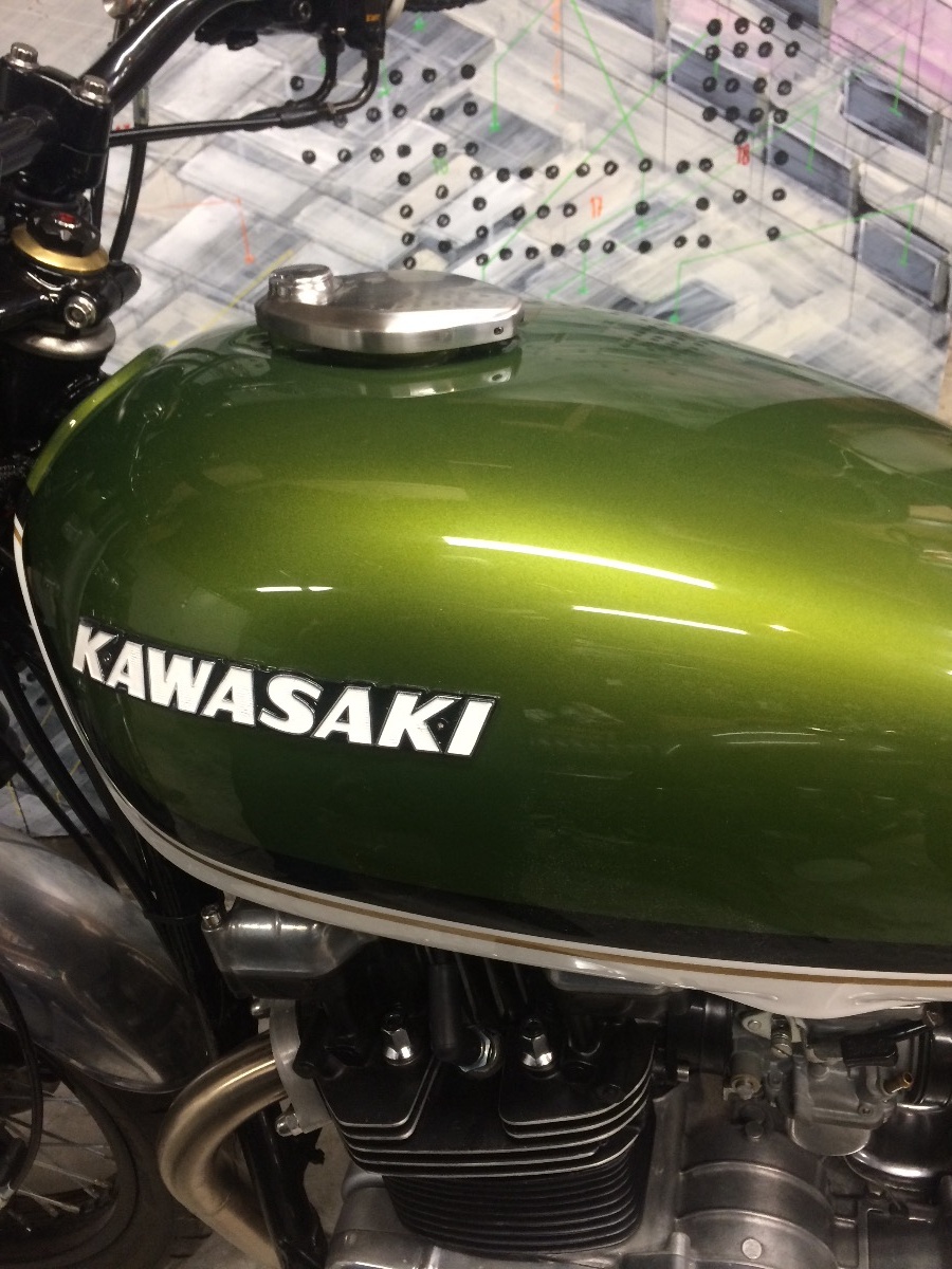

Finally had the time to cut and buff the paint. The result is dead flat with no definition line over the stripes. I also put on the badges.Ive been tinkering with the wiring off and on for months and it is finished. I did a bit of driveway tuning learned about the one year specific pilot screws to this year. Rounded up the nessecary parts and it's synced and seems to run great. All that remains to sort is an axle and a license plate. The latter of which should be here ina week or so.

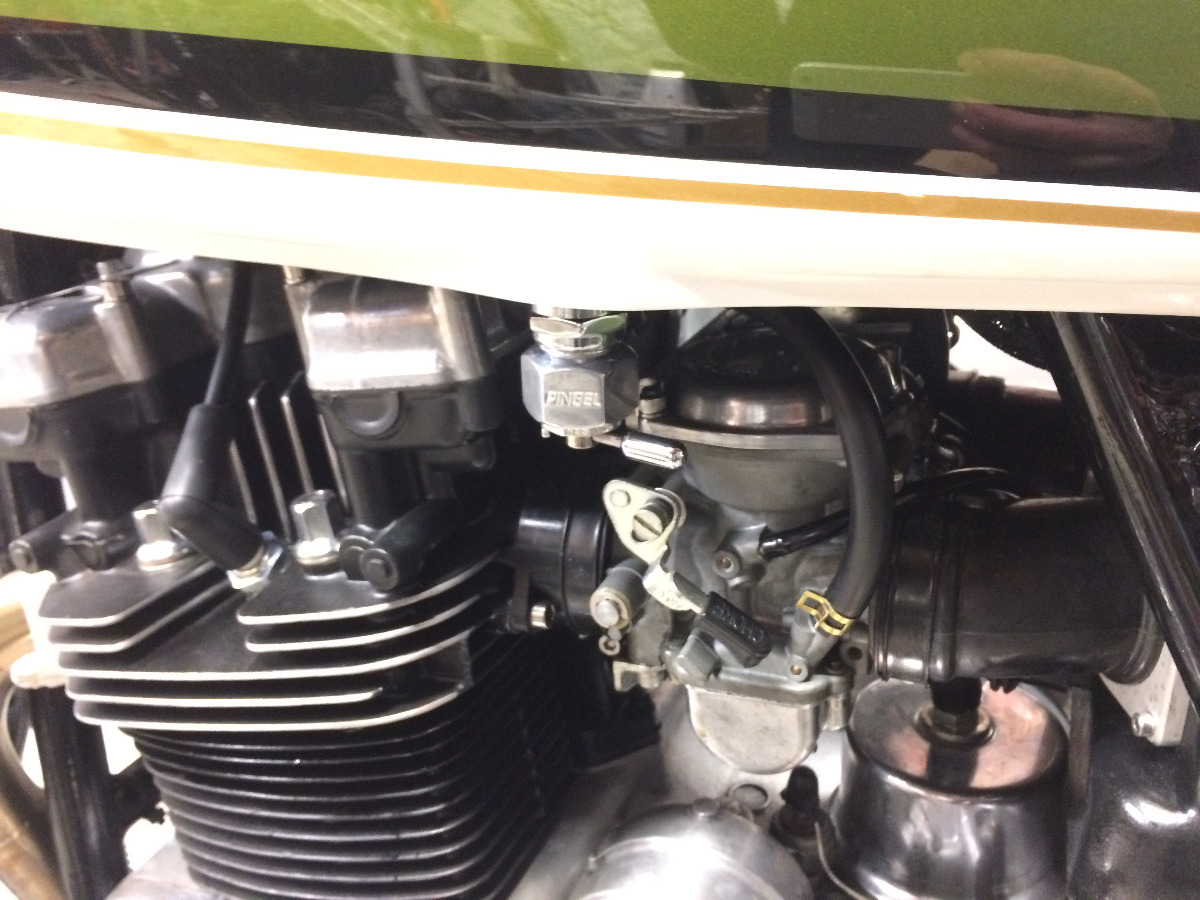

I took the Pingel off my kz1000. At the very least it makes routing the fuel lines WAY easier, and looks a lot better. Unfortunately it didn't solve the fuel starvation problem. I popped the gas cap open and rode it like that as well thinking maybe it wasn't venting properly but that had no change. I'm gonna pull the carbs off and inspect the fuel inlets and float valves. Scratching my head here. suggestions?

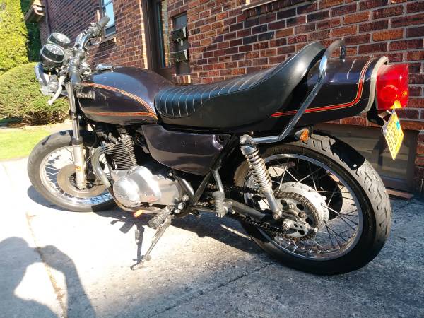

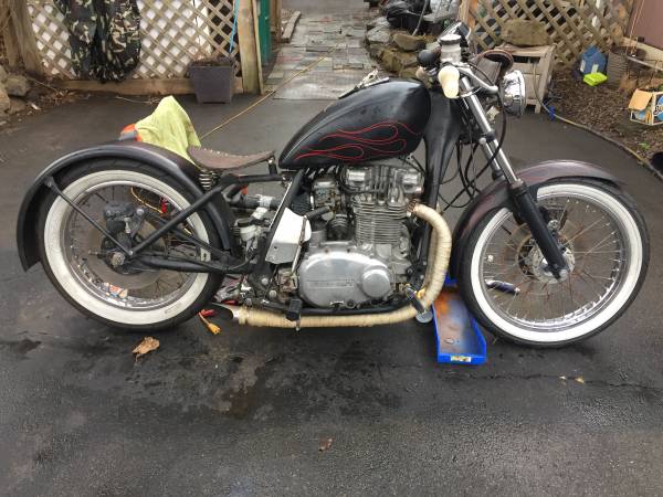

But, back to what I was going to post, just jumping in with some KZ 750 twins in the Buffalo, Area.
1 stock and 1 a bobber! I'm not into bobbers! But if I was, this is one that is cool as FK! Done well!
Sorry to but in, butt this way more people can see these 2 motorcycles
2 craigs ads:
buffalo.craigslist.org/mcy/d/78-kawasaki...twin/6584305250.html
rochester.craigslist.org/mcy/d/1976-kz-7...saki/6583738290.html
