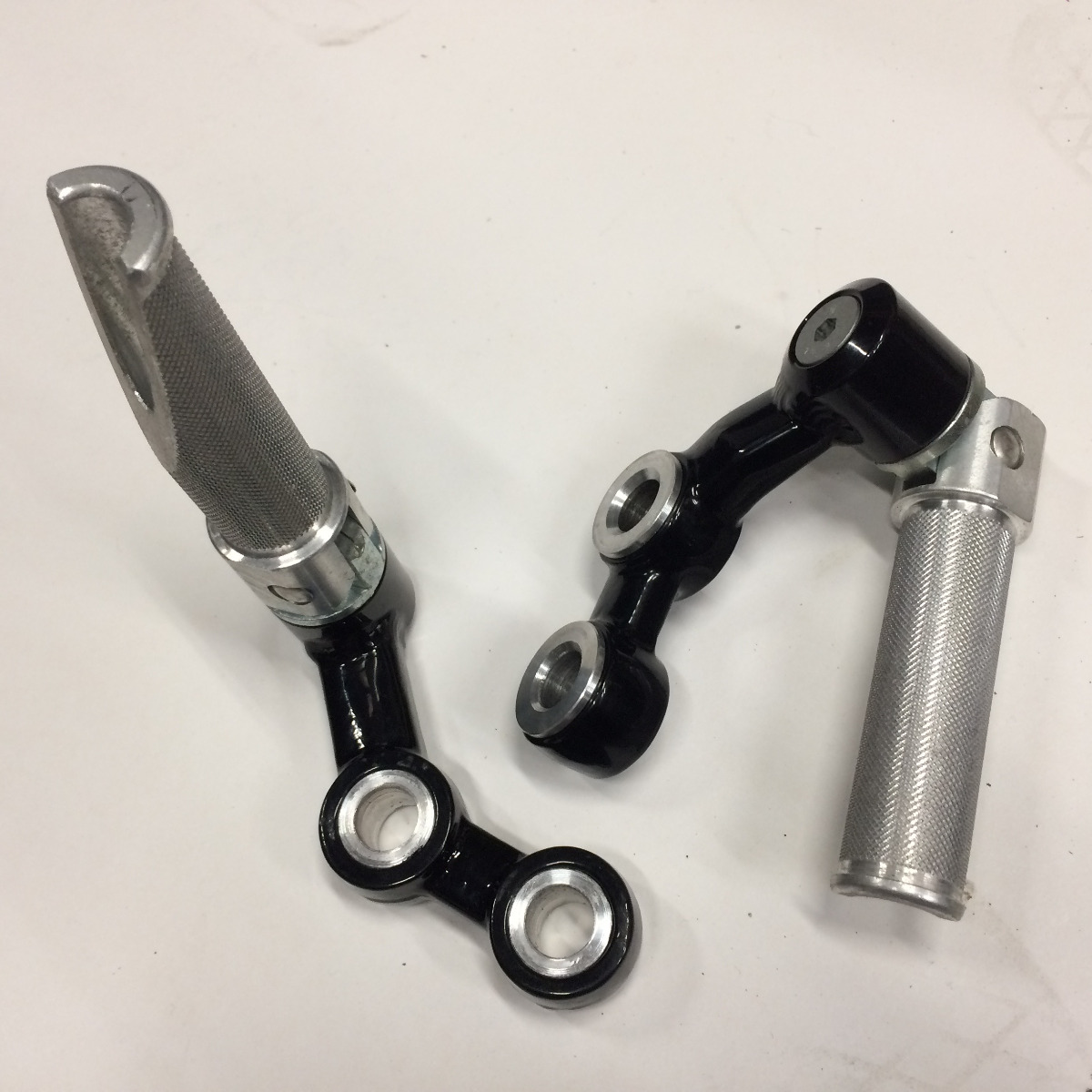

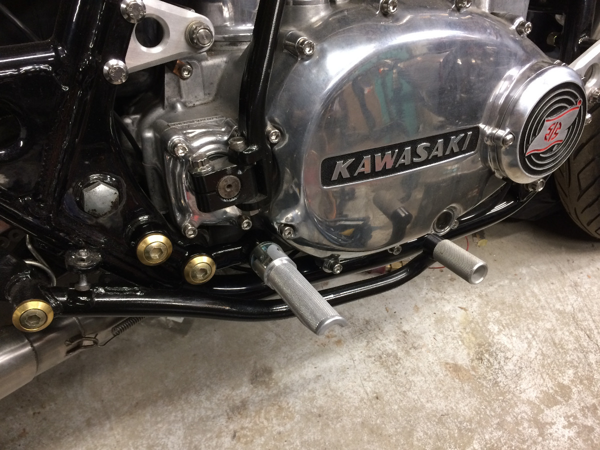

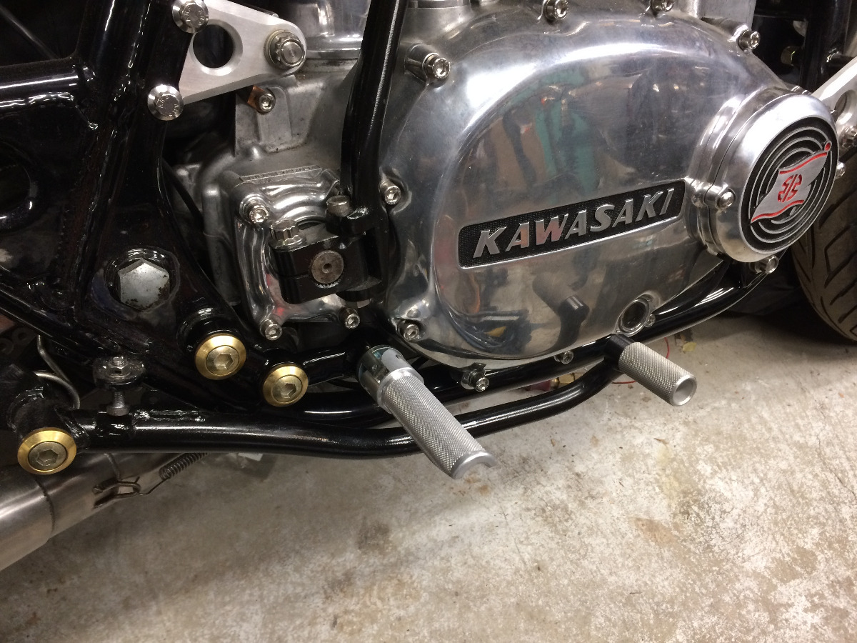

I decided to scrap the custom foot-pegs I was working on and modify the stock brackets to use Tarozzi pegs, I also turned some aluminum spacers so they are solid mounted now. all that remains is wiring, fuel plumbing, and a license plate holder. gettin close!

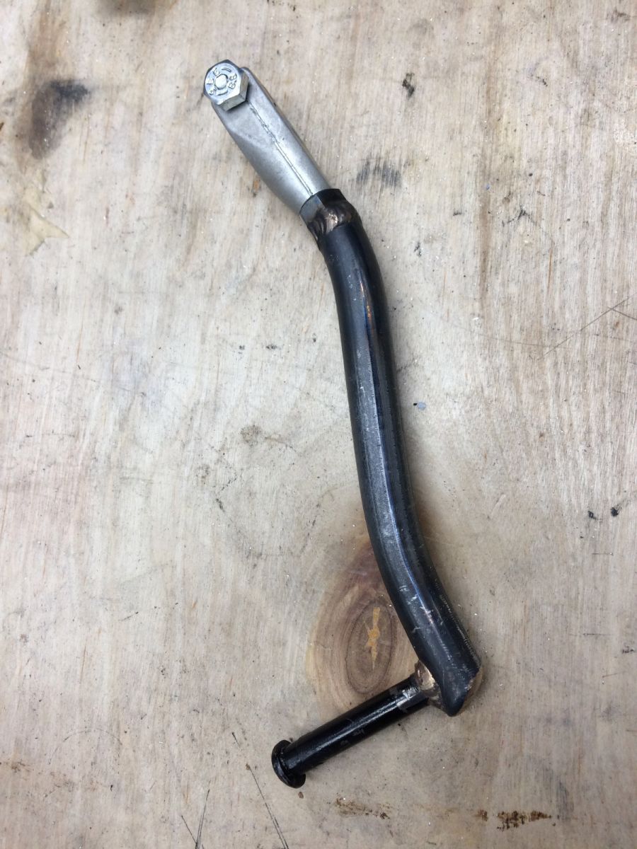

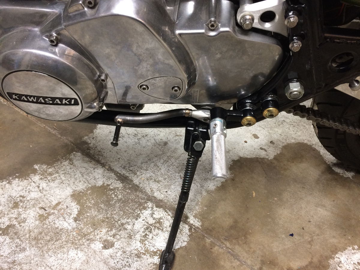

forgot to some add these pics of the new shifter. I went a little overboard on the speed holes with the stock shifter so I re-made it out of thin wall steel tube, and TIG brazed the fittings on. It threads into an aluminum Tarozzi splined clamp.

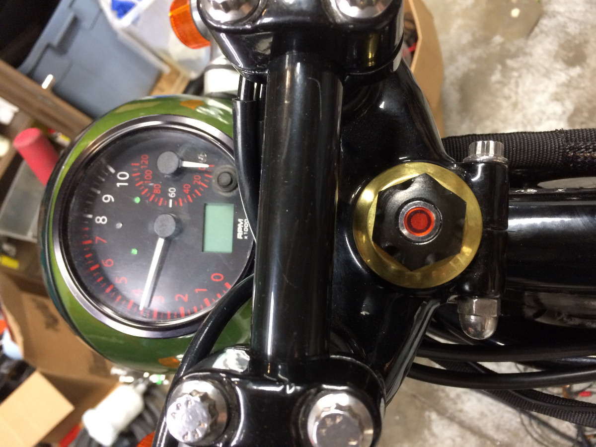

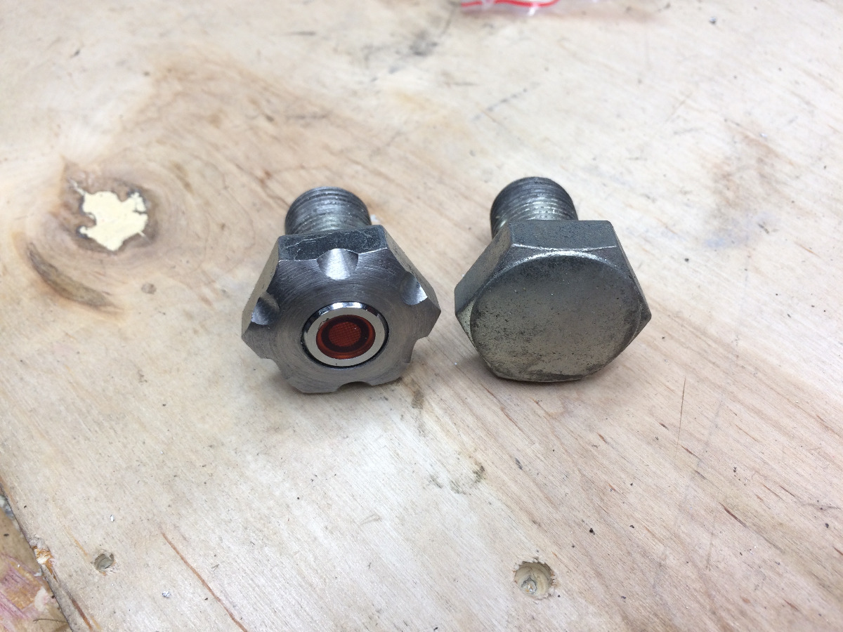

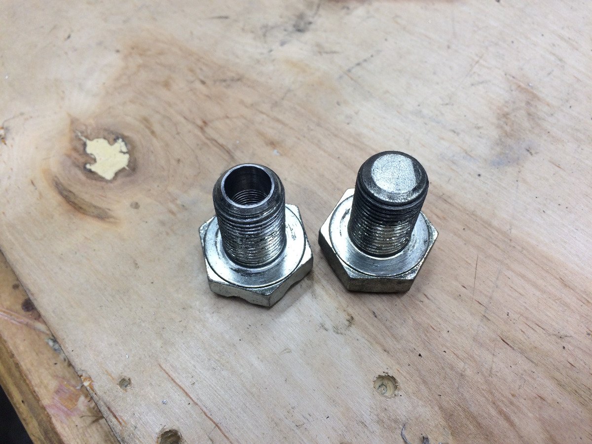

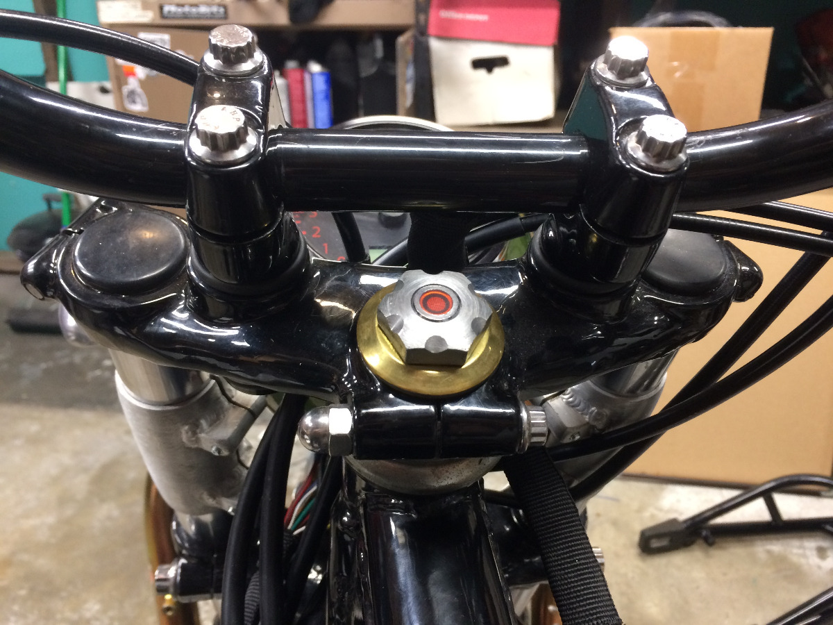

I'd like to get some opinions here as I have compromised the strength of a semi-structural screw and I don't want my own "genius" to kill me. I drilled and tapped this head-stock screw to mount an oil light. The difference between the OD minor thread diameter and the ID major thread diameter is about 4mm so I am left with 2mm thick walls. This screw appears to pretty lightly loaded as the steering stem fits into the top triple and is firmly clamped with a pinch bolt. I torqued the modified screw to the factory value of 36ft/lbs and it seems fine. I have also seen aluminum aftermarket replacement screws available for this application so I can't imagine that this is super critical strength wise. thoughts?
Last edit: 19 Mar 2018 13:22 by DoctoRot.

My thought is the bolt is used to make sure the the top clamp is fully pulled down onto the stem before being locked into place by the pinch bolt,
I cant see how it would cause any catastrophic failure
