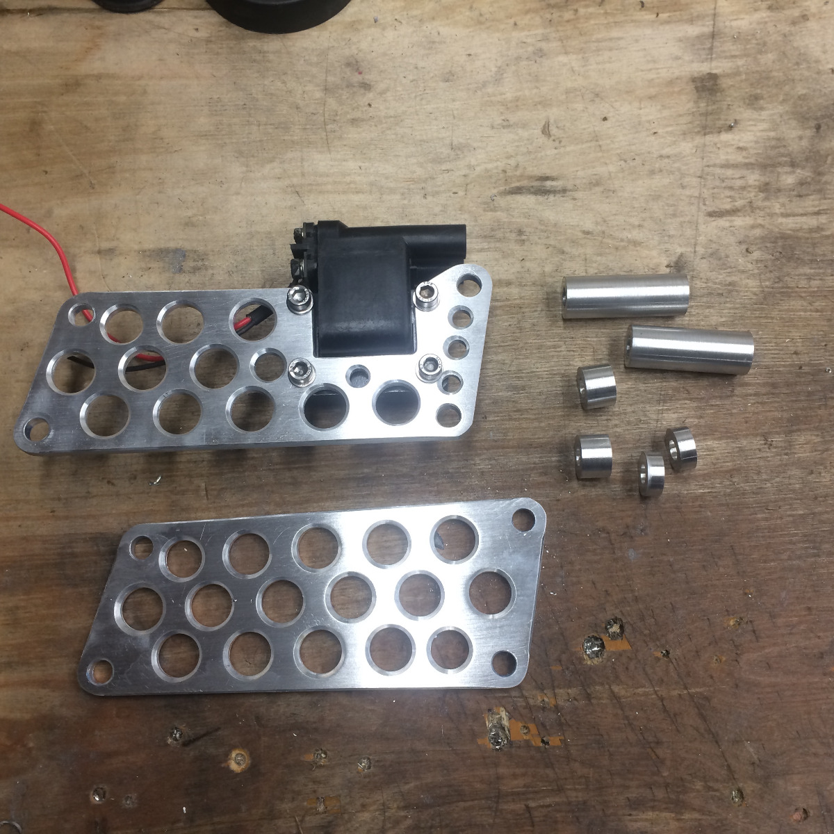

Re: Saving a 1980 750 twin.
25 Jul 2017 00:25 - 25 Jul 2017 00:31
Got around to finishing the top motor mount. I ended up doing something similar to what NebrRex suggested. I used a 3/8" reamer in a hand drill to bore out the mounts and at the same time got them pretty close to axial, they were a little off before preventing a bolt through bolt mounts, so now I can through bolt side to side with spacers so it not only supports the motor but ties it all together and increases frame rigidity. I also milled the valve cover to remove the draft on it and now the mounting points are parallel. I ended up having to offset the coil to make clearance for the throttle cables and electrics that will go through the backbone as well. I like that you can see the mounts if you bend down to inspect the bike. I also refinished the tank and side cover badges I bought as I hate flat black paint, and the white didn't match the shocks or tank. details....

a very elegant solution sir!
