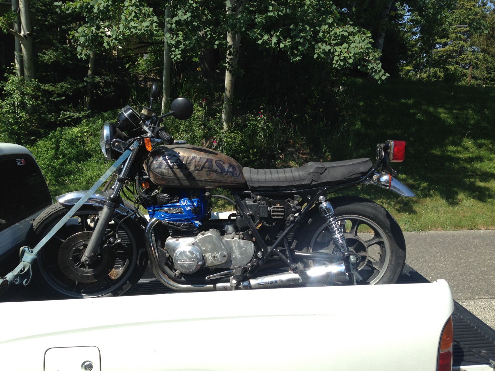

Seat is coming along. The top is finished and i have the sides basted on before doing th real seam. I dont really like making seat covers, they stress me out.
I revised the mounts on the taillight and it is finished. i probably will paint it black, lol.

tail light turned out nice!
is that the stock lens?

27 May 2015 10:31531blackbanshee wrote: tail light turned out nice!
Thanks Leon, Its a aftermarket LED item originally for a honda monkey.

I wouldn't paint it, I'd clear coat it. Too nice to hide.

sure looks "right"on there.

Thanks guys. On a particularly awesome note, State Patrol contacted me yesterday telling me they had an opening in the schedule today if i would like to come in early for an inspection. Called in sick to work, then cobbled some shit together making sure all the lights and brake worked, and passed the inspection. :woohoo: The officer didn't even look at the bike she was just interested in the VINs, so i probably didn't need to stay up till 5 am troubleshooting the lighting system. Now i can register it and start the 3 year probation period for the title. Stoked!
