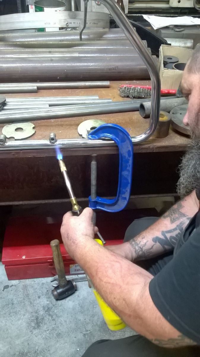

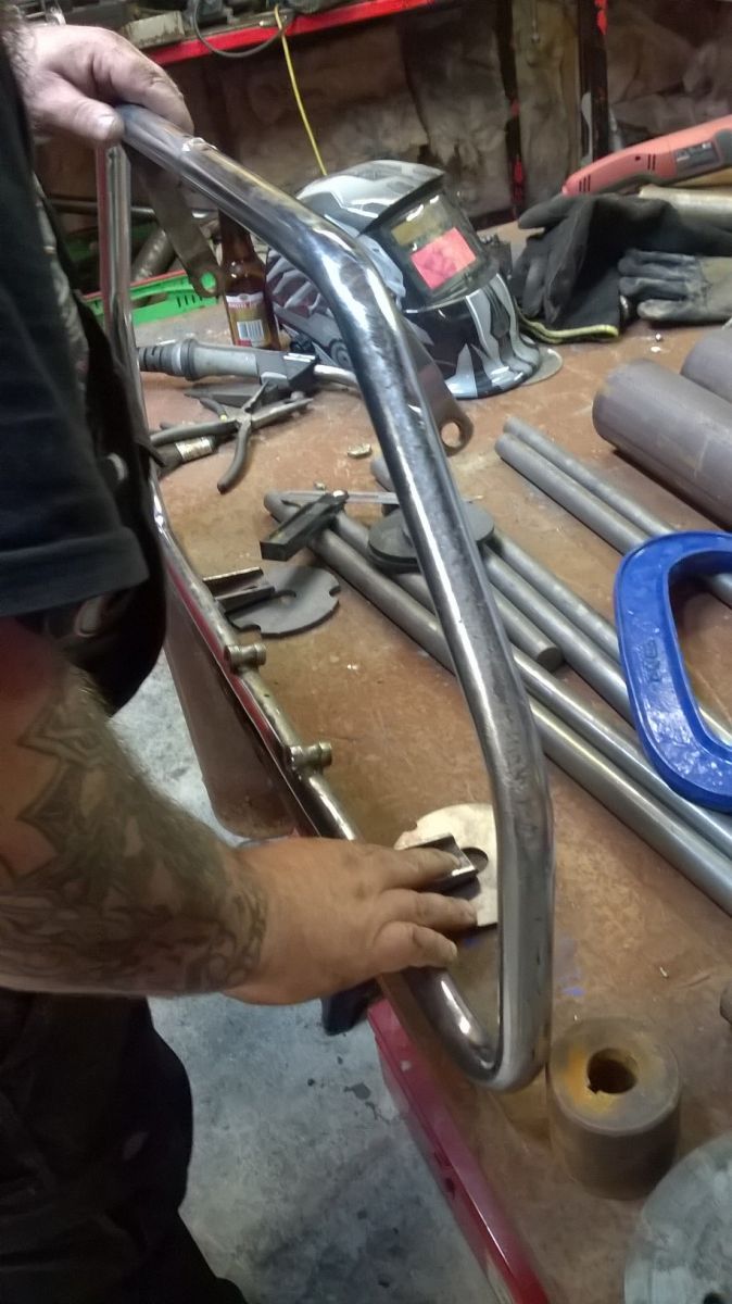

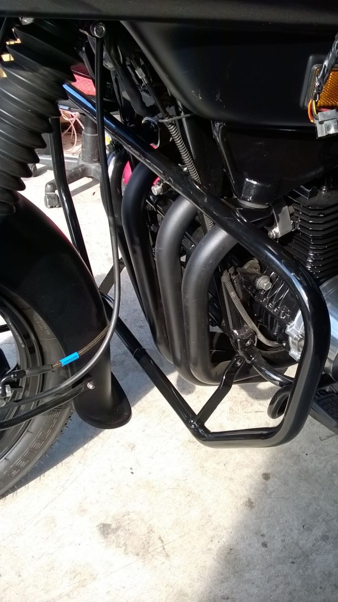

My mate George and I decided that we would finally try and sort out the very very bent crash bar that is now pivotal to finishing the KZP. The bike is now only a week or so from being finished! Best bit is we did manage to get the crash bar sort of straight but at least usable. It's at the powder coaters now getting the obligatory gloss black.

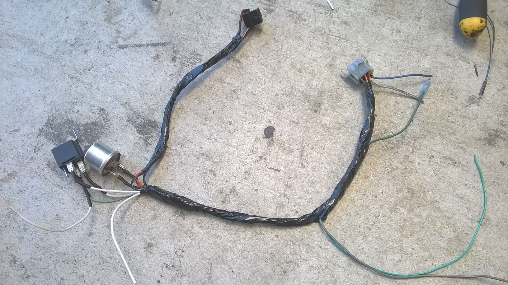

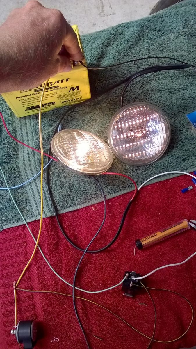

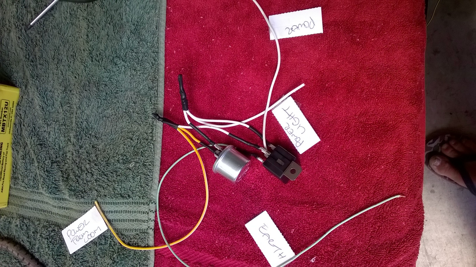

Wouldn't be a very good patrol bike if there weren't flashing lights too! Used a flasher unit and a horn relay and hooked up an alternating wig wag for the two blue pursuit lights at the front. You can't tell from the photo but the lights are alternating, honest. I finished up the wiring inside the front cowl as well. Getting closer.....

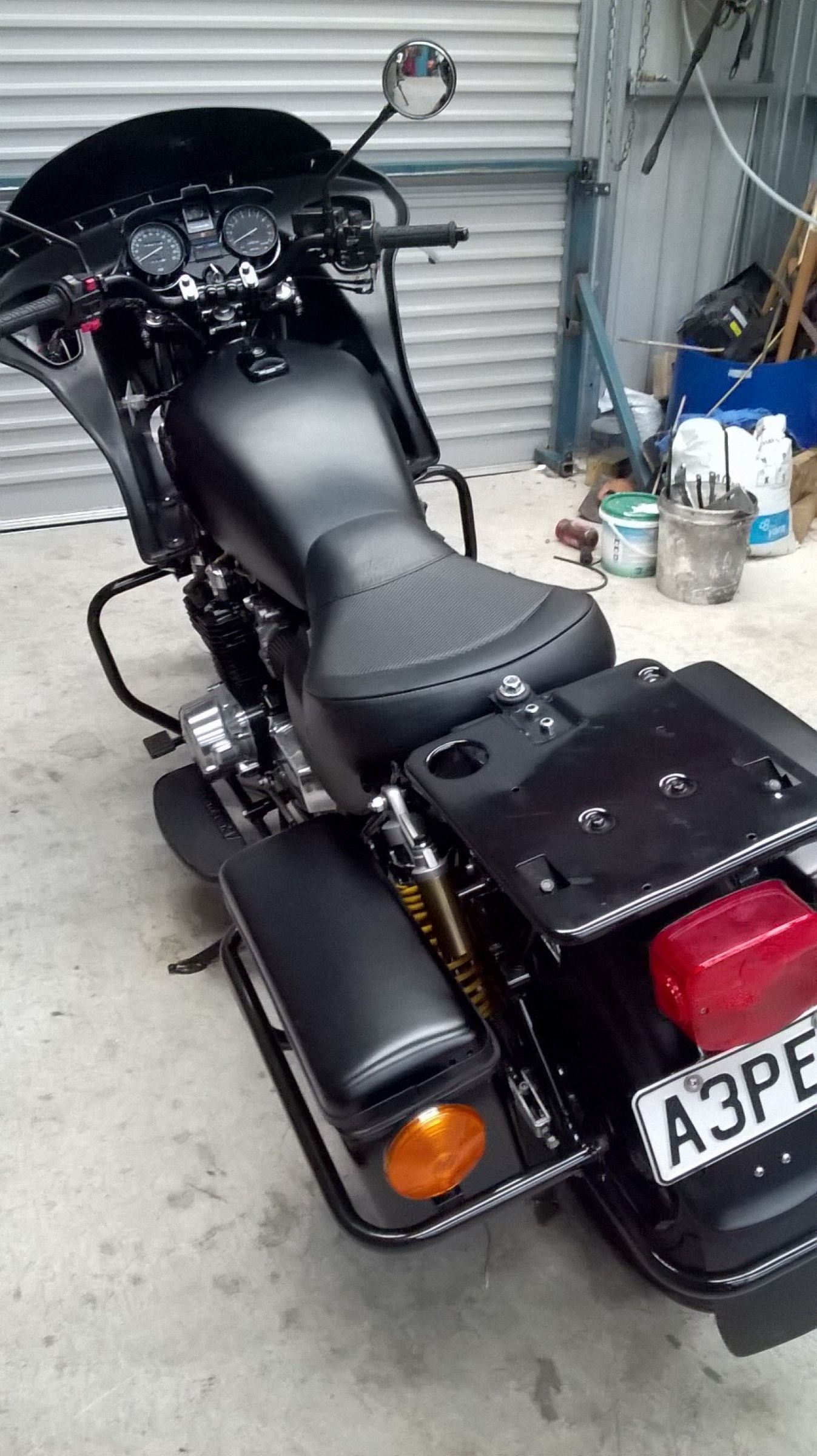

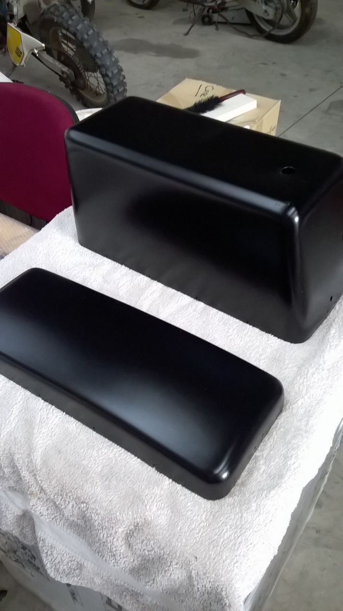

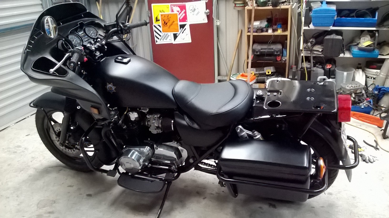

Sooooo close now, got the bags back from painting and just fitting up the freshly coated crash bar.

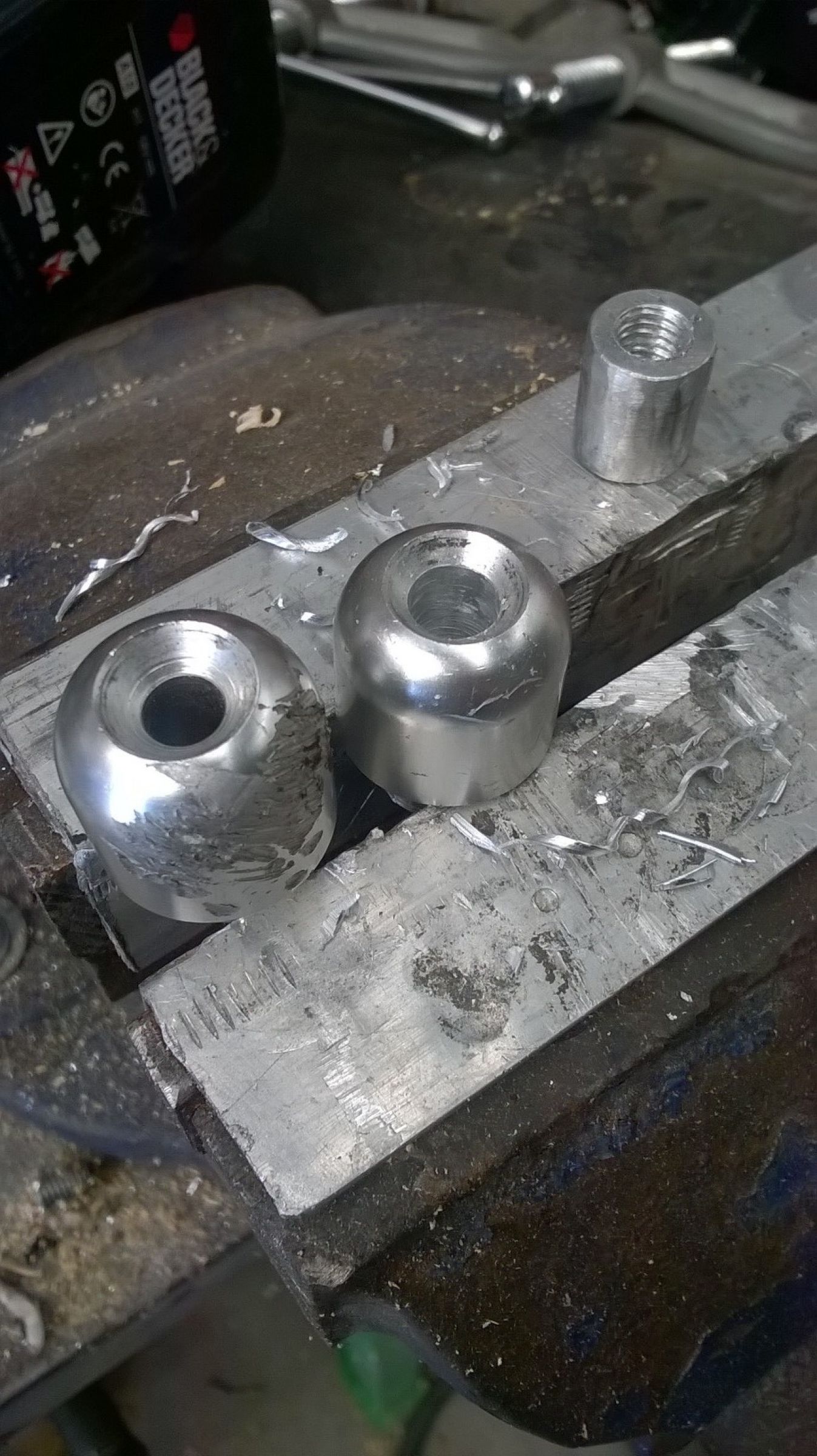

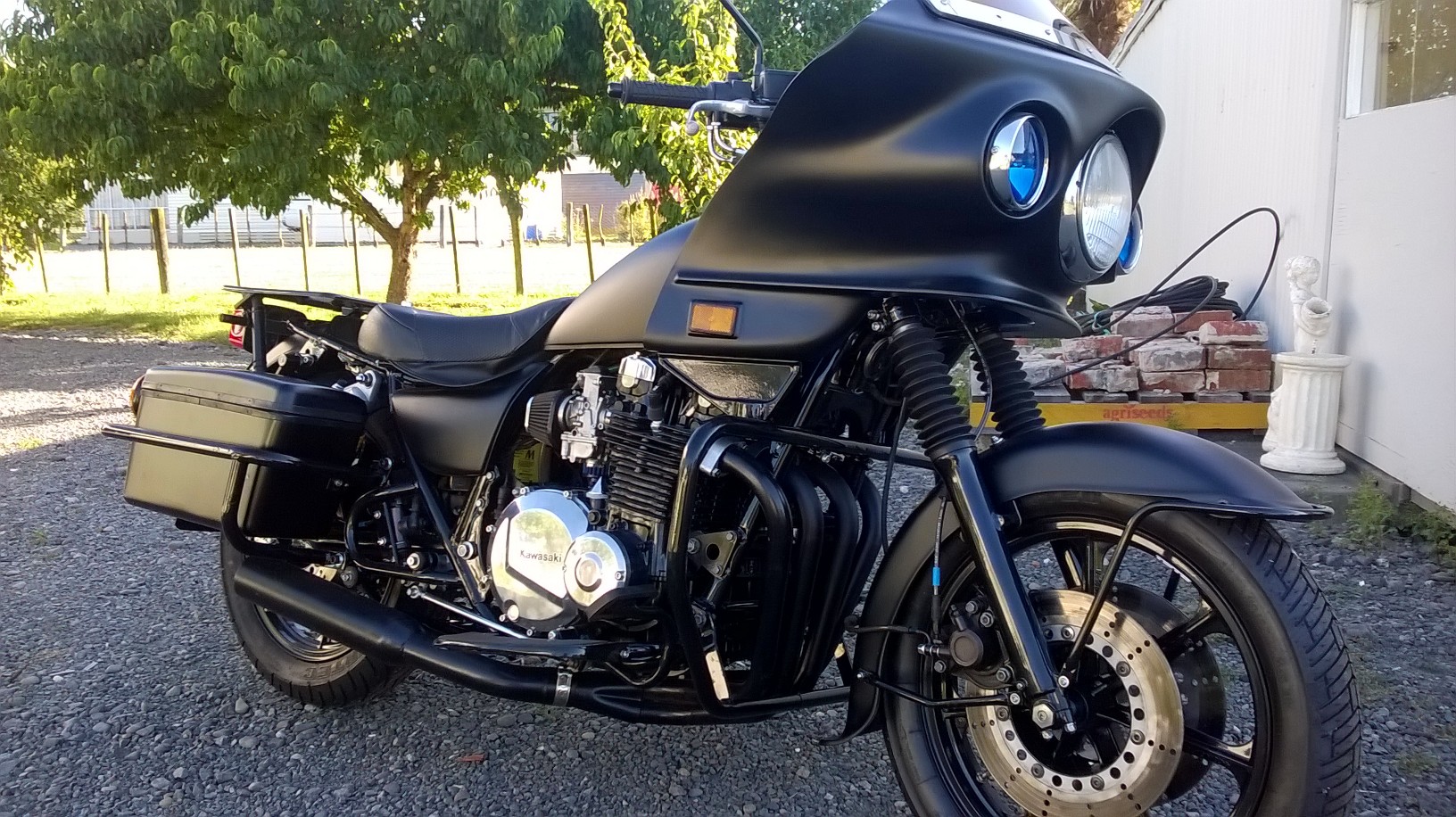

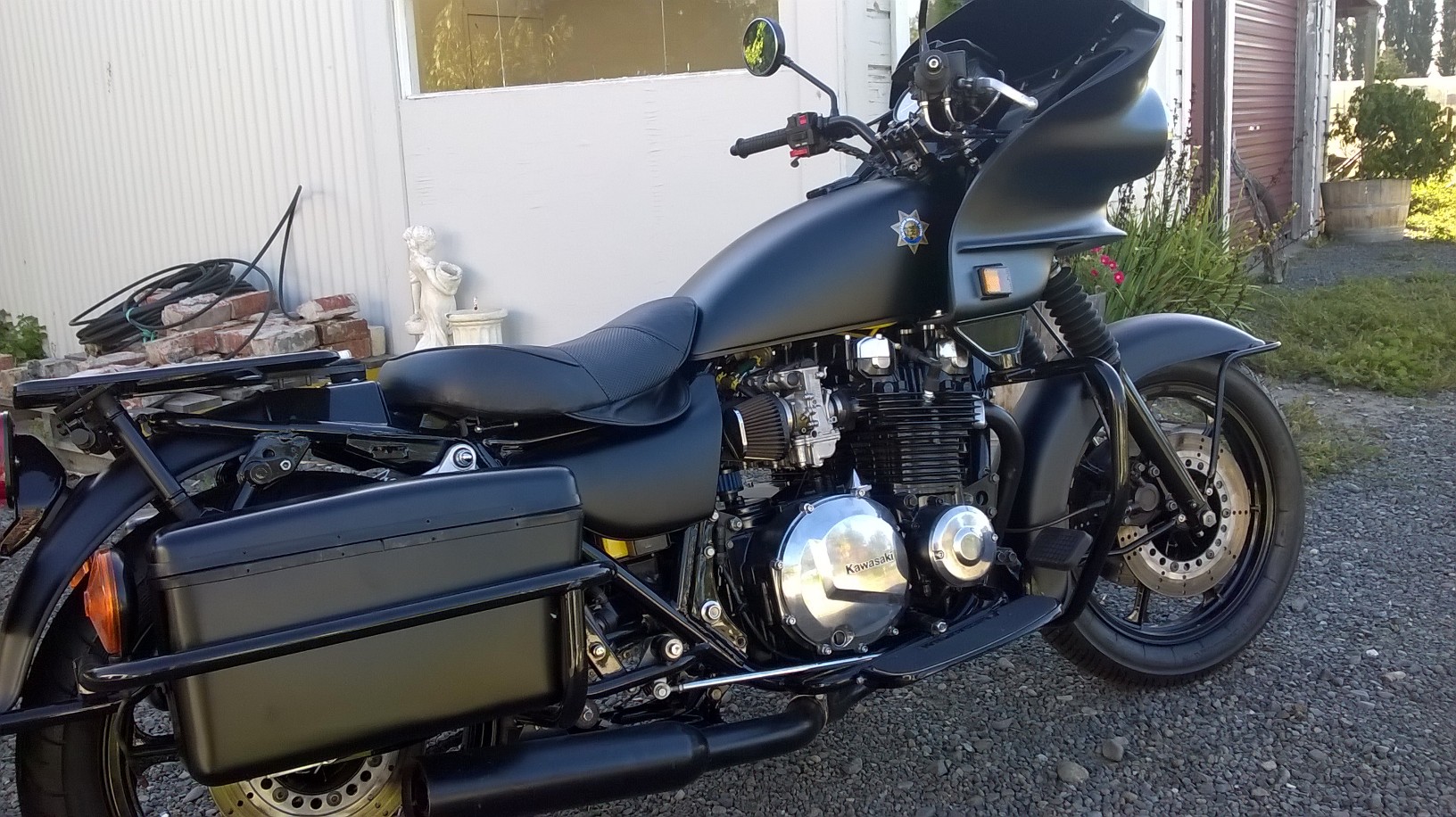

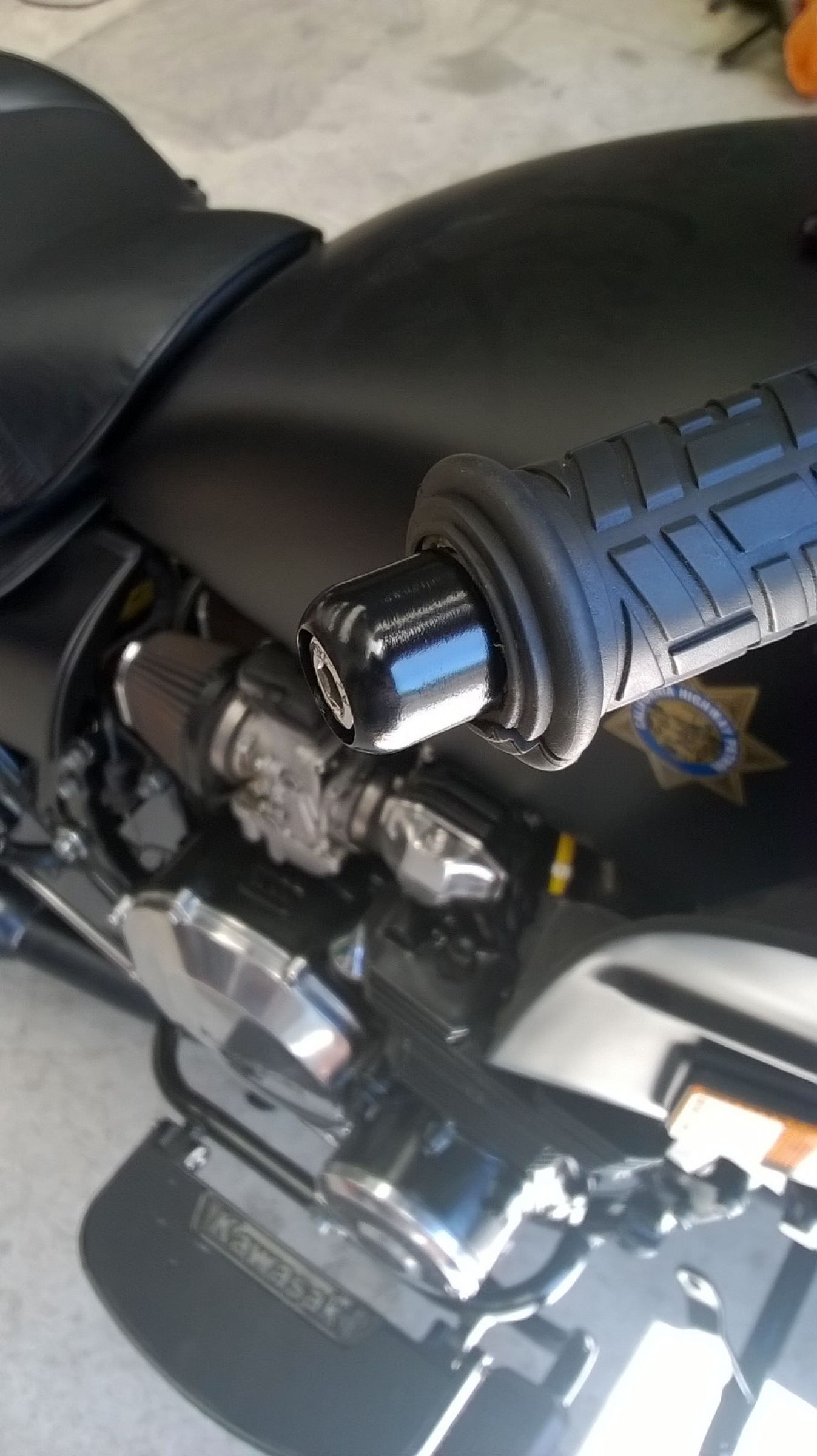

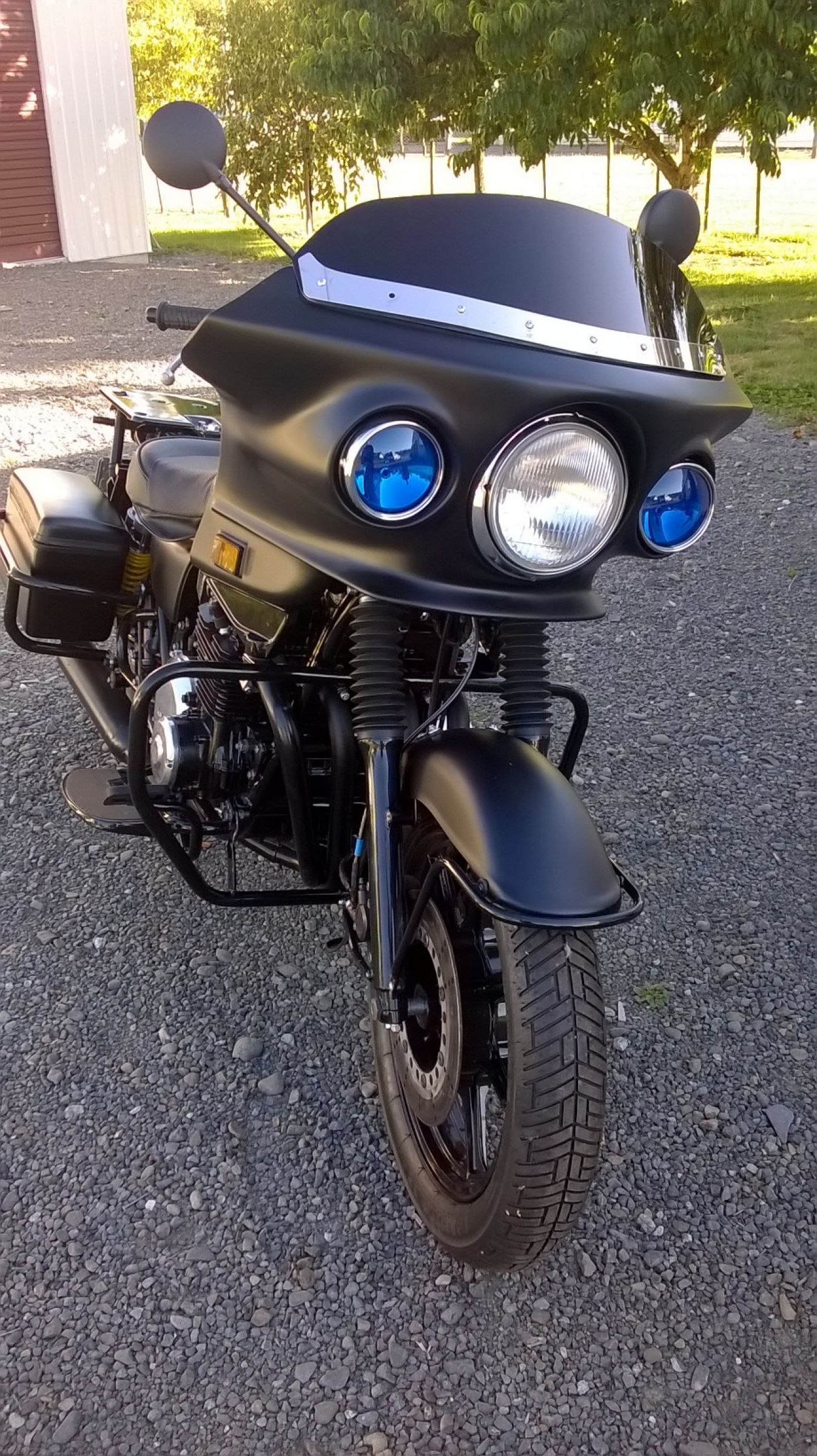

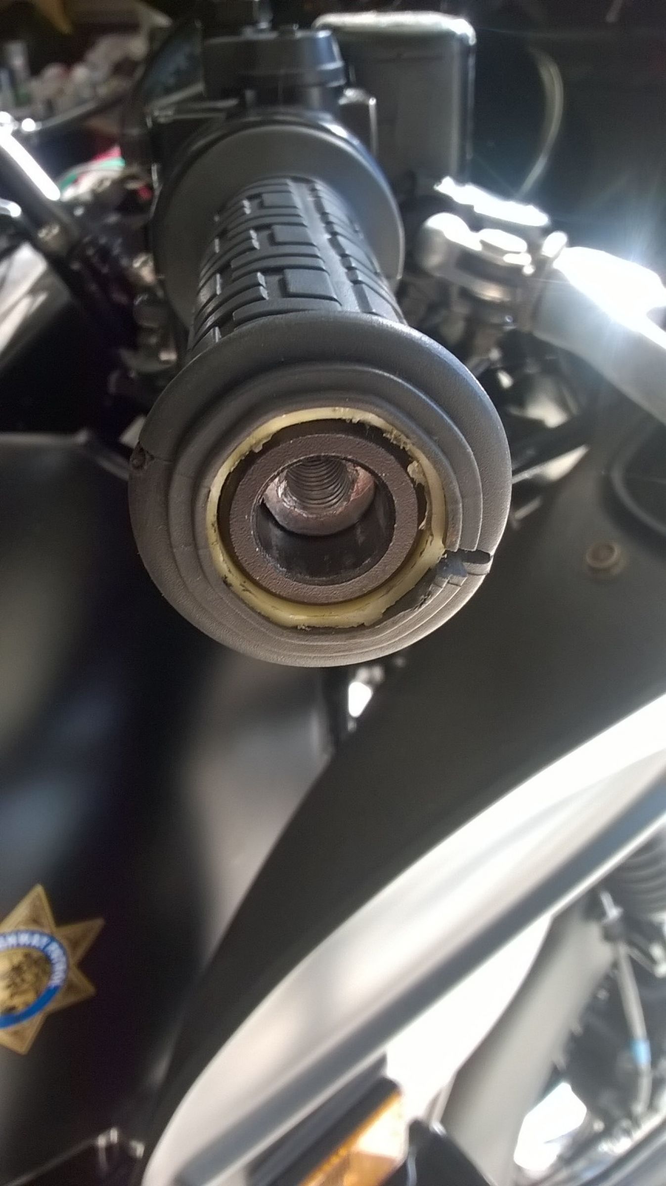

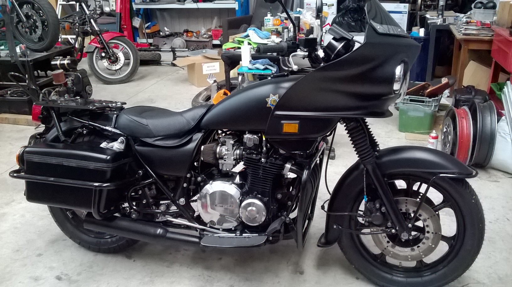

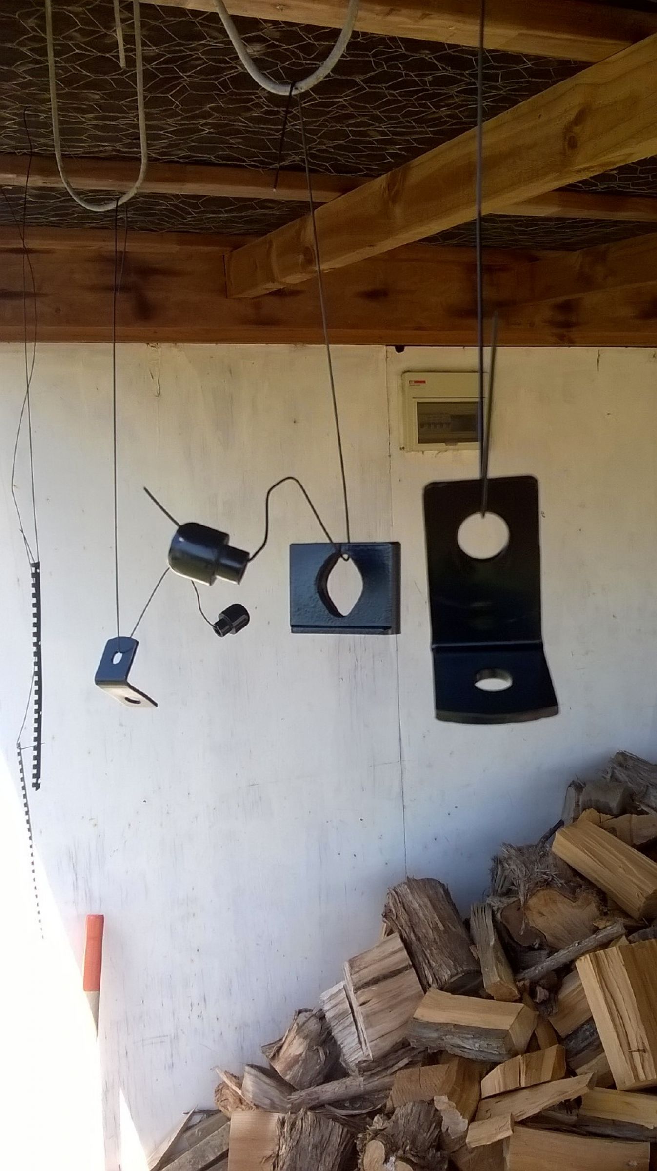

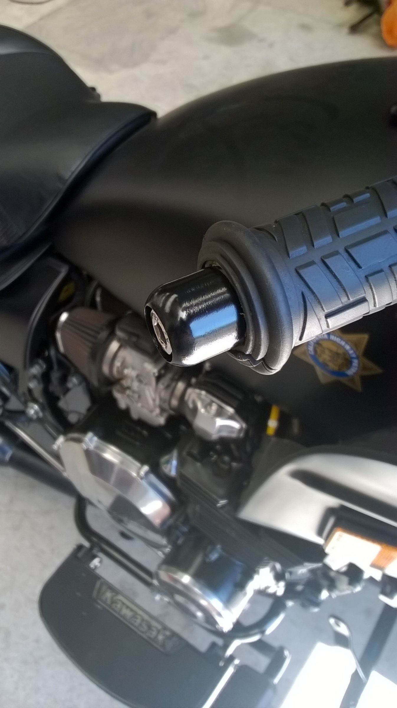

Trying to get all the little things done so I can finally call the KZP done. I have absolutely no spare cash at the moment so trying to reuse whats around the shed. Barends were from a crashed bike. Had to make a few mods to get them to fit but worked out sweet. Also had to make some brackets to fit the crash bar as the new pipes meant the crash bar hit the header and couldn't be bolted up. Also had to paint up the last brackets to fit the bags and indicators (turn signals). Hinges for the bags were bashed and battered so they needed a paint. Top fairing is now fitted and bolted up. Headlight in, mirrors on........... Still need to fit the front indicators, fit the screen properly, rivet the hinges and latches back on the bags. Not far, not far at all. Some pics of her outside. First time it's been out of the shed!
