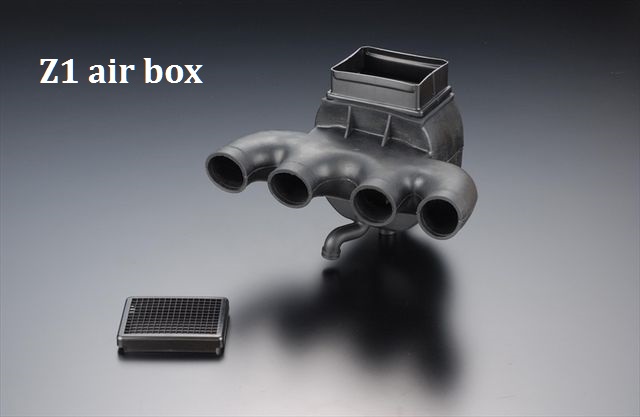

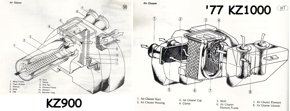

wiredgeorge says a Z1 air box substitutes very nicely in a KZ900 (may need a little support at bottom).
www.z1enterprises.com/ItemDetails.aspx?i...ox+Z1&item=PM81-2361

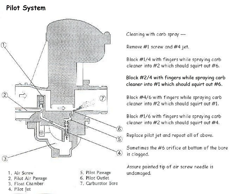

This way of cleaning the pilot circuit works well for me.
Would also take pains to assure that the overflow circuits are clean and clear.

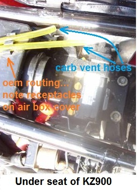

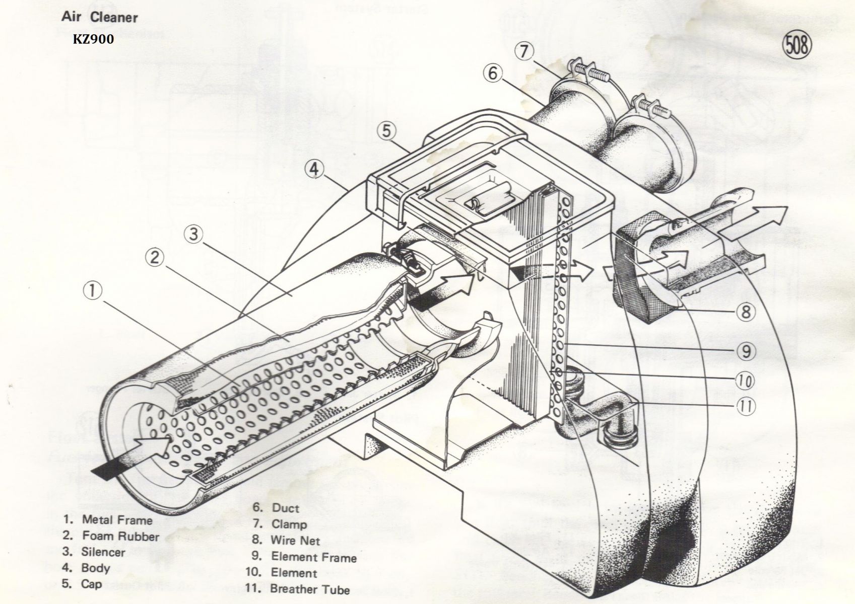

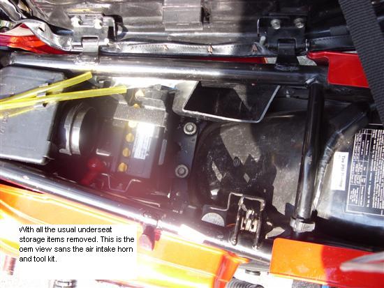

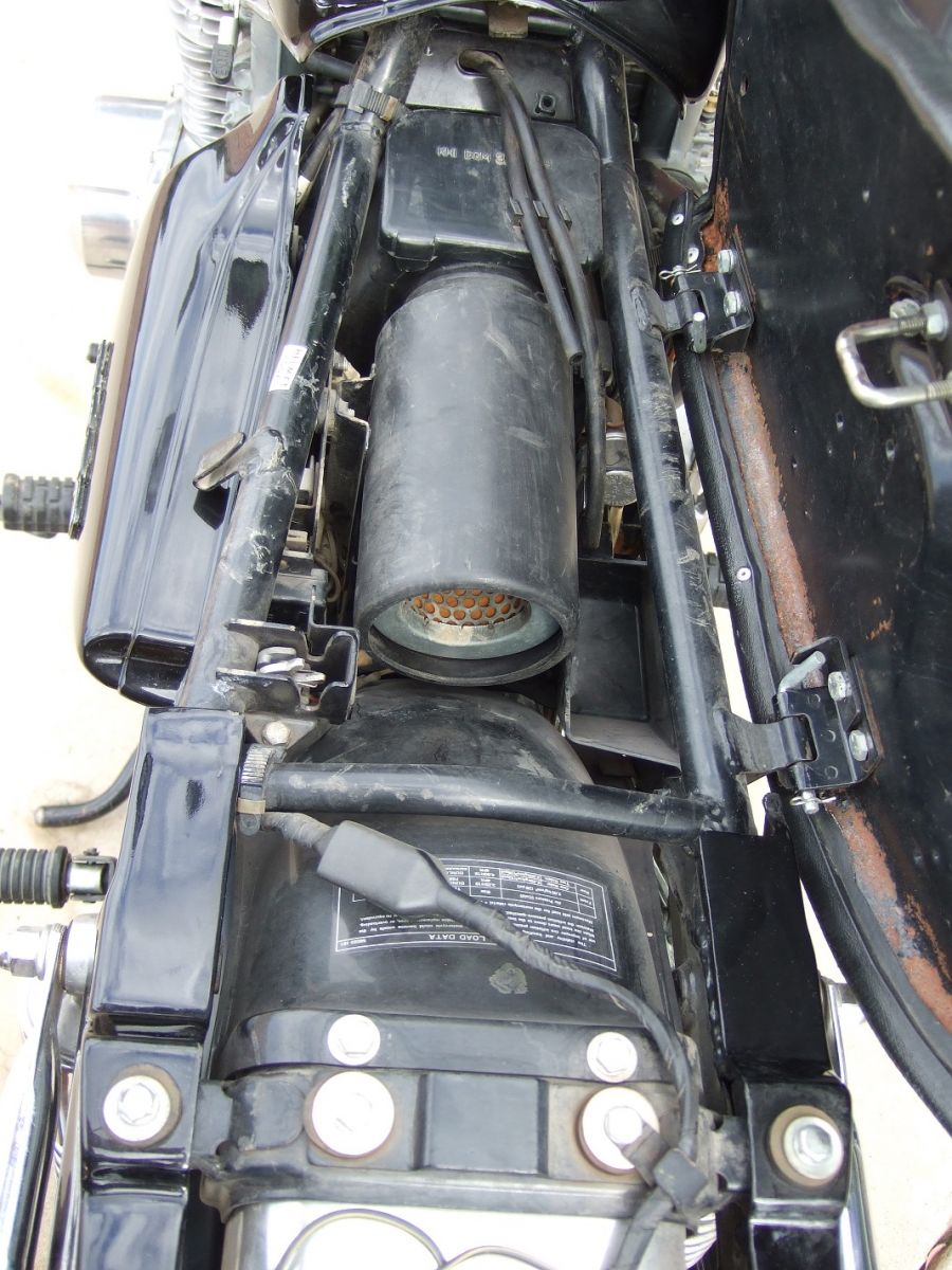

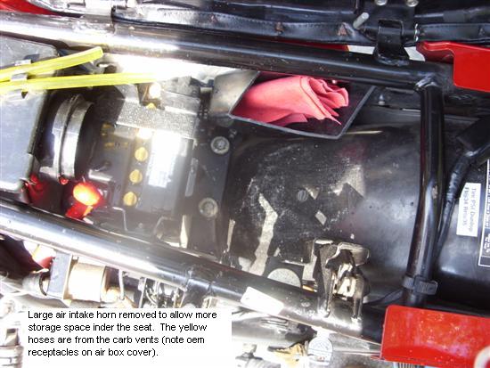

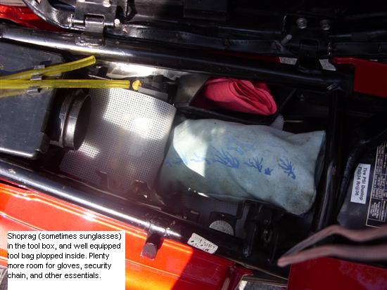

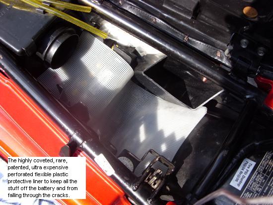

In order to gain more storage space under the seat, I run my KZ900 with the intake silencer tube removed from the air-box.
If the intake silencer tube came with the bike, hang on to it as they are getting hard to find, and usually priced accordingly.
From the link in my sig --

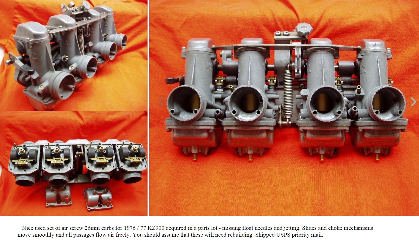

All there Patton....
Picked this set up[ off e-bay.... Will still go through, re-build, make purdy....
Yes I realize the pilot & float needles are missing in the images....
