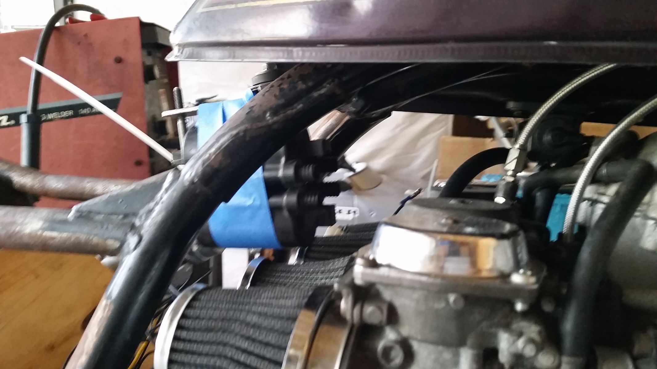

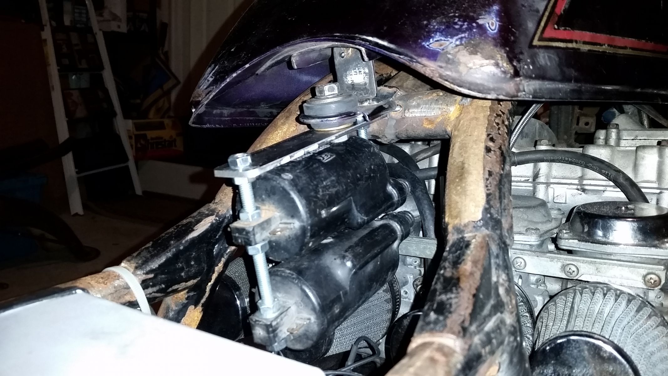

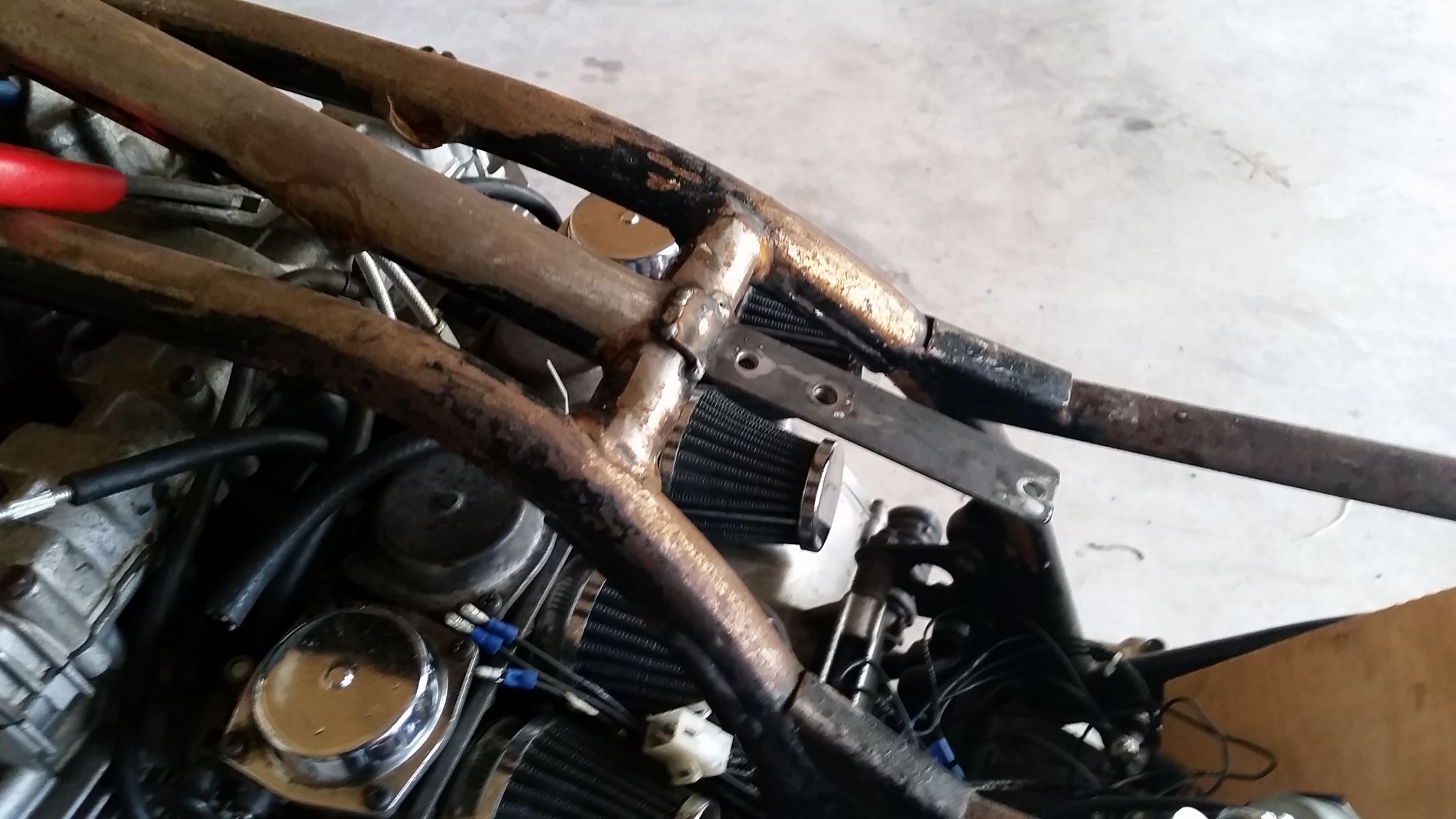

Well I got the tank bolt bracket welded up. I cut the bracket off of the tank and relocated it under the tank and about an inch or so lower to sort of hide it. I can always make the spacer shorter if I want the back of the tank to sit lower later. the bottom of the tank is currently almost parallel to the ground. It also has two holes for the coil packs to mount (pic shows them temporarily taped in location. Have to get some long bolts and tube to make the spacers and permanently mount them ... reason for mounting them on top of each other was so that the plug wire runs would be symmetrical and not have to cross each other.
Also will get some steel rod later and support the end of the bracket by linking it to the frame

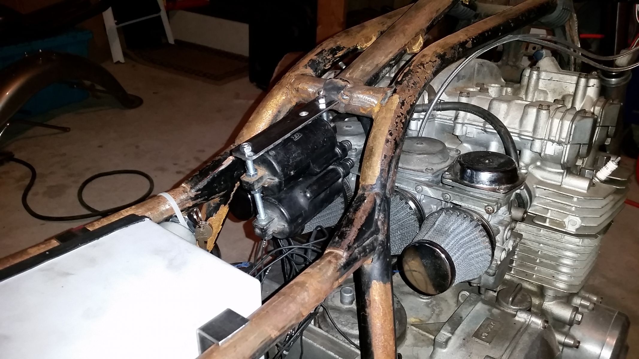

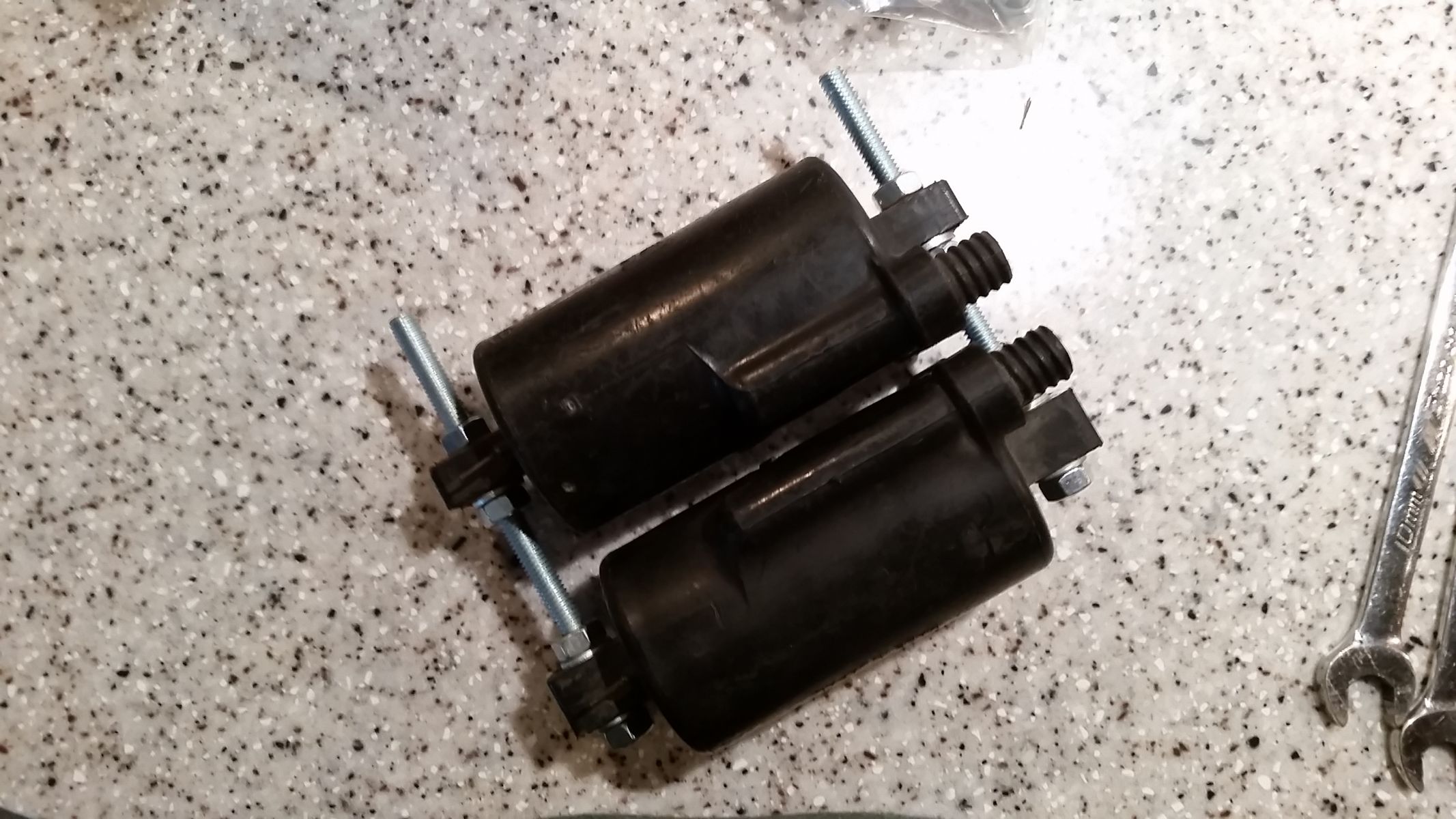

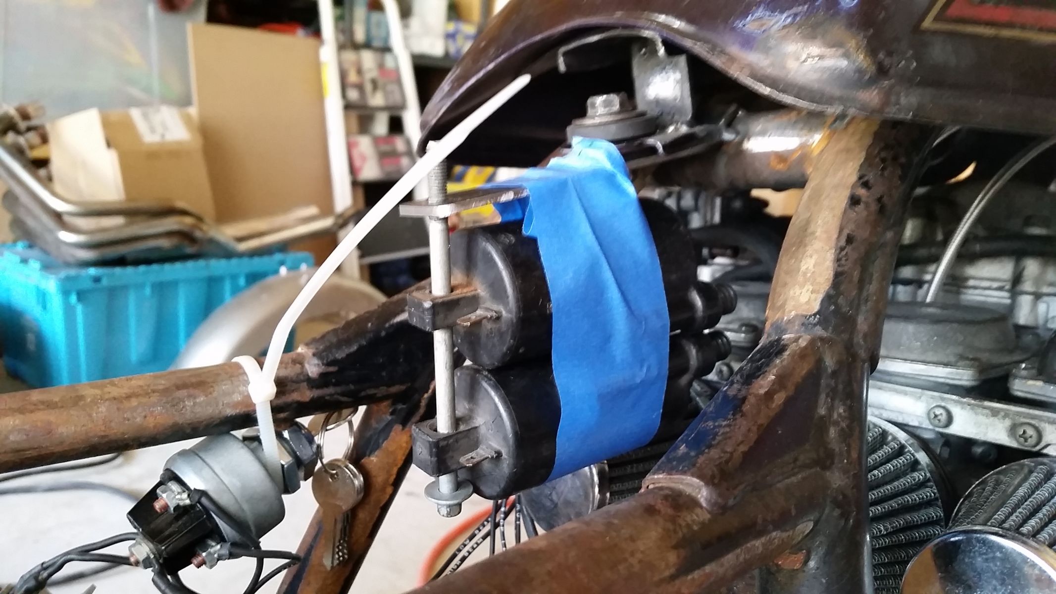

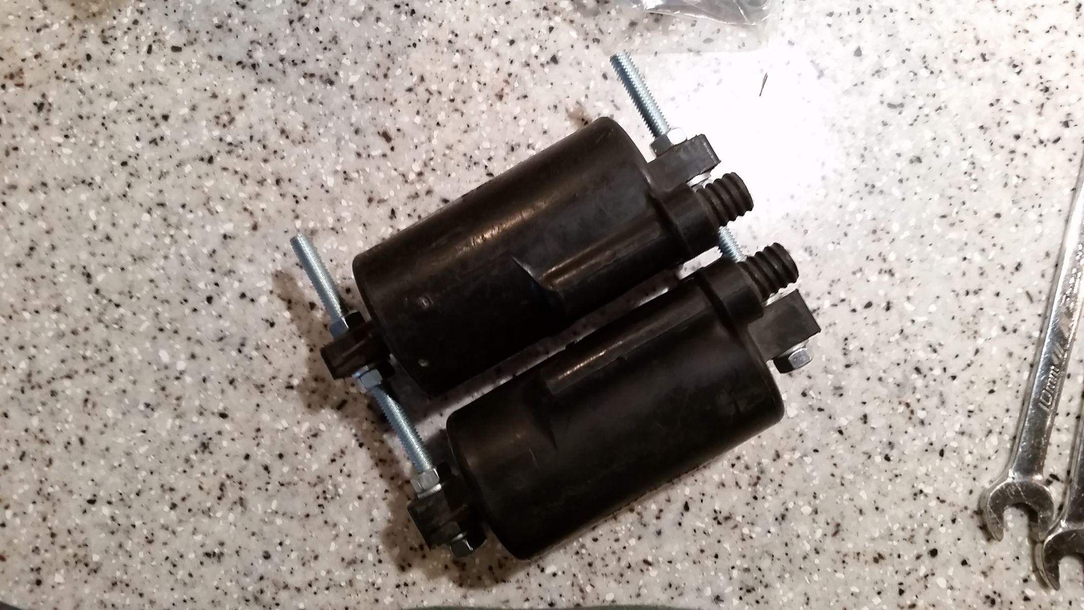

Few more pics with the coil packs mounted. Will eventually get spacers made instead of the multiple nuts to separate/locate the coils; it'll also clean up the look by hiding the all-thread rods.

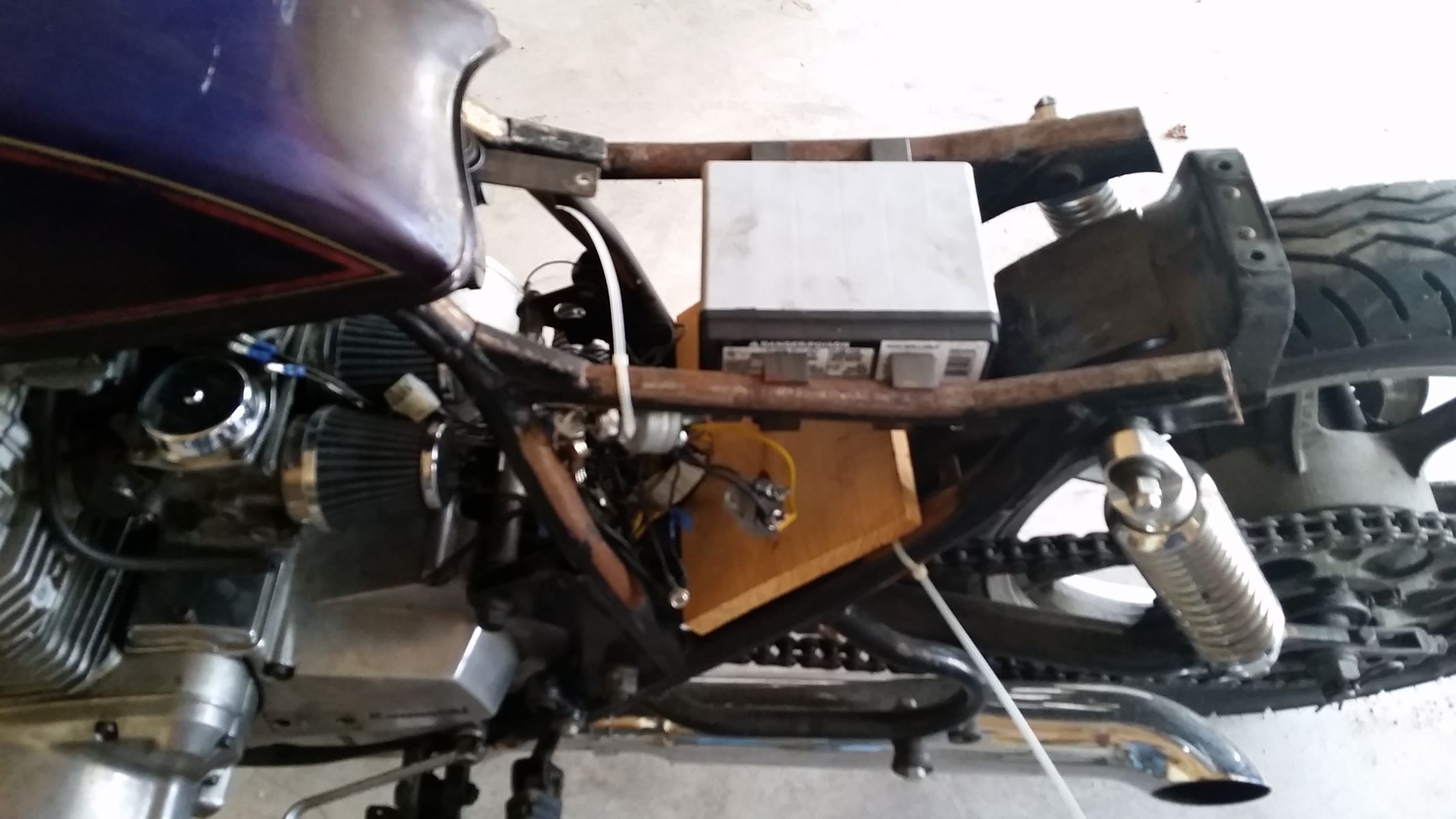

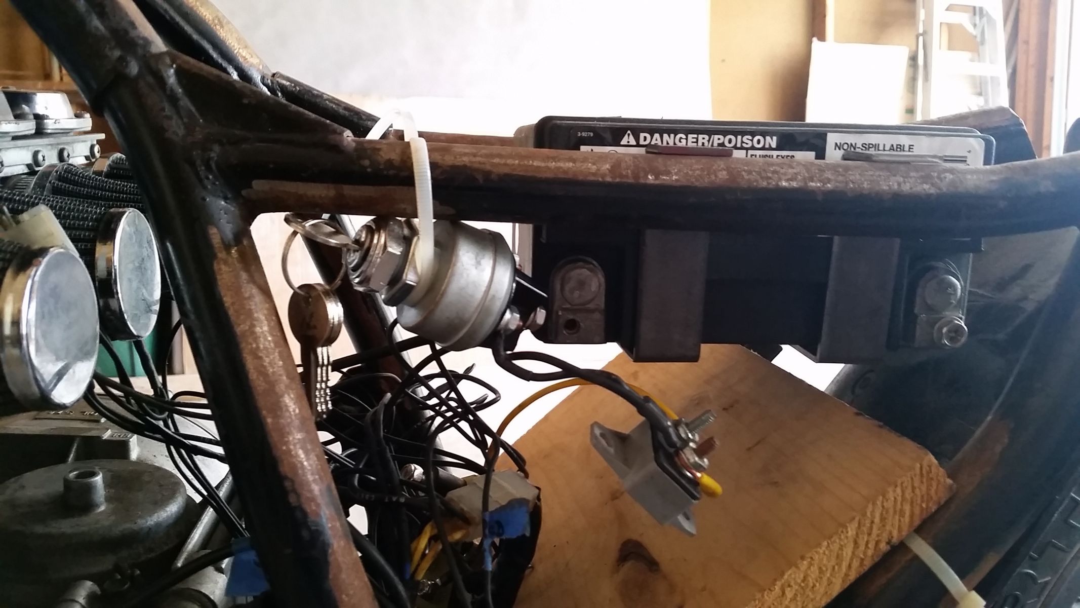

Also, the beginnings of a battery tray. The little tabs will be cut shorter and the tray lowered and welded to frame so battery would sit just below the frame rails. Also there will be a two part strap running around the tray length-wise to strap the battery down and also locate the two cross straps seen here.

Re: Re:1983 KZ1000P bobber build ... MUTT #3
17 Apr 2015 18:22
The coils should be bolted to a frame member or tab. Heat sync.
18 Apr 2015 07:07 - 18 Apr 2015 07:07
Hmm you'd think if it's using the Frame as a heat sync, there'd be more of it touching the frame than just two standoffs. They're currently in an area where it should get good airflow over them when on the move ... will def. keep a watch for excess heat buildup. There's plenty of space there for the stock brackets to be mounted side by side too.
18 Apr 2015 07:11
They should be bolted to something solid. The center core dissipates the heat, plus the coils work better this way.
