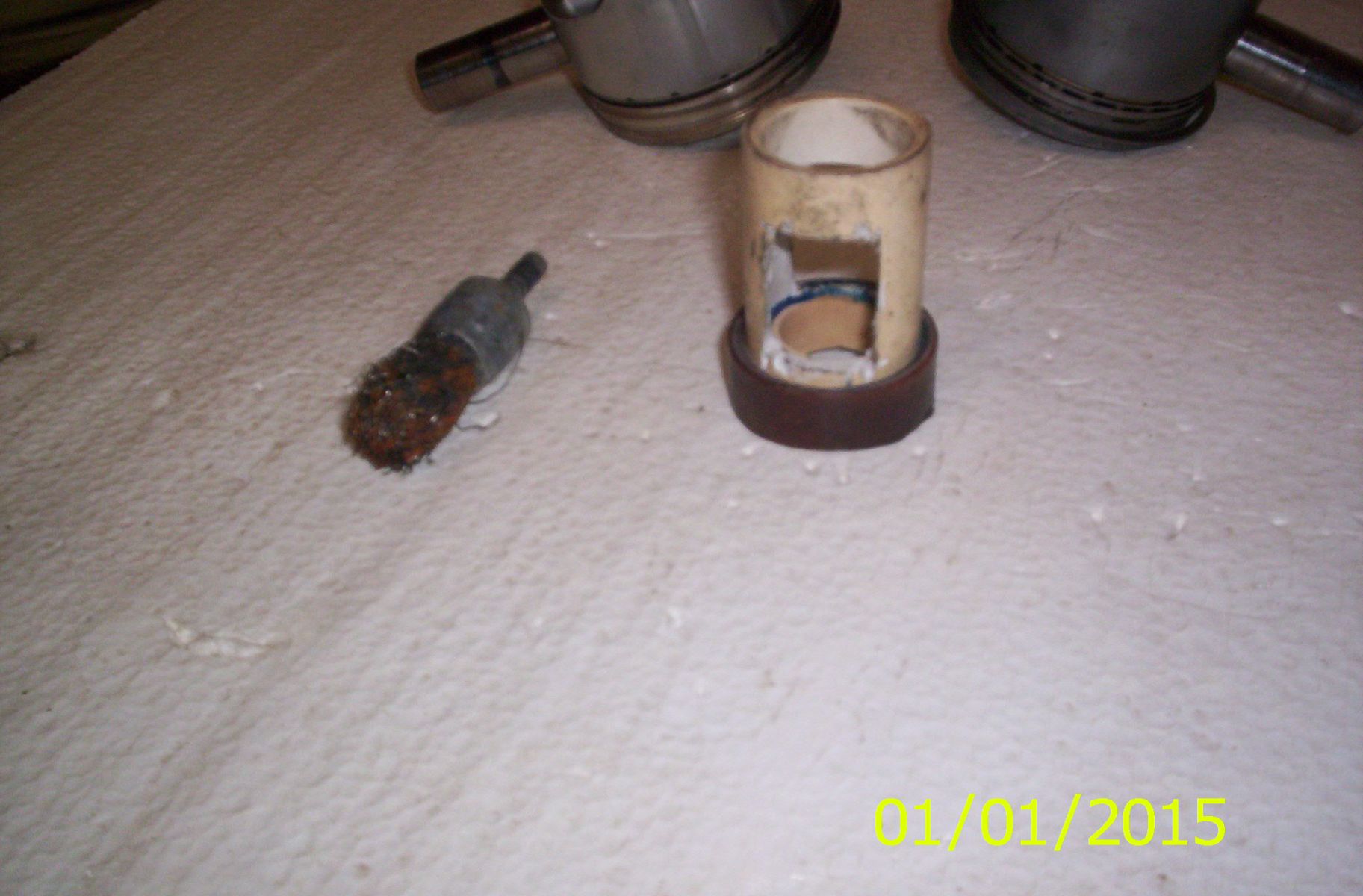

heres a video of a guy who made his own tool for removing valves

Thanks, Steve, worked like a charm. My fabrication skills are top notch lol.

I forgot to tell you to use a large socket the break free the keepers. Sometimes they can be so tight they will break the PVC tool.
Glad it worked for you.
