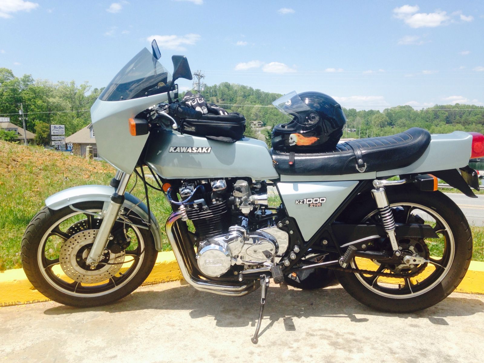

Very nice 78 z1r....
I have just gotten one for my self. Wish it had come with the larger tank tho. I had to refuel every 80 miles.

Your bike looks very nice. I think it needs the pin stripes doing for a finishing touch ??
I will be keeping the touring gas tank as a spare which will be sold with the bike.
You are right about it being more practical - but sometimes we have to suffer for our vanity ... and the low profile one looks AWESOME
From Mark
From Mark
