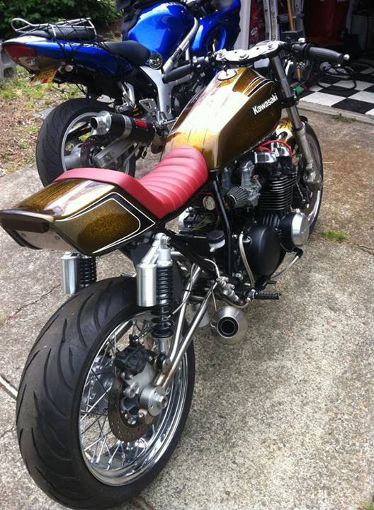

Welcome to KZR! looks like you have got the skills to finish that bike. Here is a little inspiration for you. the KZ550 tail matches the lines of the SR tank really well.

I do like that bike, I have seen it all over the place. I'm not really sure what I want to do with the tail section just yet. I'm having a really hard time deciding but I think I am probably going to end up building a subframe, making a seat pan out of some sheet metal that I have laying around and doing a brat style seat.
