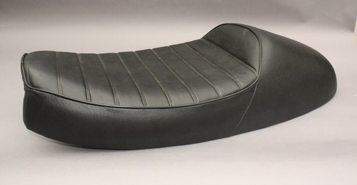

you gotta get the foam looking exactly like you want the finished seat to look .
the upholsterer can only do so much,and who knows if he has the same vision as you do for the finished product.
so the closer you can get the shape to the finished result that you invision the happier you will be.
my critique would be,
that i don't like the ninety degree bumstop and i don't like the flat top rear.strictly personal opinion and that you like the finished result is truly all that matters.

upon further review i see you have it leaned back.i had thought it was more straight up and down.
i think one more layer on what you have in the seat area and then let it run up on the tank some and sculpt the seat area more.maybe one more layer on the rear hump may have to wrap the edges to get enough material to blend the side into a smooth curved transition across the top.
like this
like this

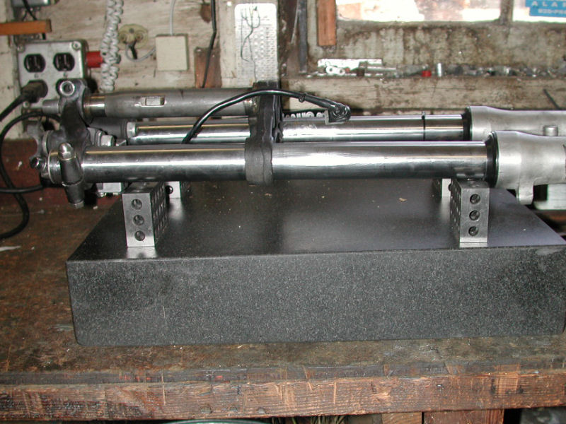

setting the triples on something flat should reveal if they are bent or not.
did you slide the one leg in and clamp it up?then try to slide the other leg in?
if so this can cause a misalignment.

That's a great idea Leon, I will bring it up to work tomorrow and put it on the quality controls granit slab table.

- Posts: 7442
Re: New member and new project
24 Oct 2014 08:53

I completely agree Leon! It looks like those 1,2,3 blocks come in handy for ya also lol
