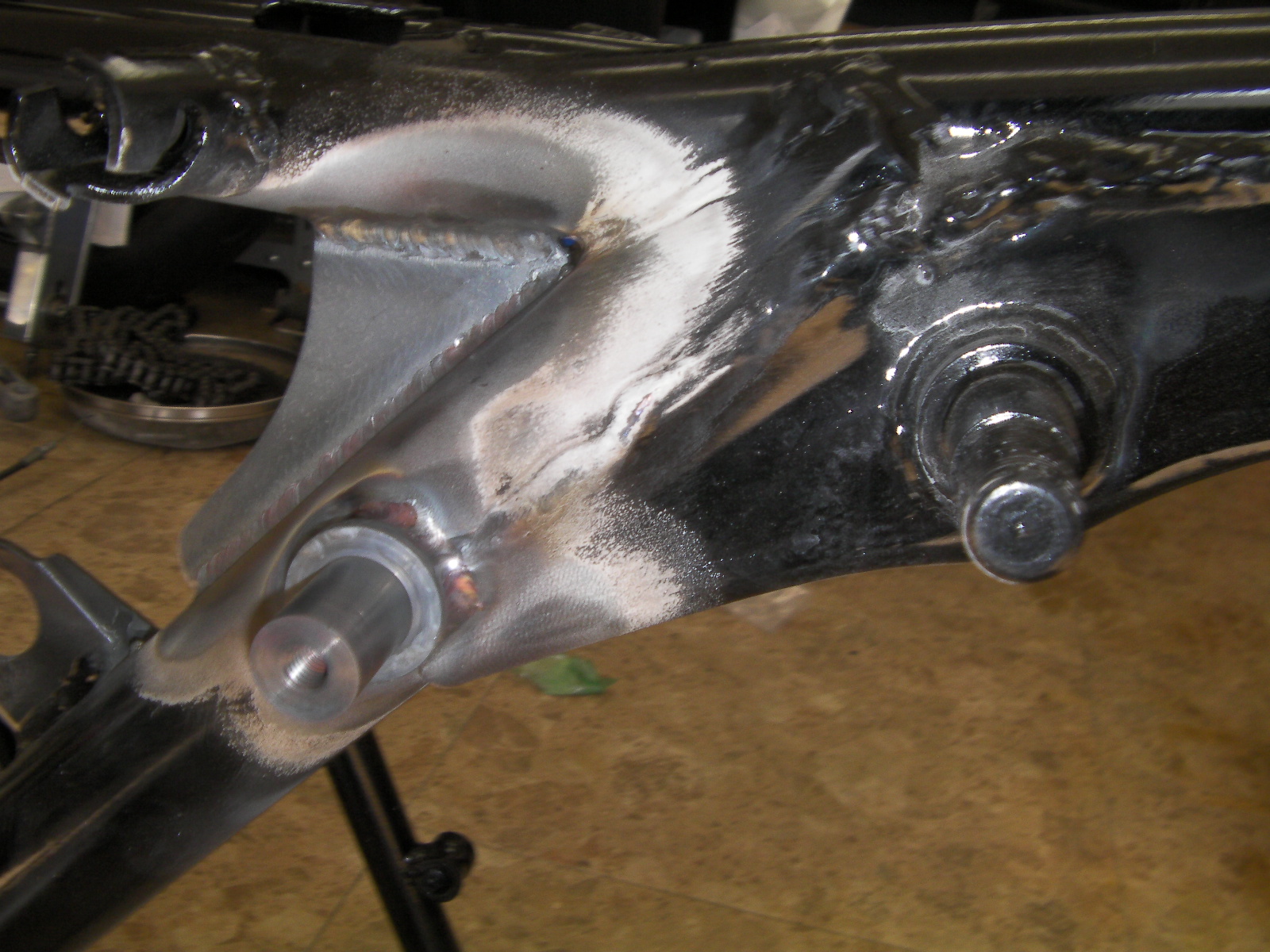

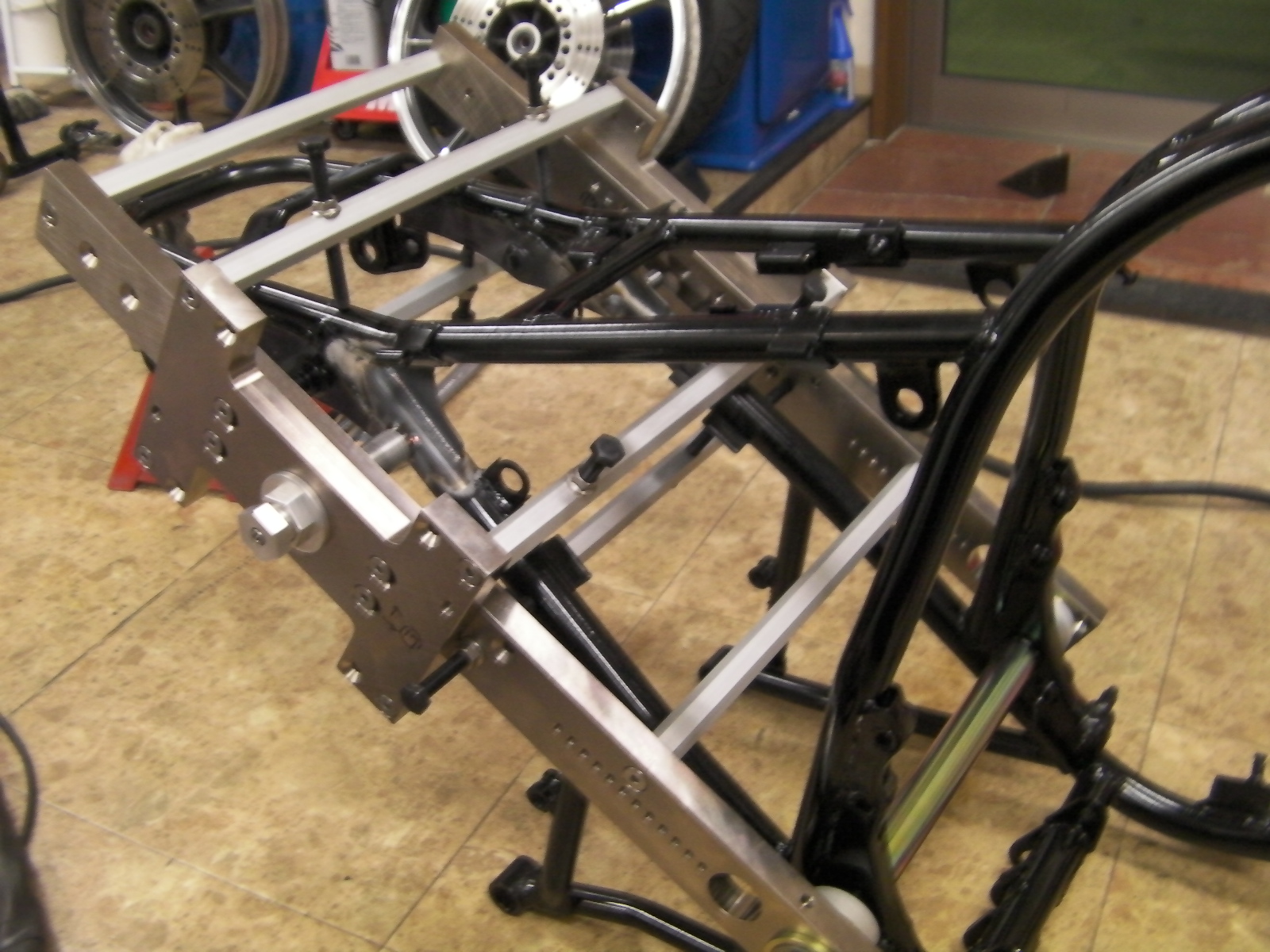

- Posts: 7442
Re: 1981 J model Endurance racer
13 Jul 2015 06:01
here's a shot of relocated upper mounts by sanctuary.
here is the jig they use to make sure they are correctly located.
how good are the choices of tires for that 16"wheel?
hth,
hth,
- timmythecop
- Posts: 64
- Thanks: 2
13 Jul 2015 09:17
Thanks for those pics. I thought that i should go through the frame again like thr factoru did. My other idea was to make a horseshoe shaped bracket arpund frame tube with the ears facing rearward.
